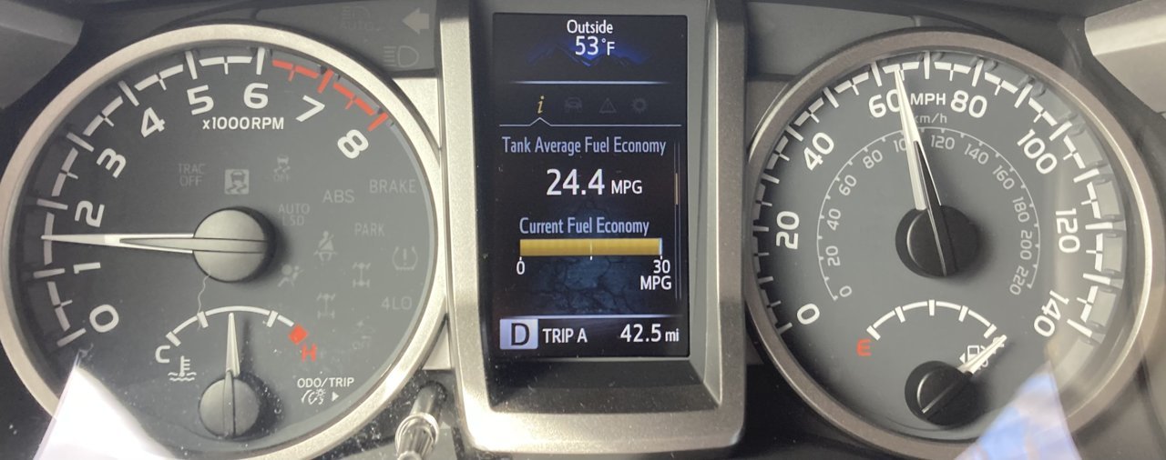

    I am still waiting to see if mileage is a problem. It is used (timeline, days around the purchase) and the previous owner was an idiot I think. First tank was 17 MPG average. On my 4th or 5th tank I can get 23 on freeway and 20-ish on surface-streets. I think the computer is figuring out that I can manage the skinny pedal better.
    Will figure out in a few miles if I can ready 24-ishh on my own without a tune.
