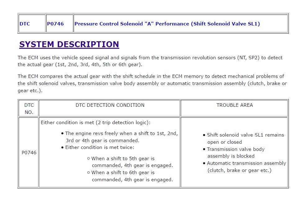

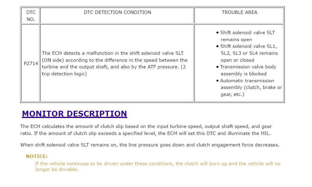

    You should be able to do better diagnostic than you've done if that's the case.
    http://www.ttguide.net/ac60e_automatic_transmission_transaxle-927.html
