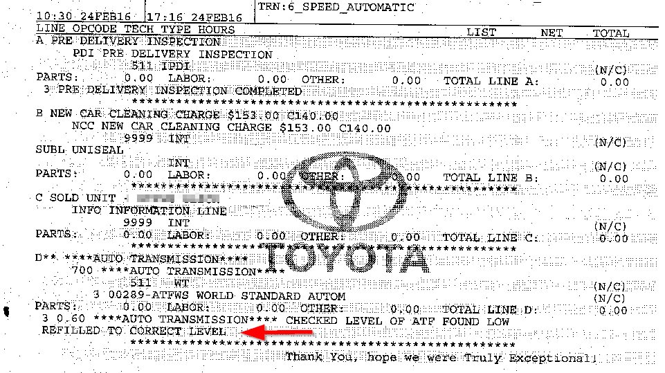

    My new Tacoma arrived a day early, so I spent several hours at the dealership, late Wednesday. The salesguy informed me that he told the maintenance crew to check the ATF. The maintenance guys did, and (supposedly) were surprised to find it was nearly 1 1/2 quarts low! Supposedly, nobody there heard of the problem, until I told several people of it, several times. They documented it, and will send me copies of the documentation (and maybe some pictures) later. (My odometer showed 20 miles or so, and the truck was received with 2 miles, so they did some driving, as well).
    The Pre Delivery Service (PDS) form was checkmarked in all the appropriate places ... but, guess what? The sales guy said something like "there is no transmission dipstick, so they may have just checked it off on earlier deliveries". Sound familiar?
    Salesguy also told me that the dealership is informing Toyota (San Antonio) of the low ATF problem, and the dealership will follow up when the trainer / engineer shows up later this year. They also promised to check ALL incoming Tacomas, since the problem was verified after checking my truck!
    My initial testing showed NO jump into gear, when shifting from Reverse to Drive, while still slowly rolling backwards.
    No steering wheel vibration, no steering arm wind howl at speed, but some wind howl from the driver side pillar (maybe). Anyway, that is the topic of a different thread.
    So, maybe Toyota will do something about the low ATF ... you might want to get it checked before the 5000 mile visit. (The salesguy told me to come in around 2500 miles, and they would check the U-joints and other possible problem areas that I mentioned were described in Toyota World.

    As promised, here is an image of part of the dealer's invoice, provided to me when I accepted delivery of my new Tacoma.
    I am still awaiting some more data from the dealer ... I was supposed to get pictures (or something) from the techs that did the work. However .... who knows?
    Given the number of TW members who have provided written documentation that their ATF was low, it might behoove more members to go back for further checks, particularly if they are having what seems to be transmission related problems. Don't forget to post your findings here!
    When I quoted some of the other problem areas mentioned in TW, my salesguy told me to come in after 2,500 miles (rather than 5,000), and get my first "free" inspection (no oil change) then. I have started a list of problems I noticed (only one item on it so far).

    Gathering information from the post above yours , I see Toyota hasnt rectified the problem from the factory.
    Old Timer,s truck was recently built and the dealer had to add fluid .
    Judging by your explanation , you are not having any of the issues or symptoms of a low fluid condition so you should be good to 5000k .
    The symptoms are listed on the first page of the poll thread .
    https://www.tacomaworld.com/threads...be-low-on-fluid-directly-from-factory.405642/
    Was the transmission warm when your dealer had the computer connected and test drove your truck ?
    Did they actually check the fluid using the proper check fluid level procedure ?
