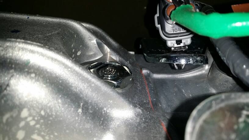

    Supposed to be a bit nicer today, anyone have pics of fill hole and drain hole?
    Does we have to jump the circuit or can we just warm it up, open the drain hole
    and if a bit runs out we're good?
  12. Feb 27, 2016 at 4:05 AM
    #232
    keithert
    keithert Well-Known Member
    Feb 2, 2016
    #176865
    145
    First pic is fill hole on passenger side. Second is check hole on driver side of pan.

  13. Feb 27, 2016 at 4:11 AM
    #233
    BlkTaco47
    BlkTaco47 Unhinged
    Apr 9, 2011
    #54635
    5,113
    2018 TRD PRO Midnight Black Metallic
    thx!!
    so from what I'm seeing, opening the check hole on the drivers side of pan, if
    ATF dribbles out all is should be good. Engine has to be warm for a proper check before
    opening the check hole? 5 minutes of idle run enough?
    I thought I read this was a bigger process to check and that fuses had to be "jumped"
    for a proper level reading?
