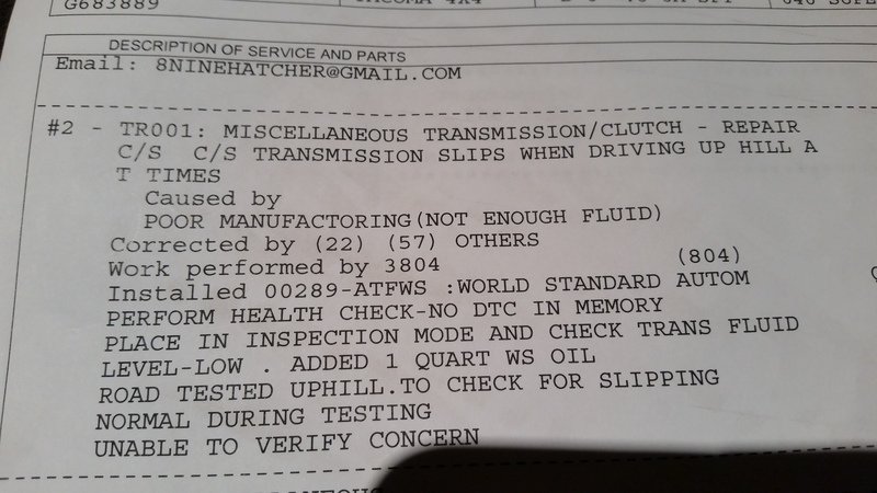

    Just got my truck back from the dealer and it was covered under warranty. I only had 1125 miles when I felt my Trans slip. And this is what the invoice said 20160227_215803_zpsm063mggo_16d81219fa7cb03c974e0855d2ae61ddd0a46883.jpg
    gearcruncher likes this.
