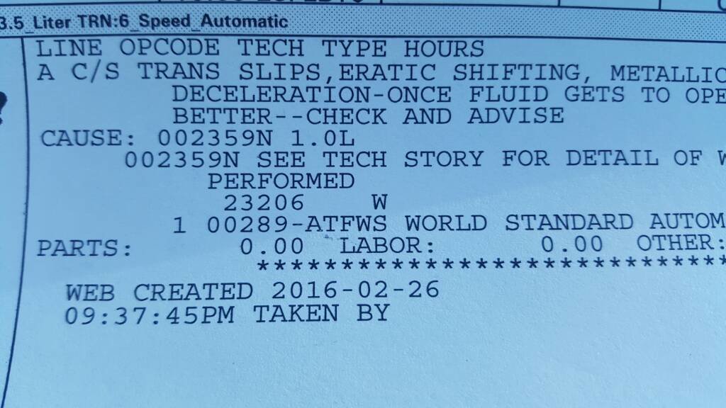

    Had it checked. They said they added approx 1 quart

    Mainly had the model, I did notice a delay sometimes mostly on cold cold mornings and just thought it was the nature of this new Taco (my 5th gen 4R did too it seemed). Didn't bother me, but after seeing all the reports of low fluid bothered me and wanted it to have what is spec. For what it's worth, it does seem smoother...

    Trd OR they said it was a quart low. I was experiencing issues mostly when cold and weirdness between 5th and 6th. It already feels better but it could be placebo effect I guess lol.

    I had my fluid checked and the dealer found it to be 1/2 - 3/4 qt low. I am still having the delay from R to D. I don't know if I trust the dealer if they actually checked and filled the transmission. I think I am going to check it my self this weekend. I have read Gear's pdf and other than some WS fluid and the pump is there anything special I need or tips I should know?
