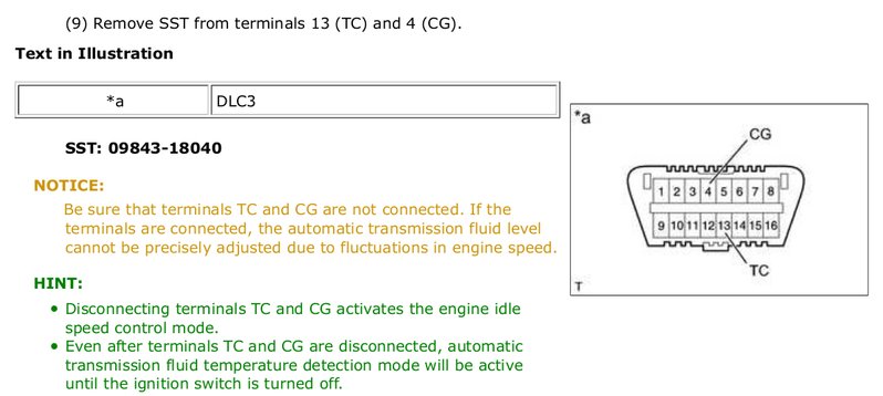

    The jumper should be pulled after entering check mode. The reason for this is the engine is in a "fast idle" mode when the jumper is in place. Removing the jumper lets the engine return to normal idle. The transmission fluid level should be checked at normal idle.

    Not true, once the computer is put in the "trans temp monitoring mode" it stays there until the vehicle is restarted. As soon as it's in that mode and you see the "D" illuminate for 2 seconds then turn off you remove the jumper wire.

    True - read page 6 of the Toyota procedures. If you don't remove the jumper after it's in temp check mode then idle fluctuations can impact the level. I've posted a copy before, but here it is again.

    That's exactly what I said.

    And what I said. So I guess we are saying the same thing in two different languages ;-).
