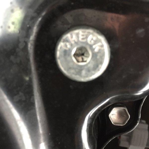

    Is everyone that checked their own trans fluid replacing the gasket, and oring on the fill plug, and check plug? If so what are the part numbers for those? Going to check my own fluid this next weekend. Not really having any trans problems but need the piece of mind that its full.

    Ok thanks ill call the local dealer tomorrow to verify they have them in stock and if not trdparts has them but they want $7 to ship two gaskets

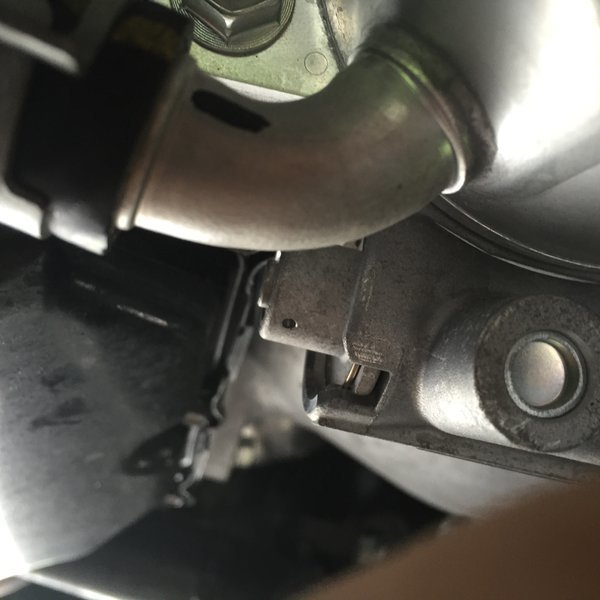

    I assume this is the thermostat that needs to be pinned? And does the interior of the check plug appear to be cracked? Also do i need to pin the thermostat prior to entering the trans temp mode or after it has entered that mode? Does it heat up soo quickly that you only have a few minutes to do the check before having to let it cool down? Sorry to ask sooo many questions.

    I pinned mine and loosened the fill and check plugs where I could get them out without a wrench. Worked great especially with the exhaust there. Some guys add a 1/2-1 quart and then just pull the check plug until it drips/dribbles. It really only takes a few minutes to check if you get prepared. Not sure how fast it goes out of range, but I watch for the D and jump out as soon as it comes on, spent 2-4 minutes under there and still had time. Put a fan on the pan to cool it much quicker if you have to do it more than once.

    One last question lol what is everyone using for the jumper wire ?

    Well i grew a pair and cut a wire and got my truck into trans check mode just to make sure i understood how to do it. For those of you that put a quart or more in and then checked it did you add the quart prior to warming up the truck? This sounds like a great idea being able to avoid dodging the hot exhaust but also seems like it could build pressure in the system being overfilled prior to pulling the check plug? I like to do all my own maintenance, but also dont like to mess things up. Appreciate all the help.

    I'd suggest you pin it... isn't that the whole idea.....to get the fluid circulating throughout the system...??? If you don't pin, you may still be low, if there is any air in there..?? Just saying. When I do mine, I'll pin it for sure.

    I believe Gearcruncher said something like the stat will NOT open under normal operating temps.....He says it opens only when the tranny is near 200deg.?? Not sure on the temp.
