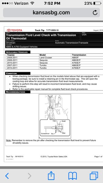

    I know this isnt our trucks or our trans but it is refering to toyota transmissions.

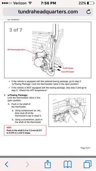

    Why are people so hell bent on deviating from the FACTORY service manual? It's very simple and clear cut. If it needed to be pinned it would say so. Has all logic been lost these days?

    Its not trying to deviate from the service manual its wanting to do it right. If the cooling system wasnt filled from the factory, and your transmission ever does get hot enough for the thermostat to open then you will be low in your transmission the amount the cooling system holds. Can you blame people for not completely trusting the service manual put out by the company that has sent most of their trucks out low on fluid.

    The tow package holds 2 tenth of a quart. I am by no means an expert but maybe they don't have you pin it because if the temp reaches high enough to run through the cooler it must also expand the fluid and that 2 tenths is a safety to keep from blowing a seal under pressure if it gets hot. Or I am being an idiot and you folks are going to jump all over me and point out how stupid I am for suggesting it. In the owners manual It does have an * symbol that says "the fluid capacity is a quantity of reference". Whatever the hell that means??!! I think I will follow the service manual and not pin. If my transmission blows I can always truthfully say I followed their directions. And maybe one of you engineers knows. Will 2 tenths of a quart really make a difference. I am more concerned with it being 3/4 to 2 quarts low. Be kind. I am but a humble civil servant.

    What is the capacity of the tow package cooler for the vehicles listed for this service?

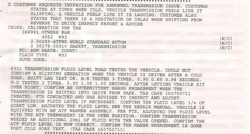

    I know what the service manual states from the .pdf files posted on the boards, but when the dealership checked my transmission fluid, they also checked it with the thermostat open. Here's a pic of my work order.

    I did mine unpinned, filled it 3/4 qt to full/tickle then tried it again pinned and there was no difference it was full.

    This was my experience as well. It acted a lot different after I did it pinned though.
