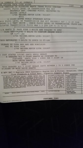

    I took my truck to the dealer around 300 miles and they told me that I needed to bring in after 500 miles to give a chance to break it in. I took it back when I had 600 mile and had the service writer and the service manger ride with me to go over the weird changing gear pattern. At this point they decided to get the trans fluid check. and sure enough it was short 1qt. They figure since its a new truck they cant be nothing wrong with it not specially any fluids. Well now my truck is riding alot better.

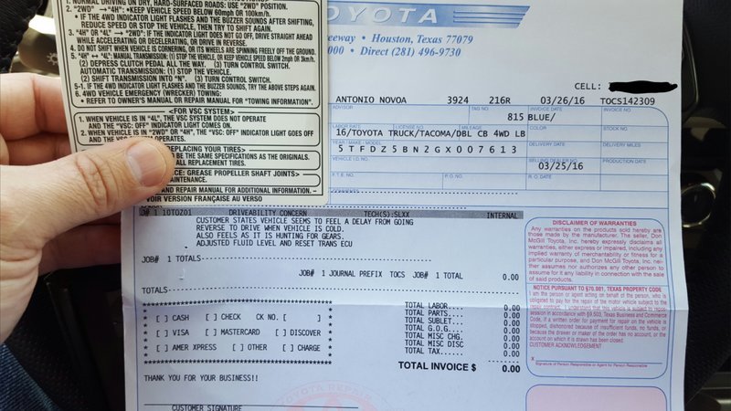

    Just took my DCLB 4x4 TRDOR w/ tow in on Friday for the dreaded R to D hesitation. The service writer couldn't tell me how much they had to add, but the report did indicate that they had to "adjust the transmission fluid level" and they also reset the transmission ECU. I definitely notice a difference in the shift patterns (much better now) and the R to D hesitation is gone.

    That's great the truck seems to be operating better now. Would you me able to upload your service ticket for for us getting flack from our dealerships to check the fluid level?
    Thanks

    No problem. I will get it out of the glove box and shoot a picture of it in a little while. I used Don McGill Toyota in Houston, and the first service advisor I spoke to on the phone seemed well aware of the issue and said he had another truck in with the same problem last week. The guys I dealt with when I dropped it off didn't seem as up to speed, but when he described what they did when he called me on Saturday, it was clear they had checked it properly and added fluid.
