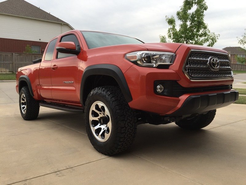

    Took mine in today. Not really experiencing the problems described here (except 5th/6th), but told them delay in R to D. They checked ATF, diffs and transfer, and tightened some bolts. All found to be in spec:

    Nice truck... wheels are great..!!

    Nice wheels... What are they and what size?
