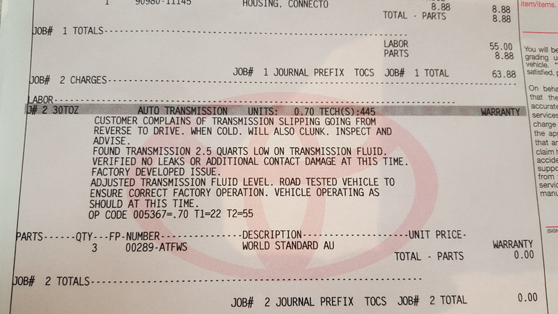

    Just got my truck back. They said they did the software update and my transmission was 2.5 quarts low. Here is a shot from the service ticket. They claim the software update is listed under the OP Codes.
    Jthizz2006 likes this.

    OK, so we need someone to confirm the OP codes mean something. Also, wow. 2.5 quarts low is a lot.

    The op code if for fluid adjustment. There is no update for the V6 at this time. I can double check when I get on a computer though.
    Justin85[QUOTED] likes this.

    Geez, is the dealer really lying to Justin85 about updated his tranny sofware? That would be sad.
