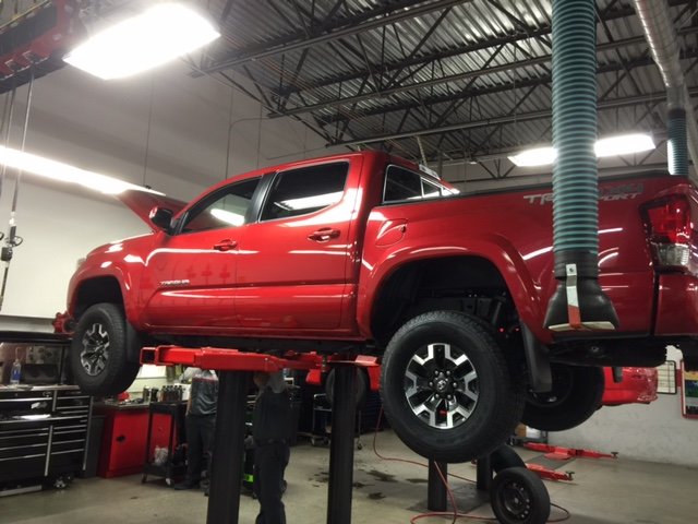

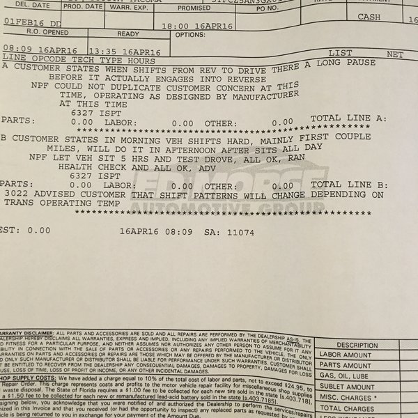

    Well you guys called it. Service wanted to keep the truck overnight but after a discussion opted for all day. Tech drove the truck and reported nothing out of the ordinary. They ran a health check??? But never actually checked the ATF. The S/A said they would only do this if they could reproduce the symptoms.
    I guess I'll have to contact another dealer. Hopefully I won't get more scripted Toyota speak.
    Lol I just read the print out and the mileage in was the same as going out , so they never test drove it like they said. Wtf...
