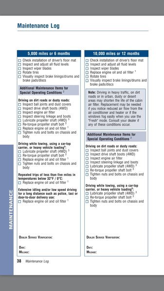

    Point out in the Warranty/maintainance manual it says "inspect and adjust all fluid levels". As in ALL! It doesn't say except ATF. image.jpg

    You may wish to point them to page 38 of the Warranty and Maintenance manual that came with your truck. It states "Inspect and adjust all fluid levels", not "all but the transmission".
