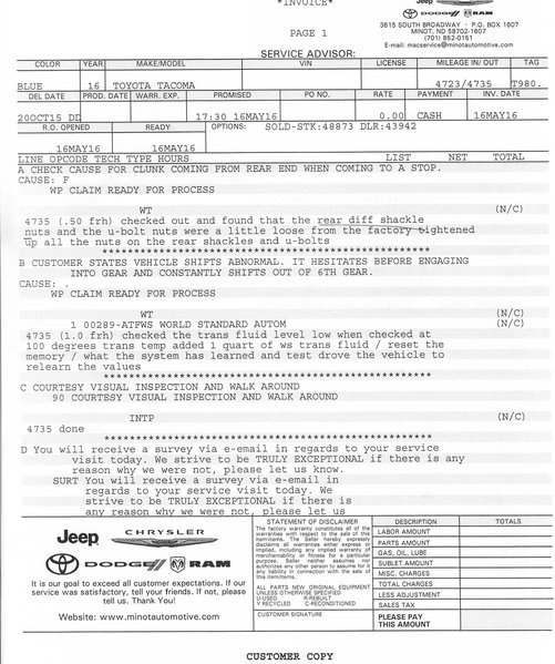

    follow up on this service. I drove down to state capital Saturday and the transmission is now totally different. I usually do 74mph on cruise and we always have wind.
    drive down, tail wind 10-20, 74mph cruise set. didn't need to do sport shift the way down. left in drive mode and transmission shifted down to 5/4 and would promptly shift back to 6 in short order compared to before where it would stay in 4 and maybe shift up to 5th.
    drive back, head wind 10-20 mph, cruise set at 74mph. left in drive mode, would shift down to 4/5 a lot (hills/head wind) but depending on incline/head wind would stay in 4th (didn't happen a lot) or kick up to 5th and stay (happened about 50%). otherwise it would shift back to 6th when it could.
    overall big improvement on mileage, was getting about 19.x mph with tailwind and about 17.x into a head wind. this was about 2-4 mph increase in mpg compared to before.
    side now, the lag shift from P to D is now a lot more pronounced.
