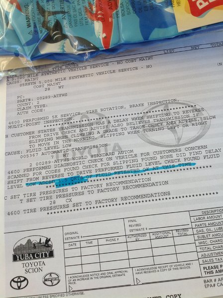

    The hiccups/delay from reverse to drive is no longer an issue since the dealer added a quart and a half of atf on Saturday. The hiccup I used to feel accelerating through the gears is also non existent.
