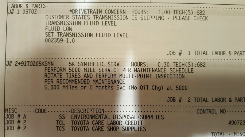

    The tranny was slipping on my truck since the night I brought it home. "January 23". Saleman told me on Jan. 25 when I talked with him. Told me the transmission was in learning mode and this was normal. Yyyyyaaaaaa.
    Finally got a chance to deal with this today after reading what others on this sight have been saying. So I started by calling the dealer I purchased the truck from. They would be able to get it in late next week or the following week. That won't work.
    So I began calling dealers in Arkansas and Missouri and asking for the service advisor. Then asking if they have had any problems with low fluid level in tranny. After calling the 8th dealer which was 3 hours away, Bingo. Yes we have had two customers report this. I asked if they could check my truck out today. They said sure no problem bring it on up. So 3 hours later........
    The dealer let me watch the tech do the check and it was over 1 quart low. He also reset the transmission computer. I watched him do this also along with checking the u joints which were fine. Truck drives great now. Just hope the low fluid doesnt hurt tranny. Mine had 2478 on it this morning and now has 6 hours worth of driving on it today. Will put 900 miles on it Sunday night into Monday when going to work. Hopefully this is all done now. 3 weeks later my truck finally is driving like it should.
    Here is a picture of the work done. Dealership is Joe Machens in Columbia Missouri. Didn't even buy the truck there and they were more helpful than the dealer I purchased my truck from.
    By the way my bill was ZERO for them to check the tranny fluid and fill. Hope this helps.
