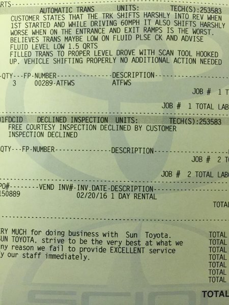

    Add me to the list of people low on transmission fluid. I was 1.5 quarts low.

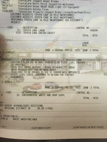

    All of this is after I went to a different dealership. The first one I went to (Wesley Chapel Toyota in Tampa Bay) said that they couldn't reproduce the problem. Then, I drove with the "service manager" and he noticed the problem, but said that they could not check without permission from corporate Toyota. After arguing with him about that I was getting ready to leave and my service advisor said that they DID indeed check it and it was fine. All of this is to say that there are some shady people working at WCT, and probably many other dealerships. I got a call the next day from the actual service manager saying that everything had been checked and came back good. Why would they want you driving around in something with a potential issue for the potential to get worse? Idk.
    Sun Toyota (who I bought from) said they had no problem checking the level immediately and to bring it in right away.
    I have attached both of my service tickets. You can be your own judge.

    That's what my dealer told me. If they couldn't observe the slip they won't check fluid.
    I suspect this has to do with the dealer trying to get paid from Toyota for warranty work. If they can't observe a problem, they won't do anything because Toyota might question, why did they "waste" time fixing something if the dealer didn't observe the problem.
    But it sounds like some dealerships have techs who know how to check fluid level on a sealed unit, while others don't. Mine, didn't because they said they have to drain the entire transmission, which we all know is BS.
