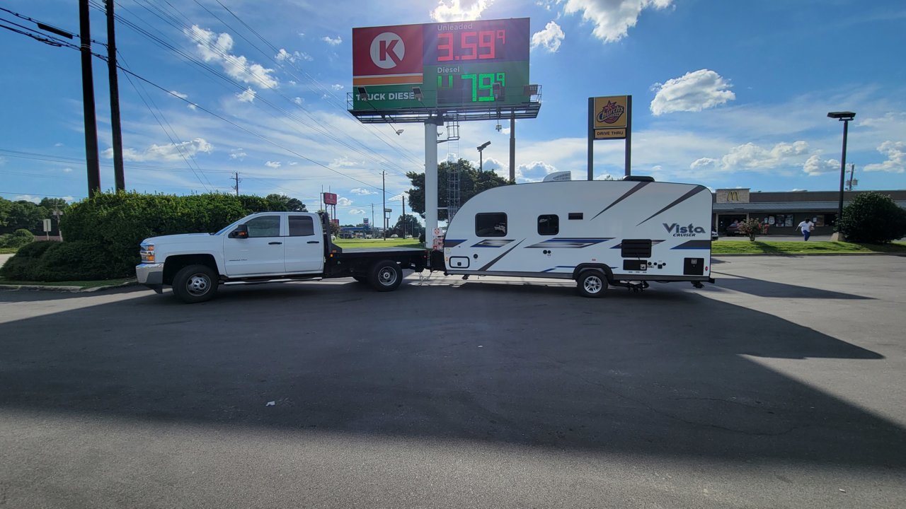

    By comparison, when I purchased the camper, I pulled it home with a DuraMax dually. It pulled it VERY well... but only got 12 mpg. So really, both Tacoma's do OK in the gas mileage department.

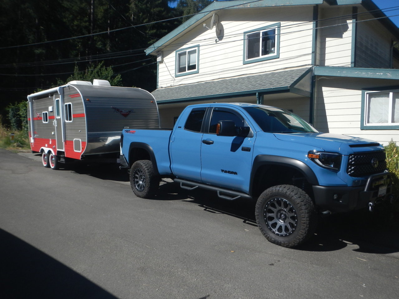

    FIFY :D

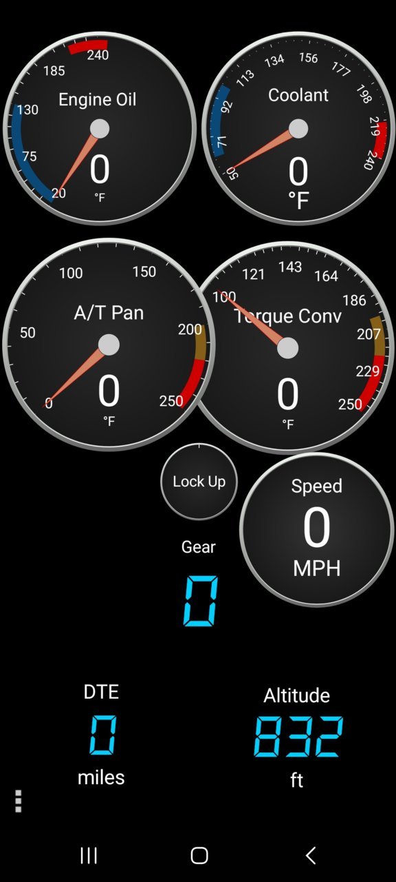

    I'm also in the process of setting up and learning Fusion to monitor the trans Temps from my phone. Here's a screen shot of my current "dashboard". It will be a work in progress for a little while.

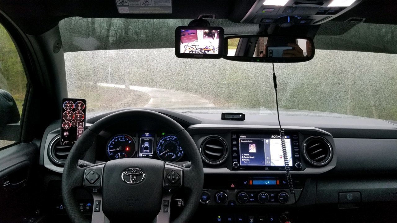

    I hooked up this mourning to head to Tim's Ford St Park in TN and snapped a few pics showing where I have various components. The Fusion app, Tymate TPMS and the Dohonest camera seem to check the boxes for my needs. I want to keep the clutter to a minimum and remove the TPMS and cam monitor when now towing. I intend to hardwire a connection point for the RV cam in the future.

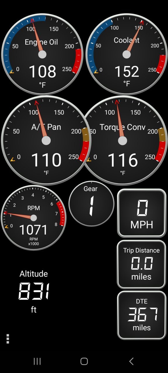

    Here's a screenshot of the Fusion app that's displayed on my phone to the left of my steering wheel. My main concern is trans Temps but I'm monitoring a few things that will come in handy if I take a screenshot at any point in time. The circle with the gear will show green when the converter is locked and red when it's not.... well at least most of the time it does. o_O It's a work in progress.

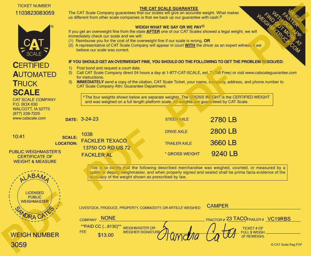

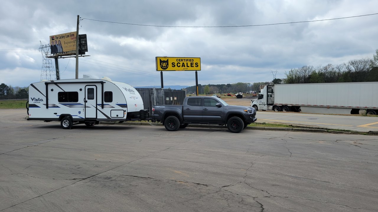

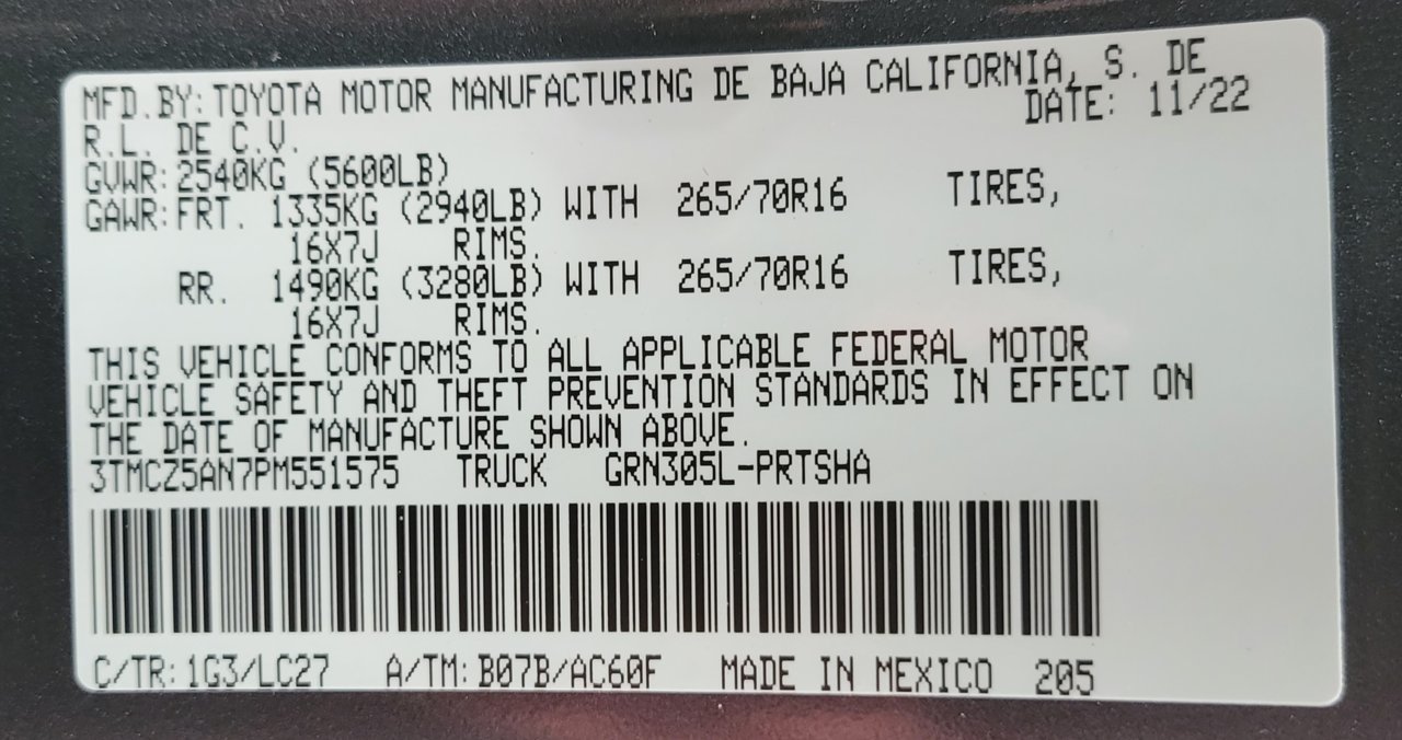

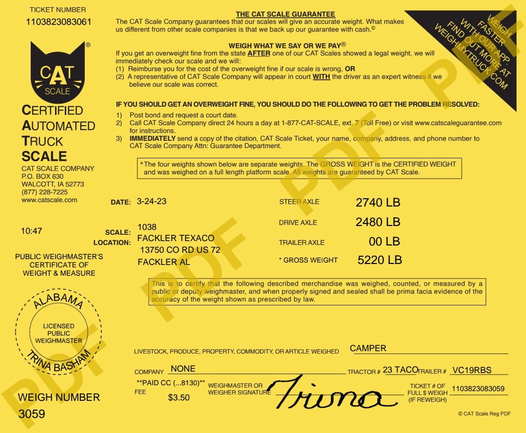

    Here's my first trip across a CAT scale.
    Here's my truck which includes: me (150lbs), wife(140 lbs) and small amount of gear. My 2023 TRD OR has a GVWR of 5600 lbs.
    Travel trailer VC19RBS has a GVWR 4380 lbs and combined should be GCVWR 9980 lbs. We are certainly under weight due to being light packers.
