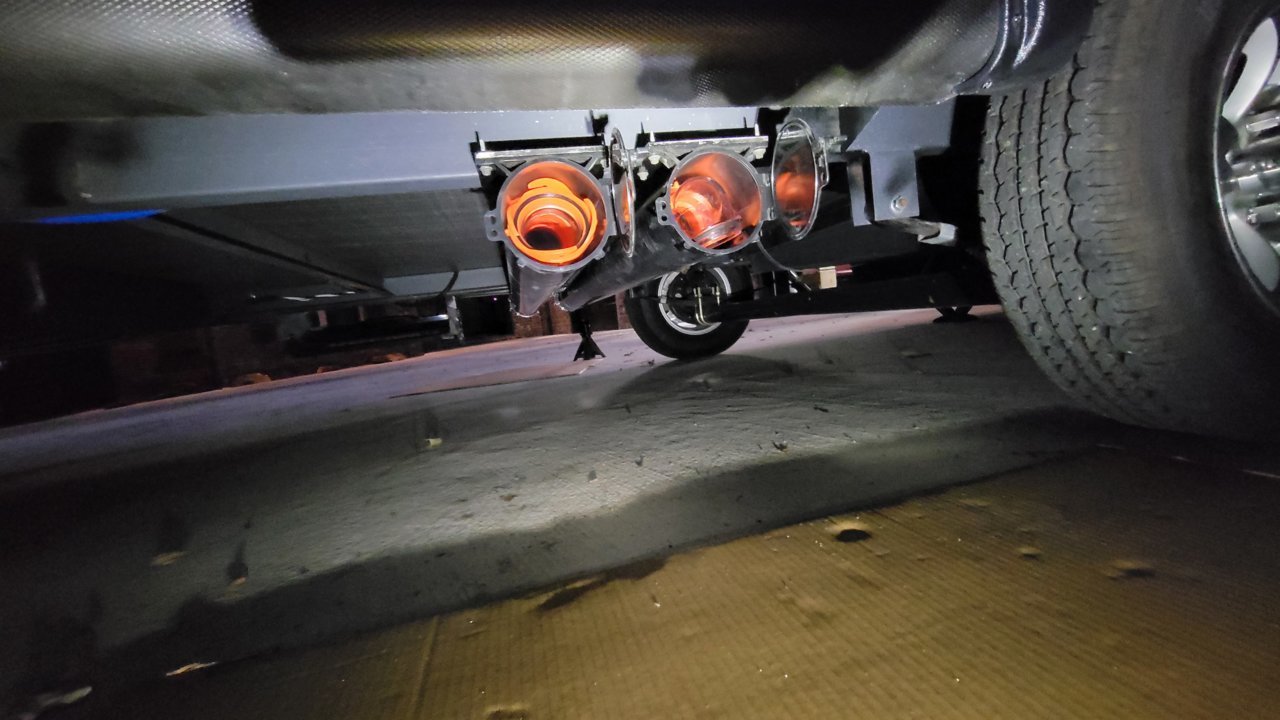

    Overall, it's been a great experience. I don't mind the set up or take down and sort of look forward to the next adventure. I added sewer hose storage under the trailer which is fantastic. Every piece of hose and sewer connection goes in these two tubes including (3) 10' sections of Rino. :thumbsup:

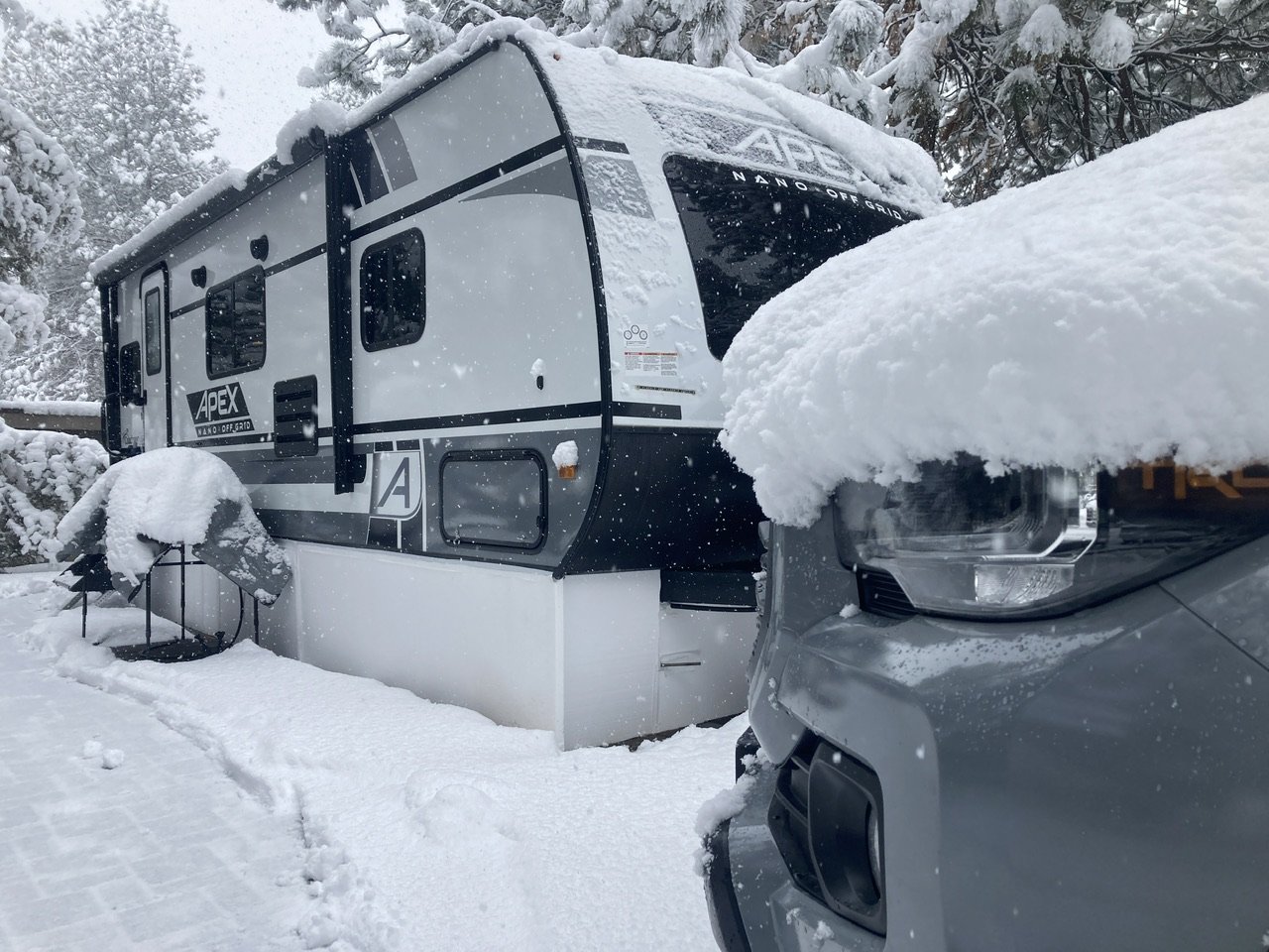

    Keep a periodic eye on all water connections they come loose after a while. Also the hot and cold flexible hose going to and coming from the water heater get hot, get brittle and expand over time and will leak, I just replace mine as they were weeping and I thankfully caught it before it ruined the bench woodwork, the wood/cardboard has swelled at the bottom but could have been much worse!
    We’ve been in Bend OR for a while now, temps down to zero make you figure out the weak spots!

    Man, that photo makes me cold just looking at it. I know what you mean about projects. Wow, a year and a half is quite an adventure and I've enjoyed reading about them. I'm amazed that your financially able to do that..... you've done something right. We'll be totally out of debt(again) in mid summer when I pay off the new truck but I got a late start on retirement and have some catching up to do.

    That storage for your sewer hose is neat, all but the elbow fits in my bumper.

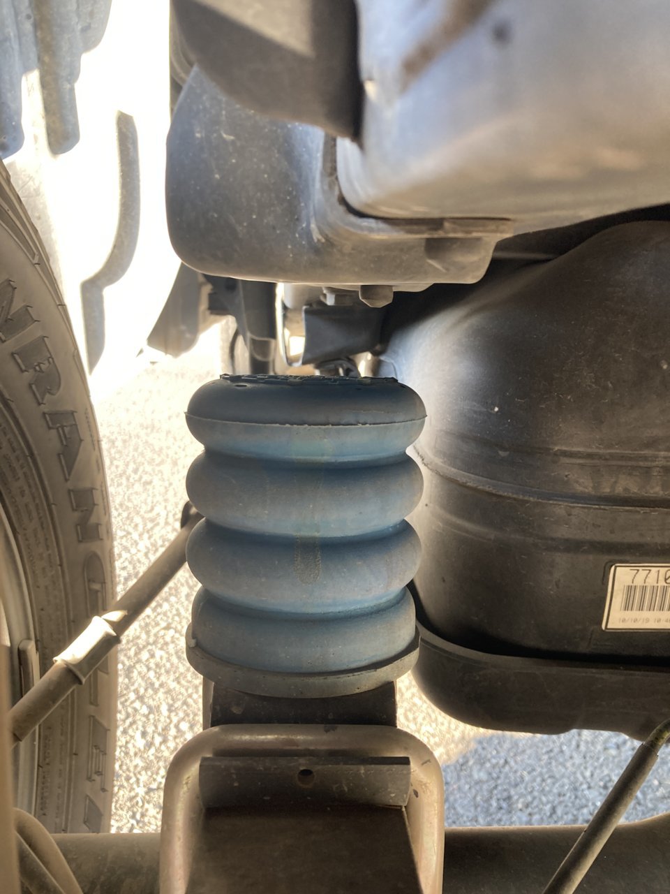

    Just blue sumos for me, 5k lb loaded, Anderson WDH, no sag. Sumos barely touch the frame if at all when hooked up.
    Photo of sumos unhitched…

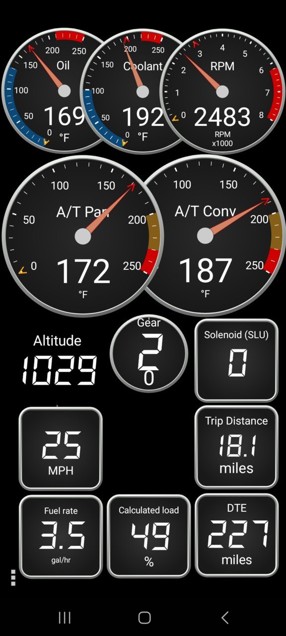

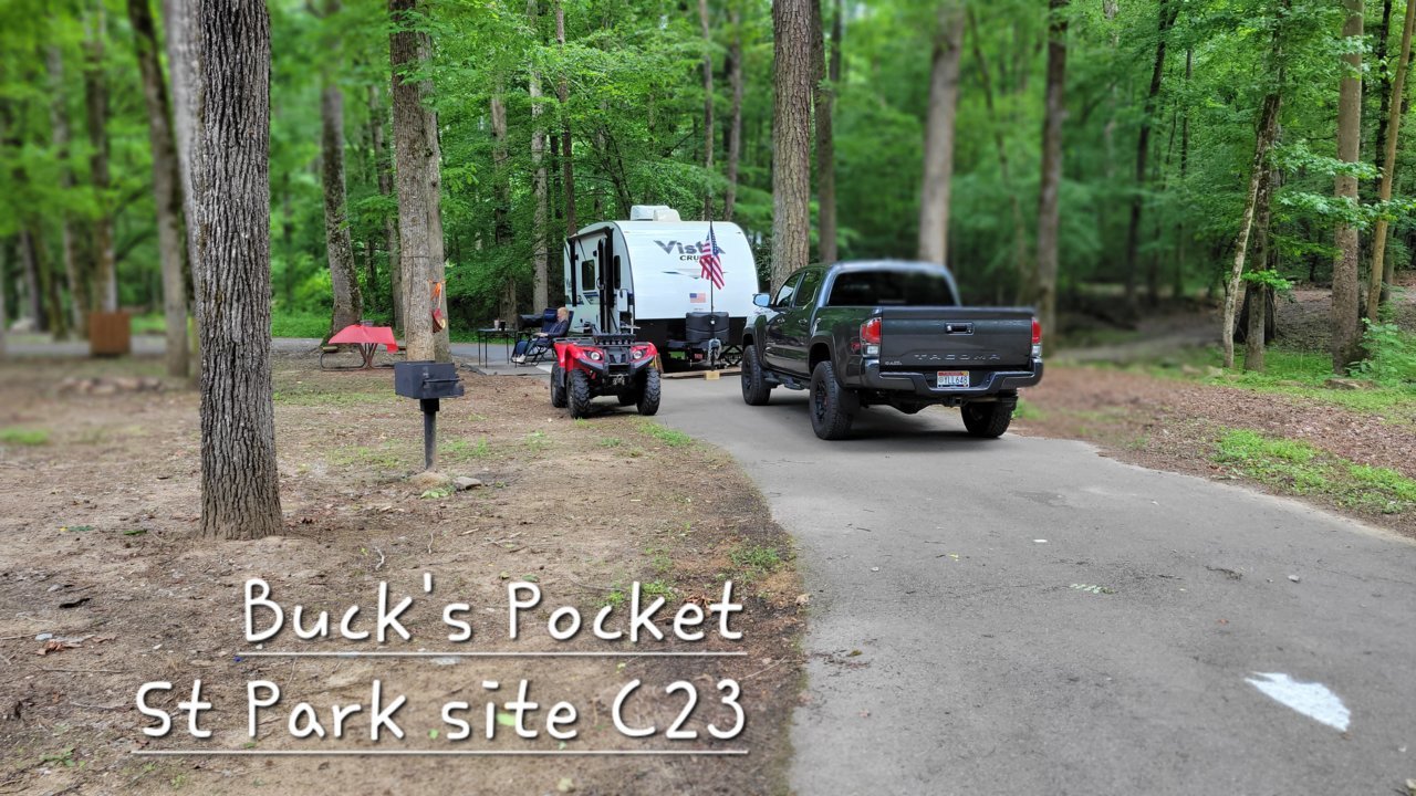

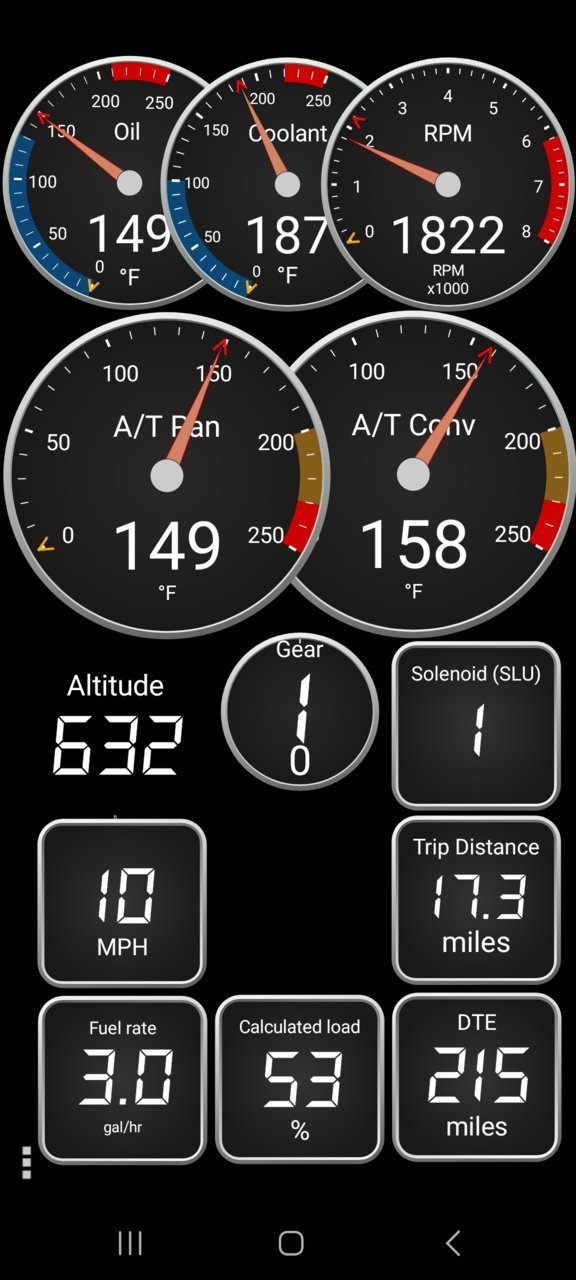

    Wife and I pulled trailer to Bucks Pocket State Park this weekend and I'm so happy to say that the Taco did awesome pulling up out of the "pocket". I had to start from a stand still at the base of the mountain and used S1 and S2 because the road had some rough spots and and had some winding turns. I kept the revs between 2500 and 3000 RPM and the trans temps never got over 190 deg. :thumbsup: I do have the trans T-stat pinned open and I have KDmax 9.0 tune since my last tow. Here's the screenshots at the base and the top. 400' ascend in .8 miles. I'm very pleased with how the Taco pulls... just gotta shift like you would a manual and get the revs up a little(honestly, 3k is still pretty low but worked well with the speed I wanted to maintain).
    At base just getting started:
    At crest (you can see my max RPM was 3k):
    I wish I would have watched what the load was at the steepest part.
    Trailer Weight is just over 4k lbs.
    Edited to add KDmax tune info.
