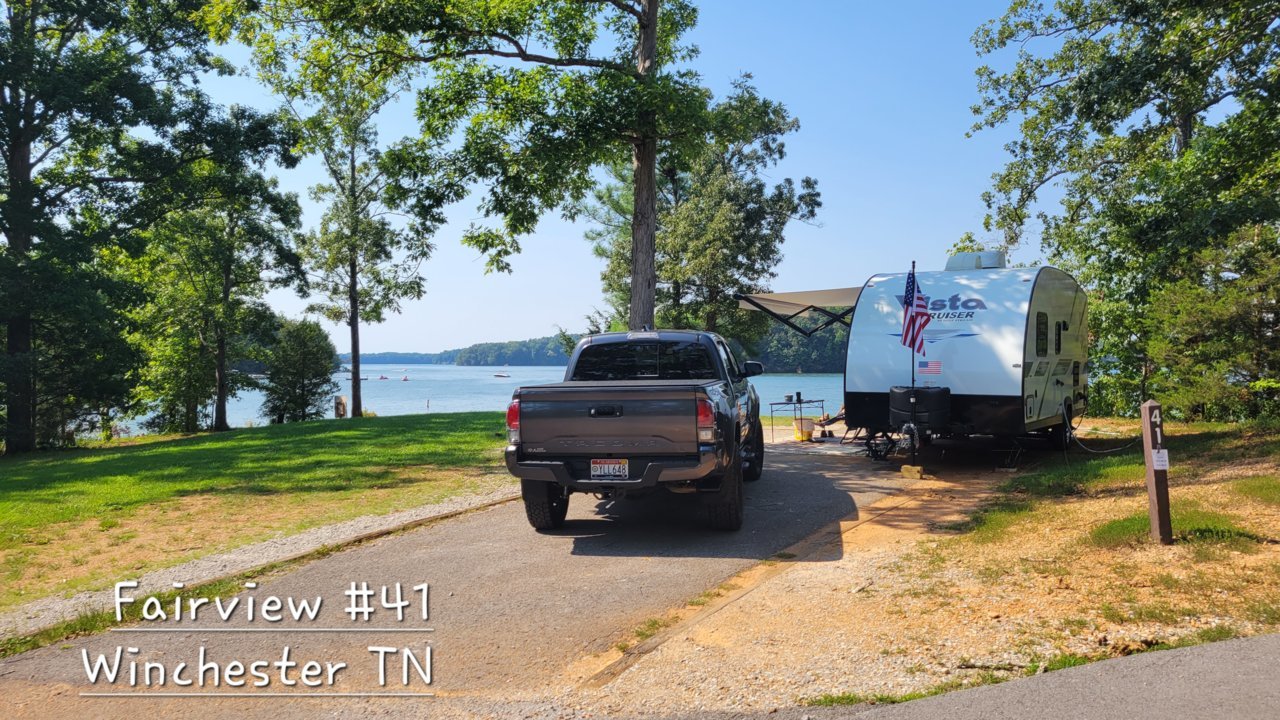

    We've had our trailer for a year and currently on our 9th outing at Tim Ford Fairview near Winchester TN. We're still really enjoying it. We take our bikes and enjoy hiking, biking, kicking back in the zero gravity chairs and learning to cook on the Blackstone. ;)
    We pulled in and were set up/hooked up in less than 45 min yesterday so this gets to be pretty easy.

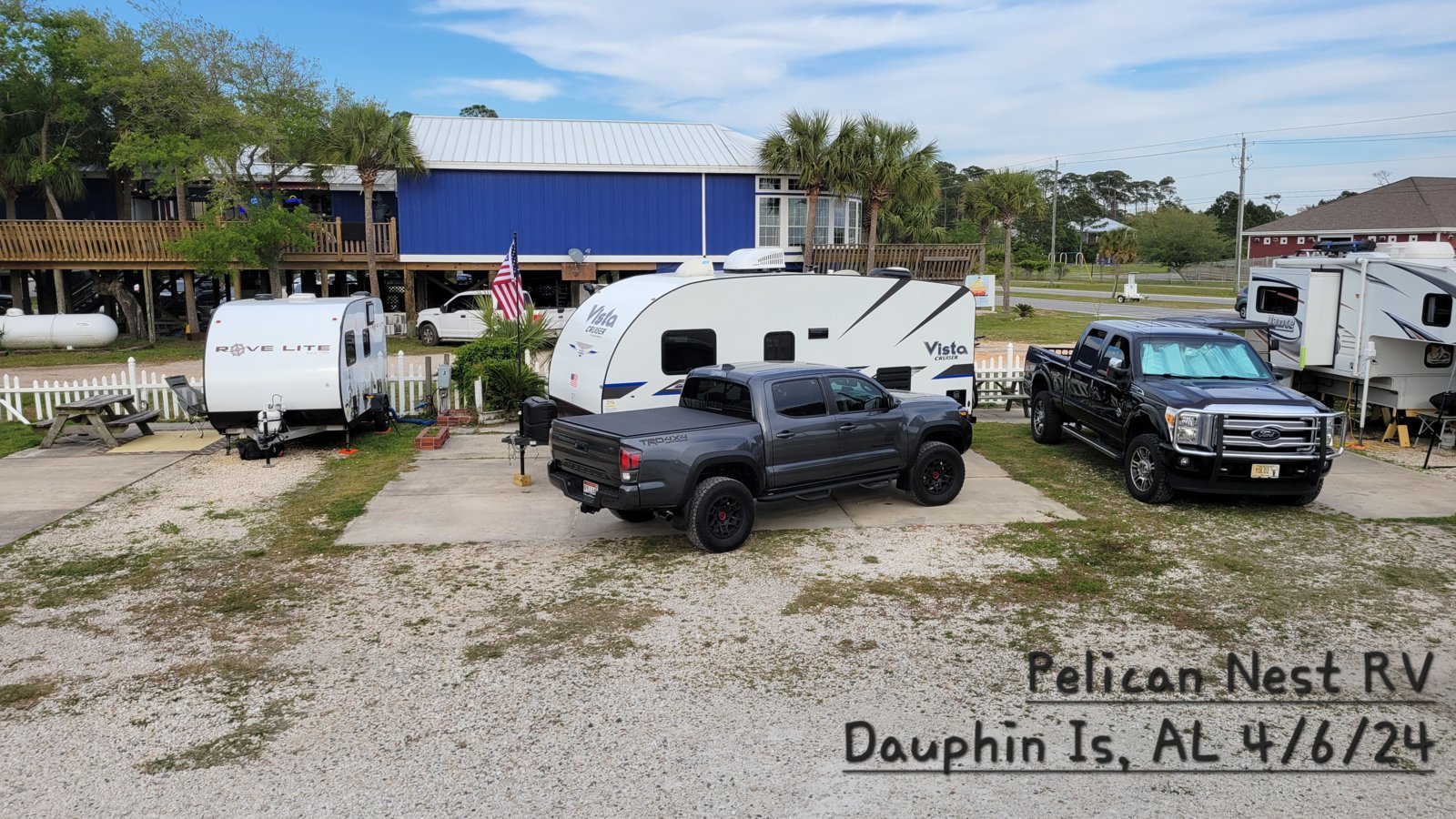

    This is our 10th outing with the travel trailer and our first that's more than 2 hours from home. We made the 5.5hr drive down I59 to I65 then to Dauphin Island. This was my first time pulling the camper on extended periods of interstate. I was surprised how much we were being blown around on the interstate. I did notice a few days later that the sway control bolt on my ReCurve R3 WDH wasn't as tight as it could have been so I'm hoping that will help some on the way home tomorrow. We pulled across a CAT scale South of Birmingham:
    2720 Steer Axle (2940 GAWR)
    2840 Drive Axle (3280 GAWR)
    3740 Trailer Axle (4000 GAWR)
    9300 Gross Weight
    We stayed one night at South Montgomery RV Park and we were impressed with the park(pic below). Clean bathrooms, nice pull through sites and we didn't even unhook from the truck which was something that I underappreciated prior to this one night quick stay. Was just over $50/night with Veteran discount.
    The next day we drove another 2.5 hours to Dauphin Island and stayed two nights at Pelican Nest for just under $100 for both nights(with Veteran discount). Sites were pretty close together but the overall experience was good. We ended up on a site that was pretty wide and I angled the camper to try to gain a little more exposure to the ocean that we couldn't see, LOL(pic below). In hindsight, I wish I would have backed in straight. We caught a nice sunset and walk on the beach at the West Beach(pic below), checked out the Sea Lab and Ft Gaines.
    After two nights on Dauphin Island we were fortunate enough to be able to get the truck and camper on the ferry across Mobile Bay which saved us well over an hour and a half of driving over to Ft Morgan.
    More to come.....
