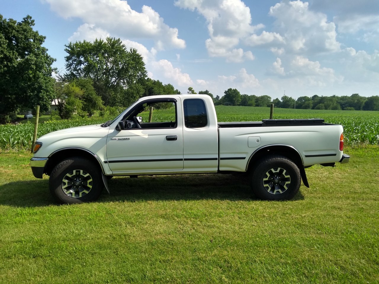

    The original 1st gen
    Here and there over the years
    Direct bolt on...

  9. Jul 9, 2019 at 10:07 AM
    Travish325
    Travish325 Well-Known Member
    Mar 31, 2019
    #288625
    2,580
    That looks great!

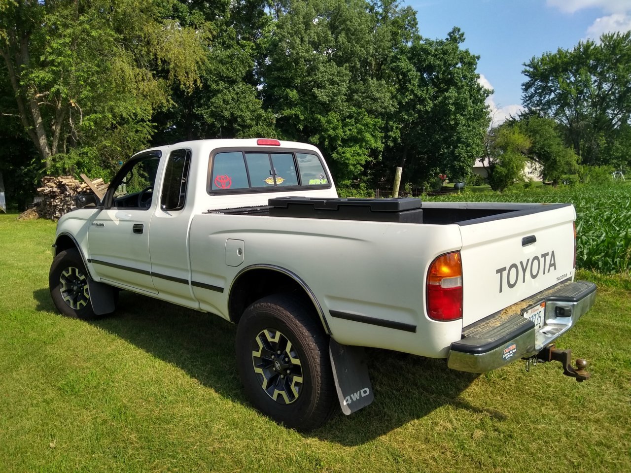

  11. Jul 9, 2019 at 11:06 AM
    OldSchool97
    OldSchool97 New Member
    Jul 1, 2019
    #298018
    4
    Steven
    Central Illinoyed
    I have my 97 original wheels, I have the 2002 wheels pictured above(I did have to buy the shafted lug nuts) and now I just upgraded with trend to 2019 taco's offroad wheels(used my shafted lug nuts from my 2002 wheels). the original 97 wheels are 15" and the 2002 & 2019 wheels are 16". This will allow me now to perform the tundra front brake upgrade since i don't need the 15" anymore (clearance issue with bigger caliper).
