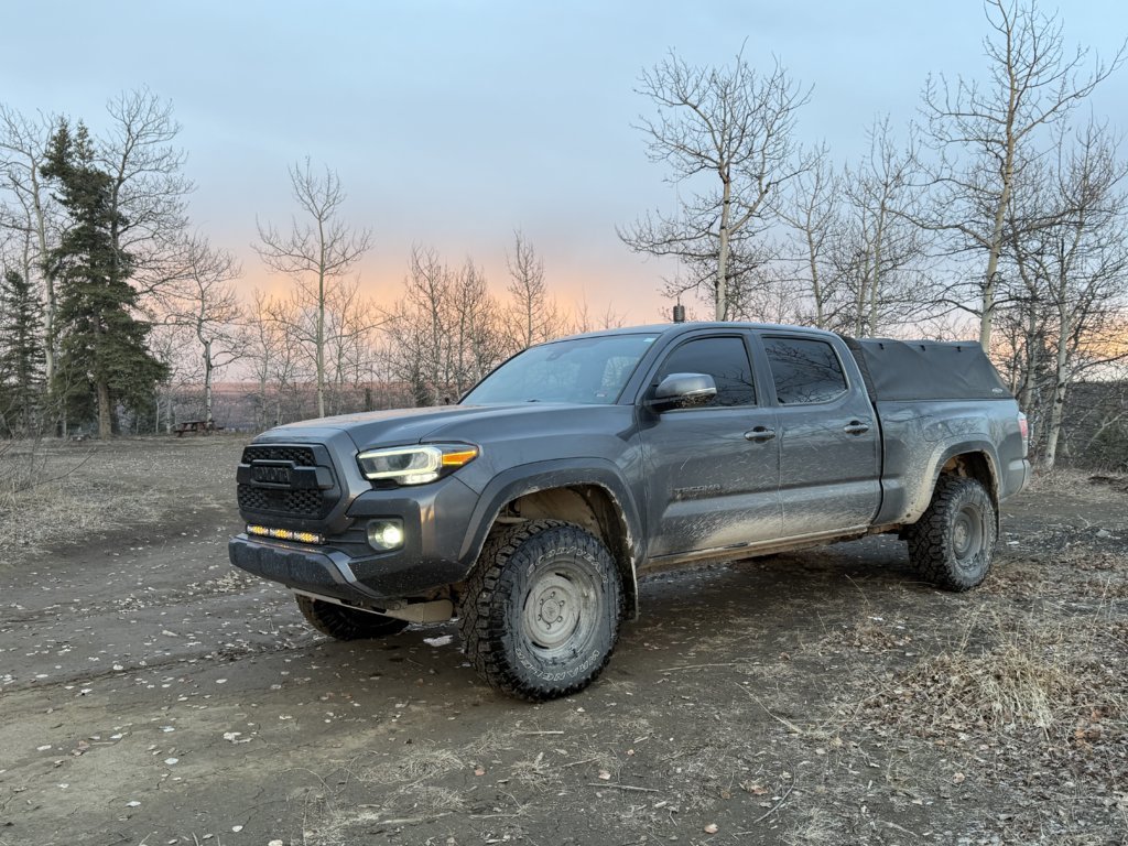

    Ive had a 21 OR for 4 years now and have done a mix of light off road/long road trips. Currently running billstein 5100s, tires arent great - goodyear all terrains, not sure of the exact model. Gonna switch to falkens I think soon. The shocks are great though, huge improvement over stock. Firm on road but definetely handle our old logging/resource roads up here.

    Really like them so far, they've taken me through an Alberta winter and into the summer - I tend to go on moderate/light offroad trips in between long drives to & from work. They feel firmer than stock on road which is nice, and give great feedback when offroading. The great thing with them, as I understand you can leave your truck stock height (mine is) and then if you want to put a lift they will work with that also. Personally, if you're looking for advice on what to add to your truck, I'd echo what these other people have said, leave it stock go on adventures and add what you need. You really don't need much to have fun with these trucks!
