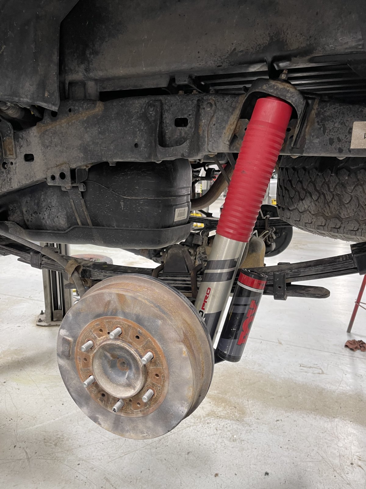

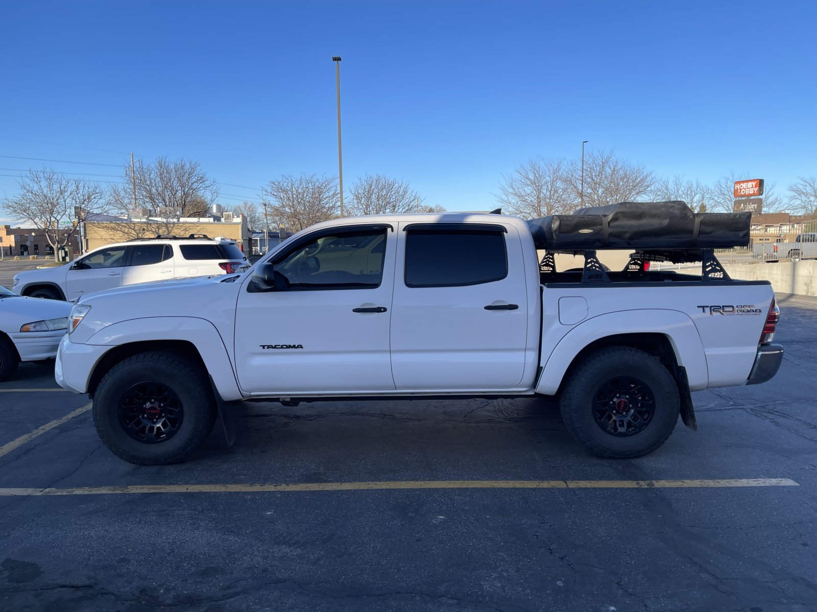

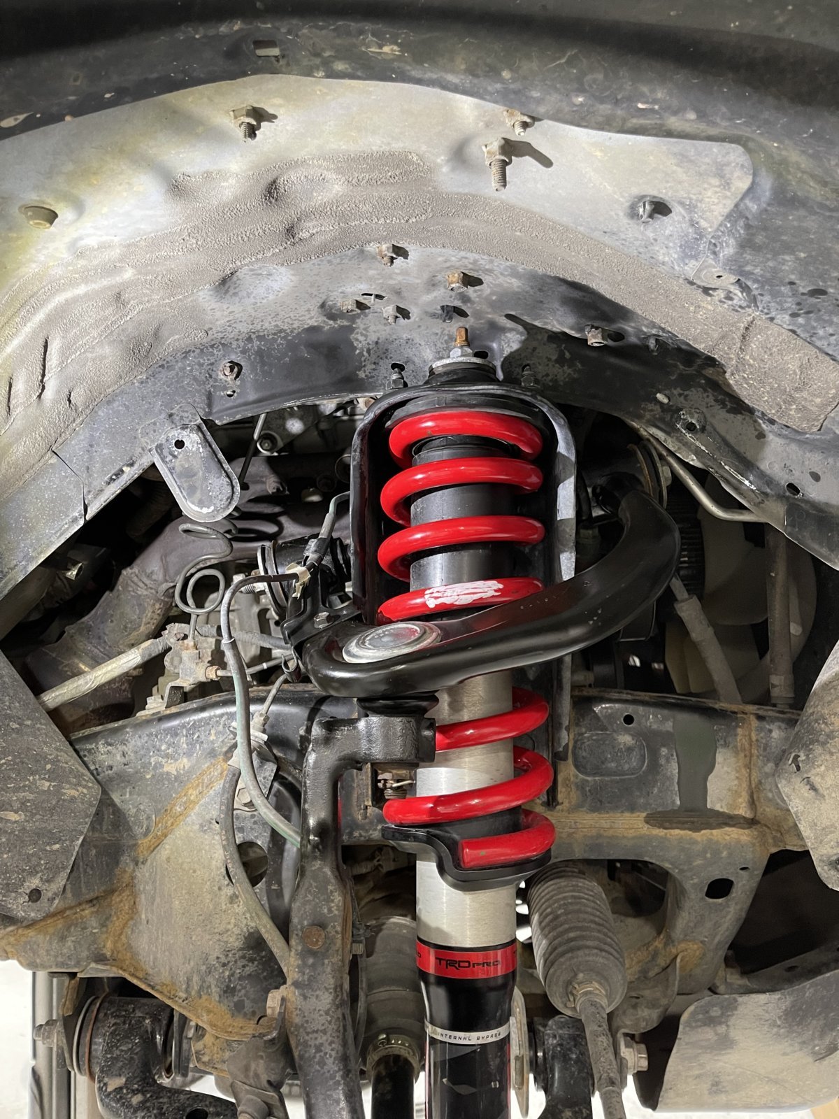

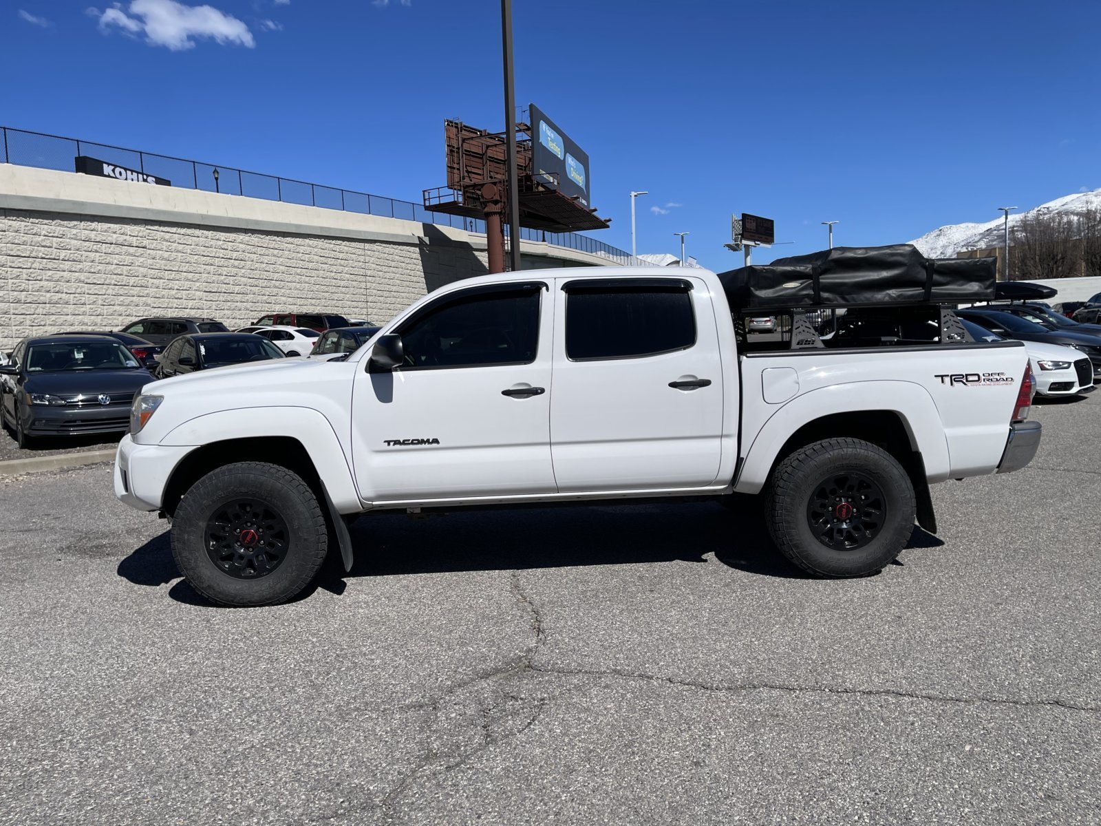

    Not a lot of these treads on here that I can find, so I wanted to share my experience. I picked up a full set of TRD PRO suspension off a 2021 tacoma with 10k miles (front and rear shocks, leaf springs and upper control arms). They are all in great condition. Install was a breeze, am a mechanic and can use my bay in my free time. Truck feels much more stable when going over any size bump, less body roll (sway bar is removed) and just feels like a tighter and more controlled ride. I’d say it was $800 well spent. Even took it in some dirt lots around my area and had some fun, these shocks soak up a lot. Lighting in the before and after pictures is completely different I apologize.
    Ground to fender measurements
    Before
    LF 34.5”
    RF 35.25”
    LR 35.25”
    RR 35.5”
    After
    LF 37”
    RF 37.5”
    LR 37.5”
    RR 37.5
    Settled
    LF 36.5”
    RF 37”
    LR 37”
    RR 37.5”
    Overall gain
    LF 2”
    RF 1.75”
    LR 1.75”
    RR 2”
