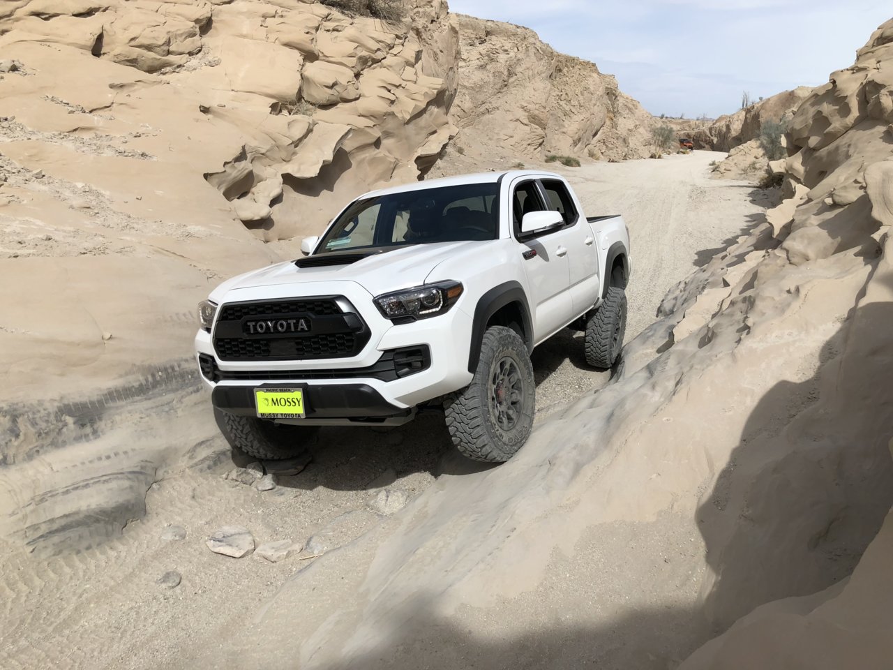

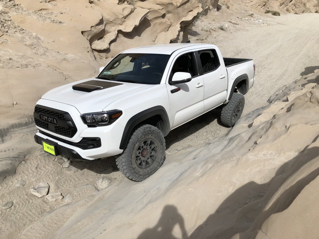

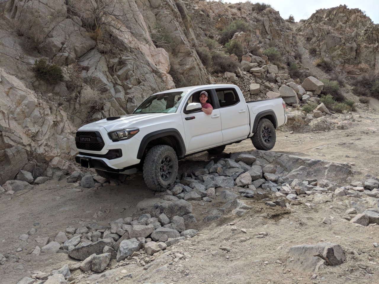

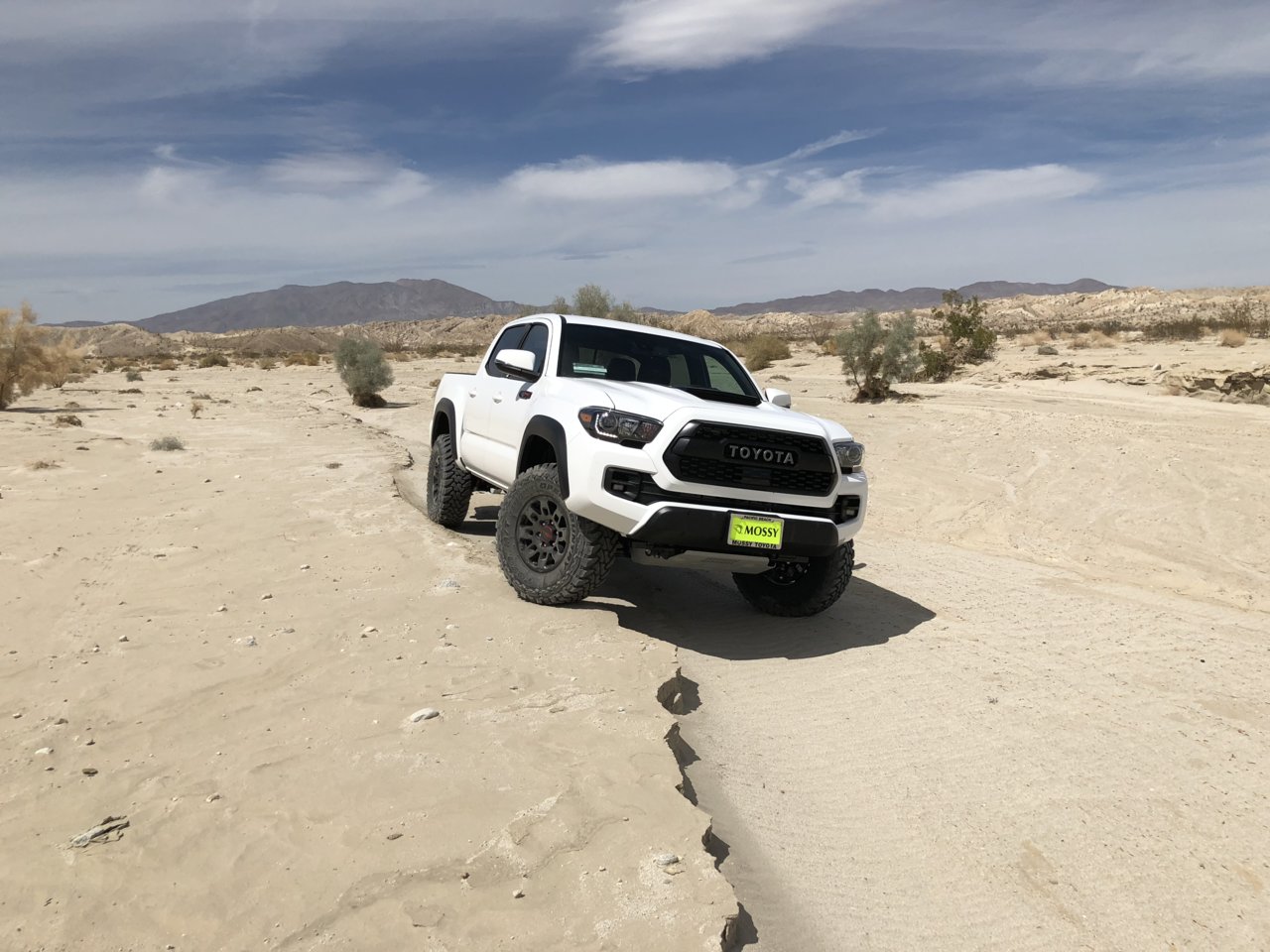

    Here are some photos of me in SoCal:
    You can see here there is a nice amount of suspension travel, really sets you up for some good traction (and good pictures). To answer your questions, yes, the first thing I did with this truck was take it off roading! That's why I bought it!

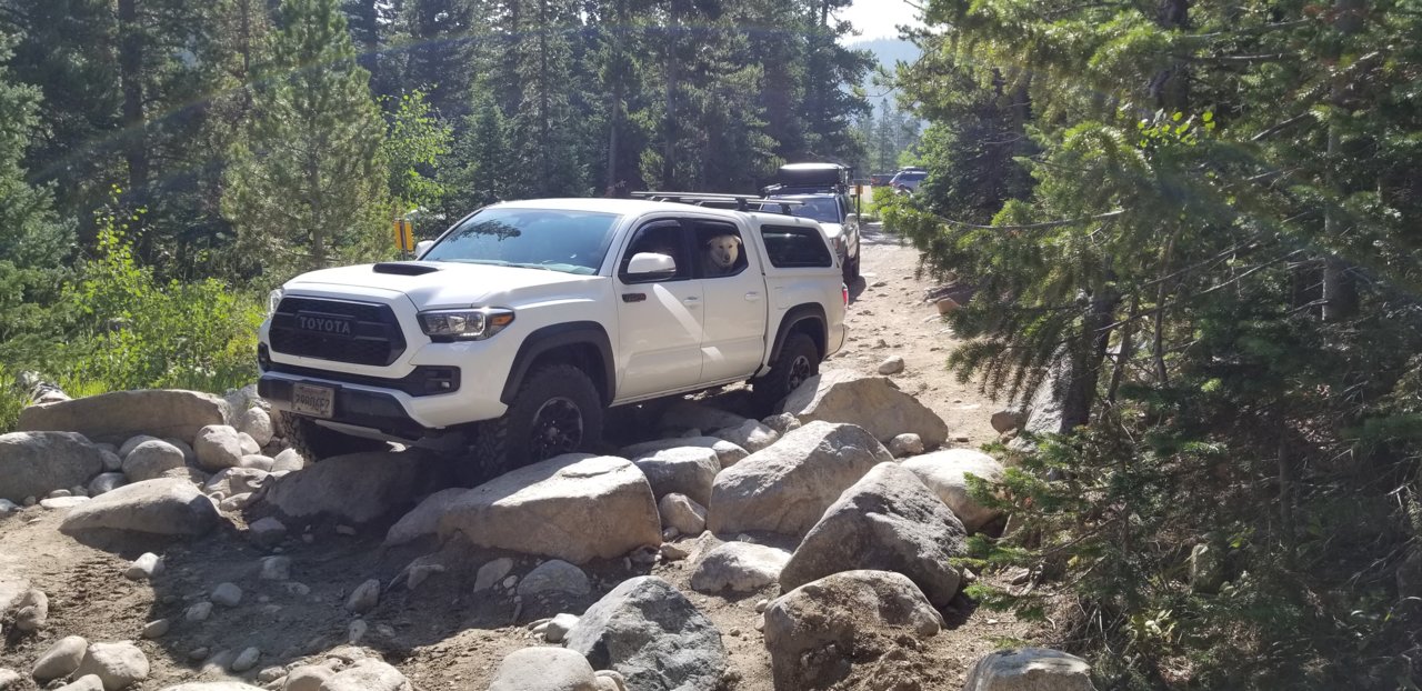

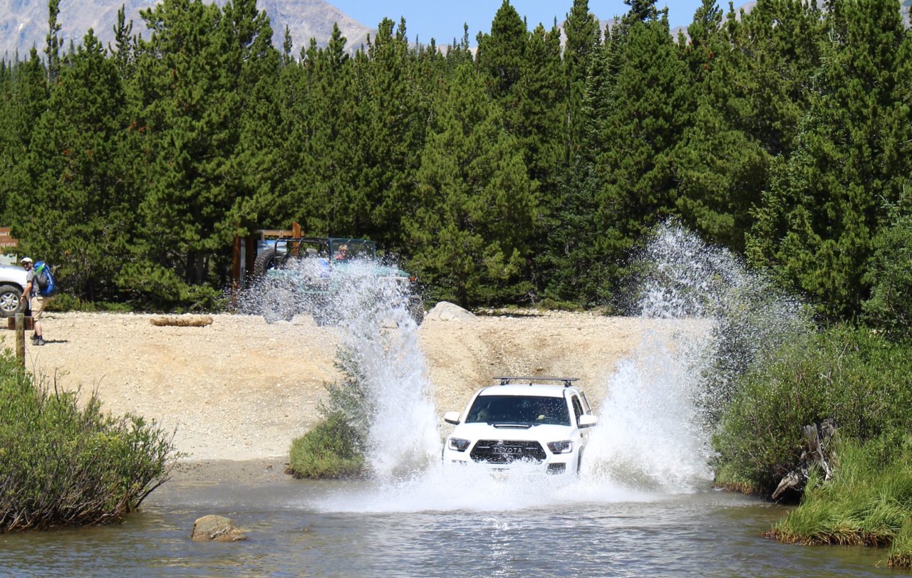

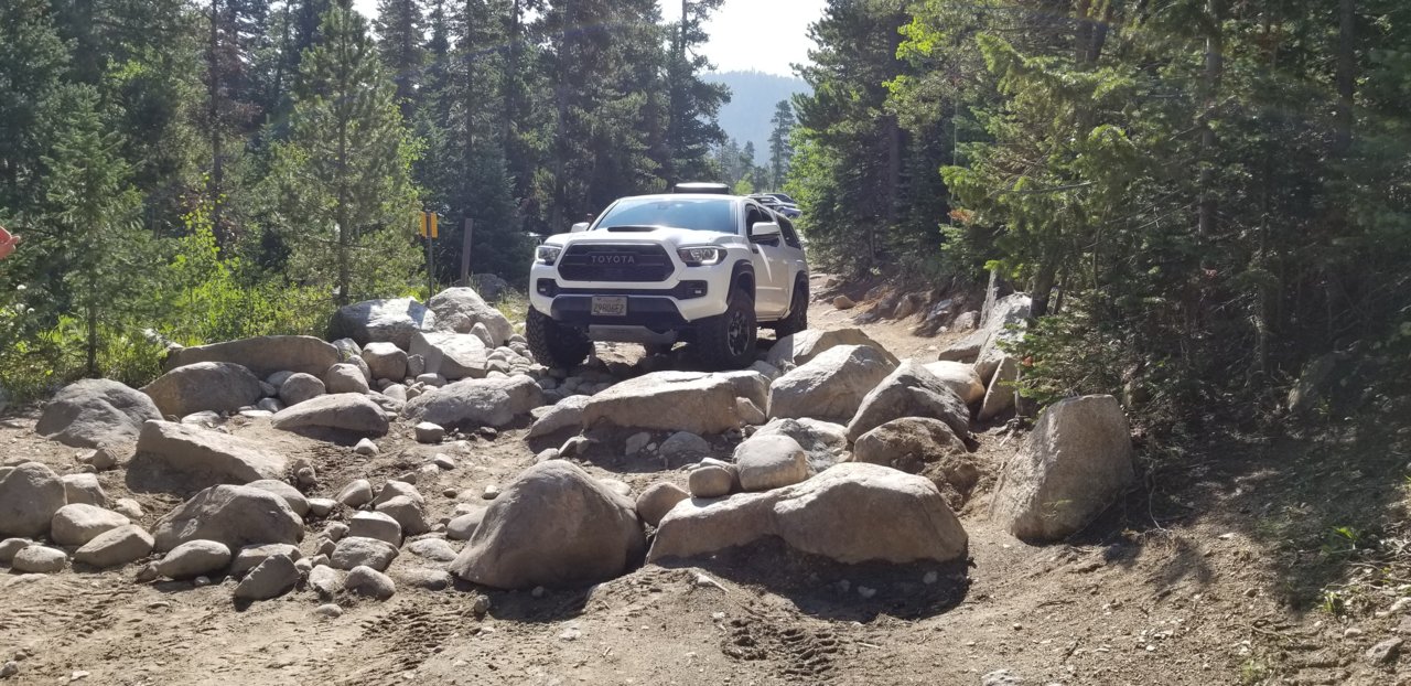

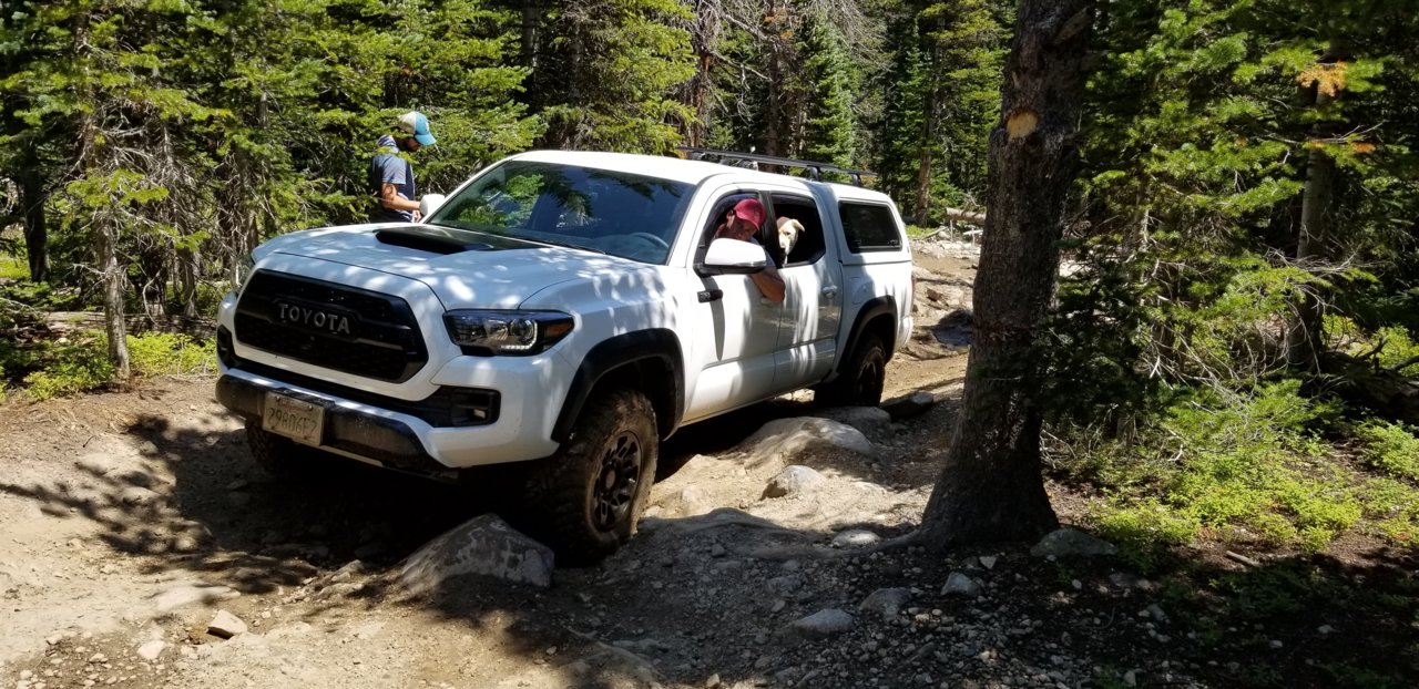

    Here are some photos from some of my Denver trips:
    As I hope most people can see, the truck is super capable. I have never had rock sliders, or anything other than the stock front skid plate, and at most I've only ever bumped my skid plate a few times on some of those rocks. As some of you noticed, I did put mud tires on the truck vs the factory all terrains. These tires are 265/75-16 which is about 1" taller than the stock 265/70-16 tires. This will give about 1/2" more clearance than stock (not much). I would have went with stock size MTs but this was the smallest size Toyo MT they make.

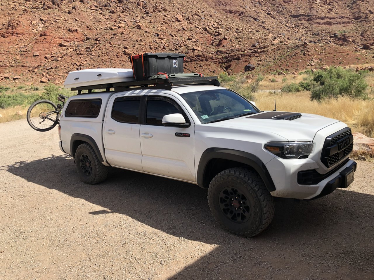

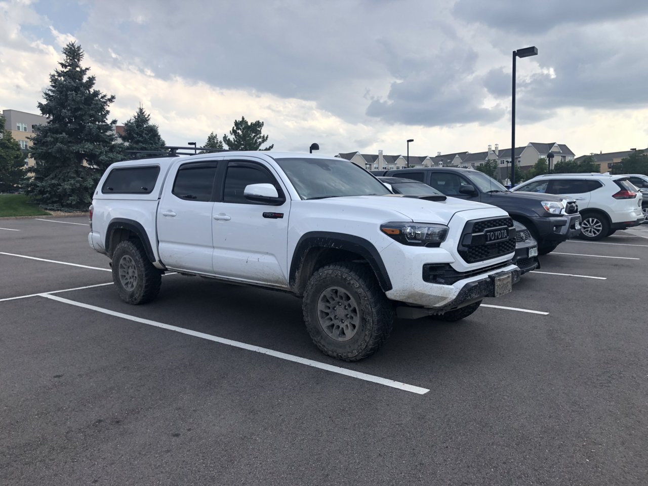

    Why am I upgrading?
    This can best be explained by looking at these two pictures:
    The top photo is the truck with nothing in the bed, only the weight of the canopy on top. The bottom photo is from my recent overland trip with the bed fully loaded. I have a drawer system, fridge, canopy, roof top tent, bike carrier, beer cooler, etc.. The squat is just too much, and makes the truck look and drive like crap. My hitch and bike carrier scraped like crazy and I bottomed the suspension out a lot.
    This issue could be solved a number of different ways, such as just a leaf pack in the rear, or airbags in the rear. I, however, would like the vehicle to be more capable than it already is. More ground clearance, better approach/departure angles, and bigger tires. I am going to be going with the OME BP-51 setup, with 2 extra leafs in the back. Also going to go with the 4Runner TRD Pro 17" wheels, and probably 33" Nitto ATs. I think this will give the truck a much better look, as well as being more capable.
