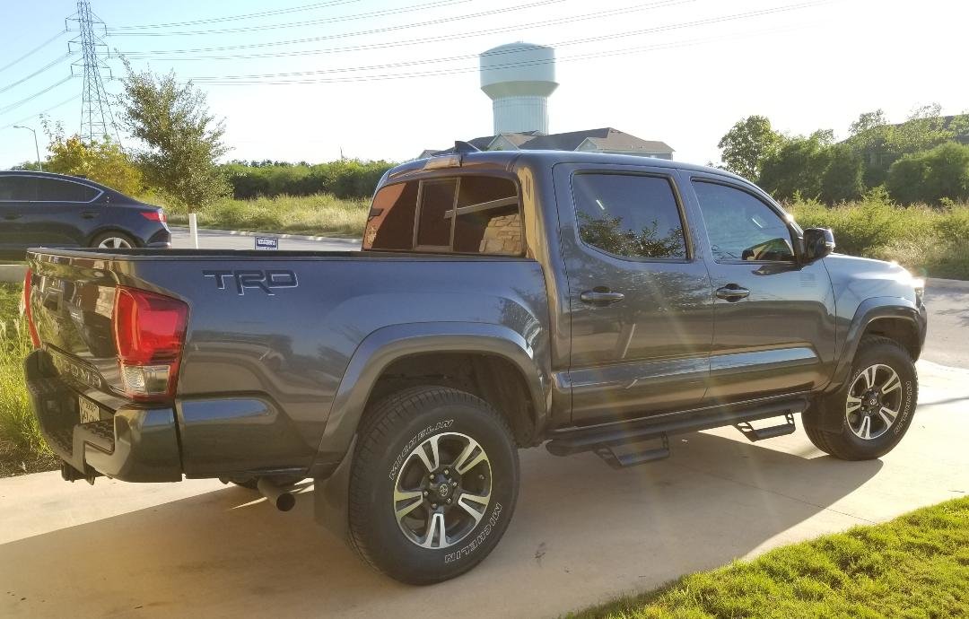

    Bought these at Costco.....rides very smooth. TRD Sport with stock rims.
    MICHELIN DEFENDER LTX 265/70R17

    Did Costco give you the option of mounting the white letters on the inside? The last set of tires I bought from Costco (BFG) I was told the letters had to be mounted out. I do like the Michelin letters on the Sport wheels though.

    Yes, they asked which I preferred. Glad I went with the lettering out. They did a great job balancing them too.....no shakes or shudders at any speed.

    After just over a month on these tires, I can't describe how happy I am with them. Man, they ride smooth and the height increase is exactly what I wanted. I no longer walk towards my truck and think....I need a lift.
