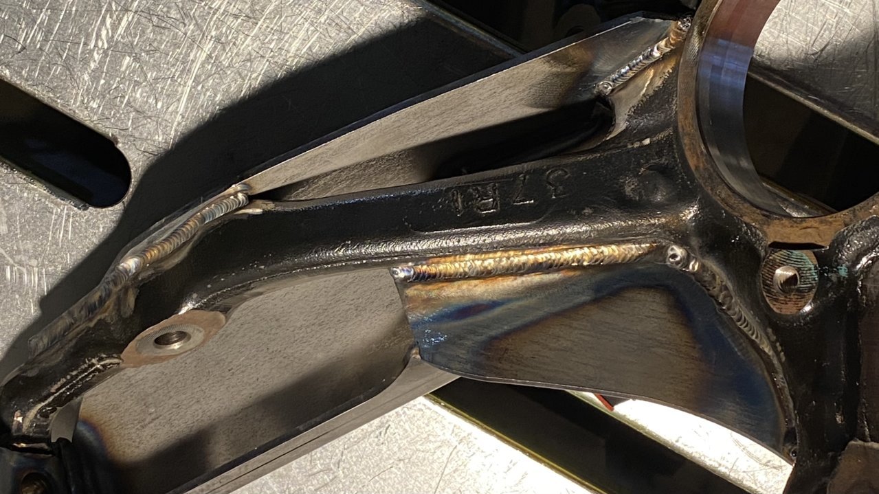

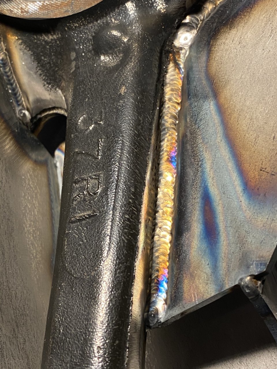

    Thanks! I’ve been tig welding a total chaos spindle gusset up, funny when you catch yourself stacking dimes on something nobody will see!

    What welder are you using, let’s see them if you don’t mind sharing

    I’m using an Amico TIG-225, I added a foot pedal to it though.
    Still working on it, got one side almost done. Taking my time to let it cool.

    Stellar fab work man! Very impressive, not only for a home DIY - this is better than most pro shops. When you've got form AND function with a weld. I have welded, but am by no means a welder. You sir, can stack dimes as evidenced in this photo:
    That is likely the singular best weld I have ever seen. Robotic precision. It's like weld porn.
    Flattery session ended :thumbsup:
