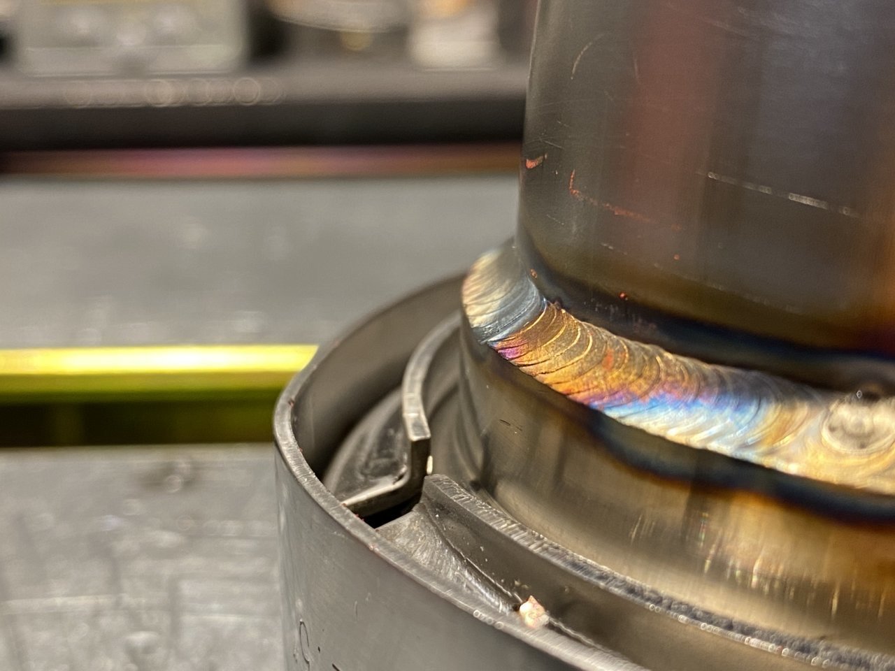

    Thanks man. The reality is, some turn out great and some not so much. I had to make myself quit trying to make it look perfect and focus on what’s important.
    Thanks! Yeah, got a bit carried away.
    You should totally do it. I Didn’t even raise the truck for all of it. One of the learning curves for me was how much stainless shrinks when welded. Lots of tack to hold in place. Another crazy thing, the full exhaust length expands when hot. Like almost 1/2”. When it cools it shrinks back! Crazy.
    Check out KaneKid Welds YouTube, insane skills. Learned a ton from his videos. HourGlassIngenuity is another one.
