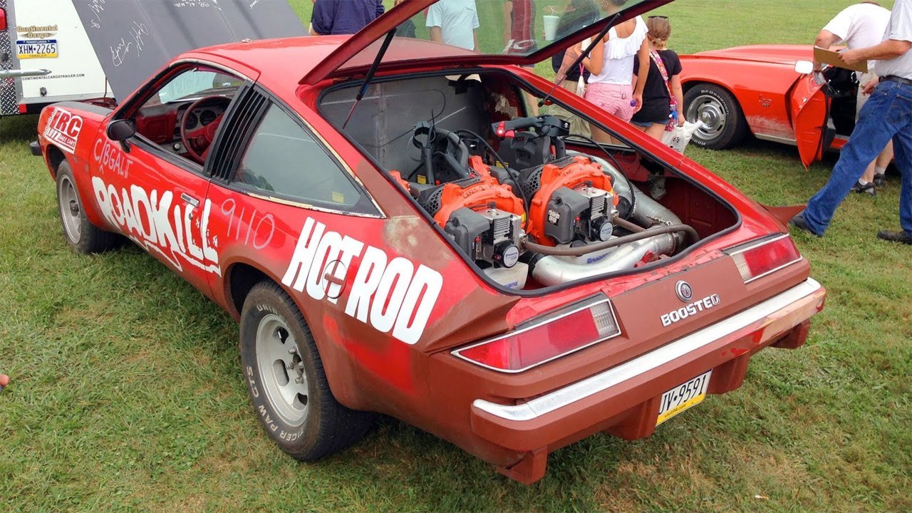

    Here's an idea!
    shakerhood likes this.
  12. Apr 5, 2018 at 9:52 AM
    #92
    Woodrow F Call
    Woodrow F Call Kindling crackles and the smoke curls up...
    Feb 23, 2016
    #179160
    3,889
    Colorful Colorado
    16 DCSB SR5 4X4 "ikea furniture haulers" edition.

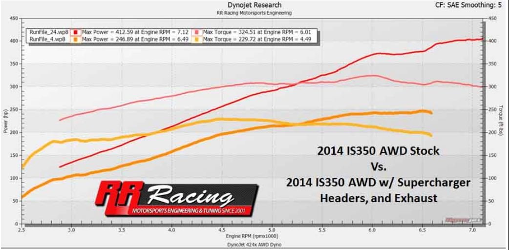

    RR Racing has recently come out with a 412 whp (490 crank hp) supercharger kit for the 3.5 in the GS/IS 350 (same motor). They have done extensive testing for reliability.
    I think it can handle it.
    http://www.rr-racing.com/RR-Racing-RR430-Supercharger-Kit-for-Lexus-IS3XX-p/isxscr1001.htm
    I inquired if they were working on a tacoma option, and they told me after the development for the Lexus was complete, they would work on a tacoma next.

    The IS/GS350 (from what you quoted about RR) uses the 2GR-FSE. completely different engine. Different ECU which 1/10th the complexity, different crank/ rods/ pistons / heads, everything.
