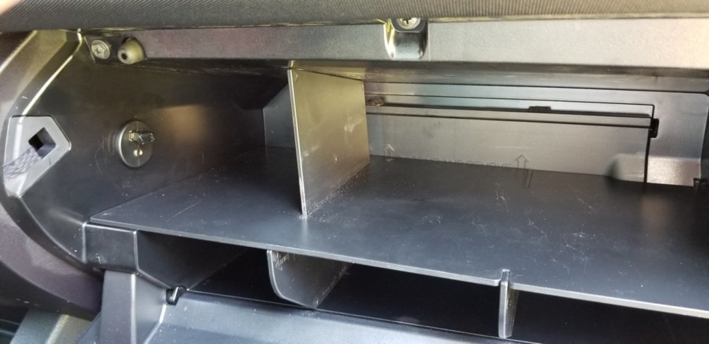

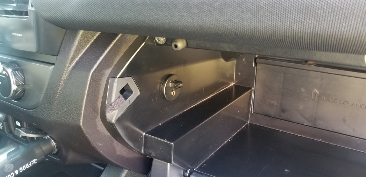

    It's easy to do. If I remember correctly I removed the headunit and was able to reach down and tap on the side of the glove box and get an idea of where to drill a hole. Bought the cable/ port below. Plugged it in the OEM plugs and left that behind the dash.
    BATIGE USB 3.0 & 3.5mm Car Mount Flush Cable 3.5mm + USB3.0 AUX Extension Dash Panel Waterproof Mount Cable for Car Boat and Motorcycle - 3ft https://www.amazon.com/dp/B072KGMJ5N20210814_125800.jpg 20210814_121009.jpg

    I did, I eventually clipped a corner of the air filter door and ran my cable through there. It's a more reversal solution than a hole in a non replaceable part.
