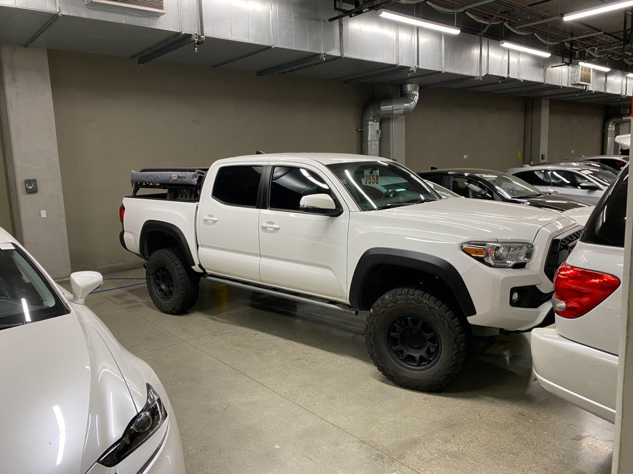

    A92D0643-84F4-4559-8FA3-D2BBADF32AE5.jpg Little update: Took the truck in for the scheduled vac pump replacement and got a rental. Was supposed to pick up the next day but dealer called later that evening and said that they got the truck to make the noise and it became apparent that its not the vac pump and that it's something internal and advised me that they will need to pull the motor and begin taking it apart to figure out what's wrong AND that it could take as long as a month to get the truck back. It's fully covered under warranty and they gave me an SR5 tacoma loaner to drive around in the meantime. Bummer but it is what it is. Still don't know much so just waiting until things develop. Say a prayer for the truck.
