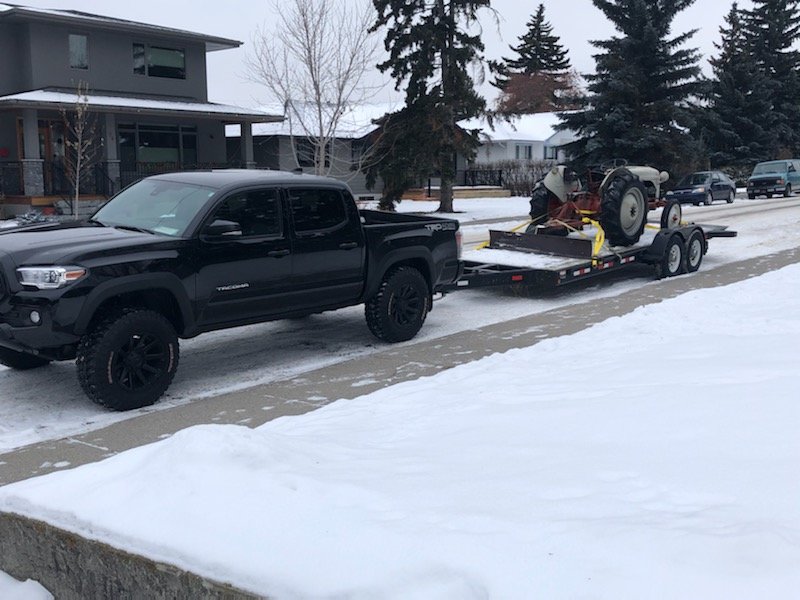

    Well I would say the trailer makes a big different. I am in no way an expert in towing. I recently had to move a 1948 ford 8N tractor from my rural property into the city. The tractor is not very heavy. 1500 -1600. But I felt the trailer was a bit much. Took it slow and easy. It was not my trailer, it is my tractor. Probably would not use that trailer again. Would want a lighter trailer for sure. 3gen Tacoma
    trying to determine if I bought and old Toyota pickup if I could tow that. Also what trailer should I try to get.
