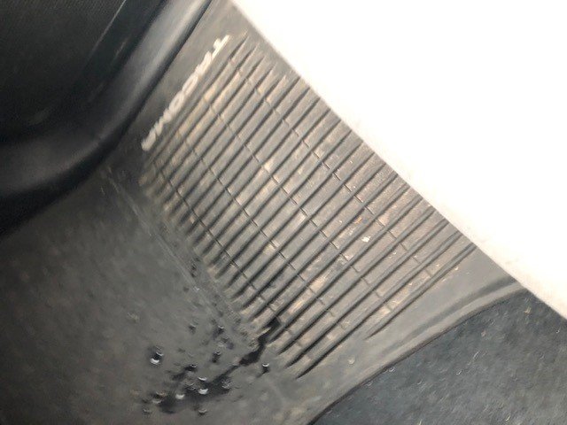

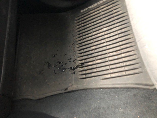

    I have a 2017 Tacoma TRD Sport in Houston, TX.
    About a month ago I noticed water occassionally dripping on passenger side floor mats. See photo. I have read every forum out there on this and none of the problems or solutions described seem to fit - see below;
    • It happens rain or shine intermittently; When it happened to day, it has not rained in a week or more but is very humid;
    • sometimes when turn hard it will drip a little more (as if running off part above);
    • The A/C Drain hose is not blocked; it drips onto ground plenty but I blew it out anyway;
    • The cabin air filter is dry as a bone when it happens;
    • The carpet is not wet, it is driping down onto rubber floormat from behind dash
    • I used a Depstech inspection camera to look behind the dash/glove box and could see moisture in a few areas but have not figured it out yet;
    • It is not from the cowling; i lifted one end and used the inspection camera there is no water underneath and the design that affected the 2nd generation that caused rain to go into air intakes is not an issue on 3rd generations.
    I have spent a lot of time trying to figure this out. Then, randomly, a 2019 TRD off-road owner walked up to me and asked if I had a problem with dripping. We compared notes and it is the same issue. He took his to dealer and they could not figure it out or re-create it.
    I wonder if anyone has any idea or if it is the seals in the evaporator case.
