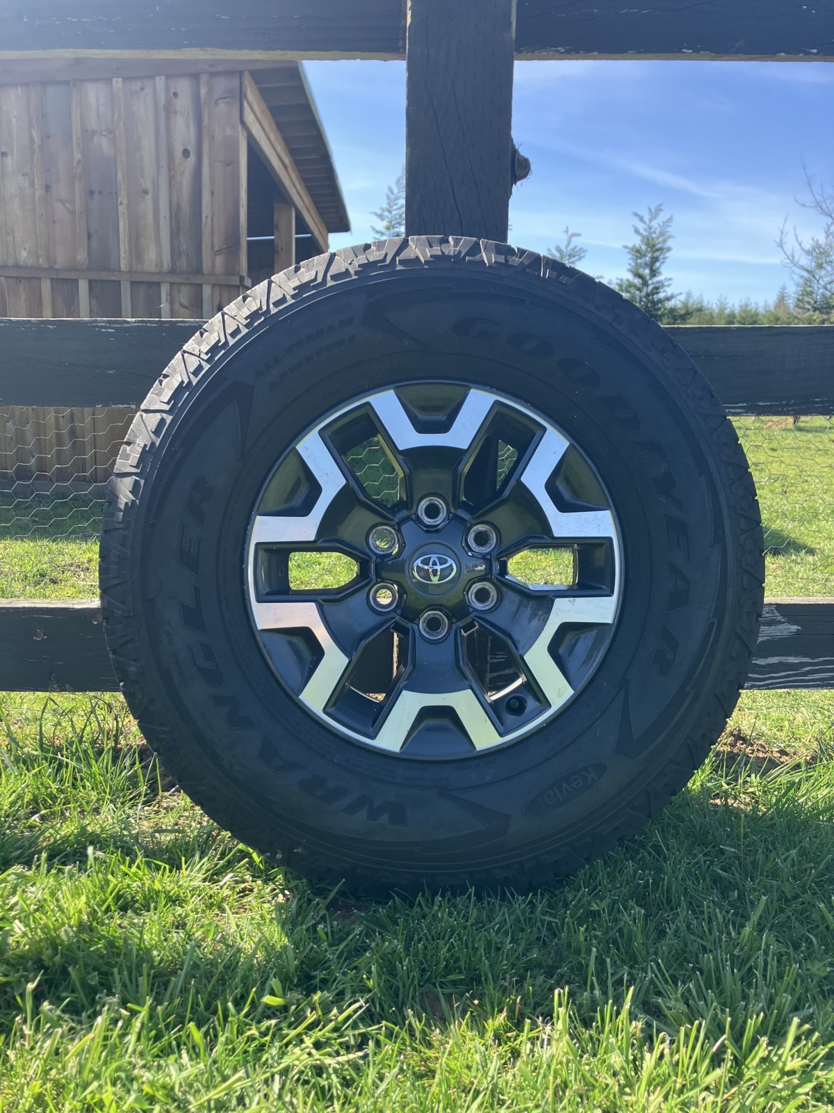

    Stock TRD wheels should fit fine. Can you post a picture of the wheels you bought. Something doesn't sound right.

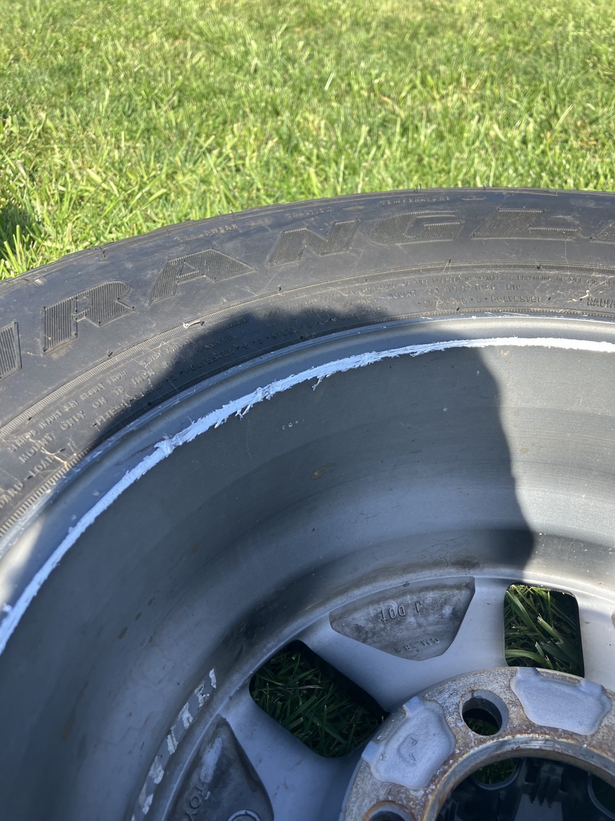

    I attached a photo of the wheels. They are off of my dad’s new Tacoma. Also attached is a photo of the groove on the inside of the wheel. This happened to both front wheels. Based on the look of the tie rod (couple of wear marks on both from rubbing) it seems the tie rod end is rubbing when turning sharp. Any help would be great, thanks for reply

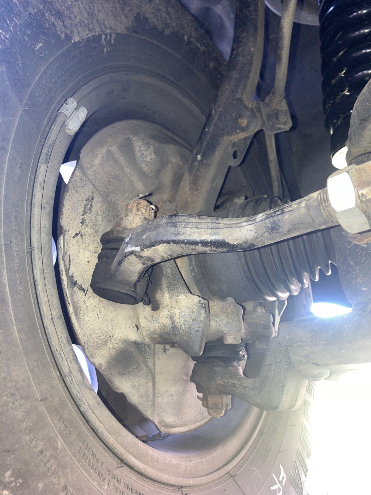

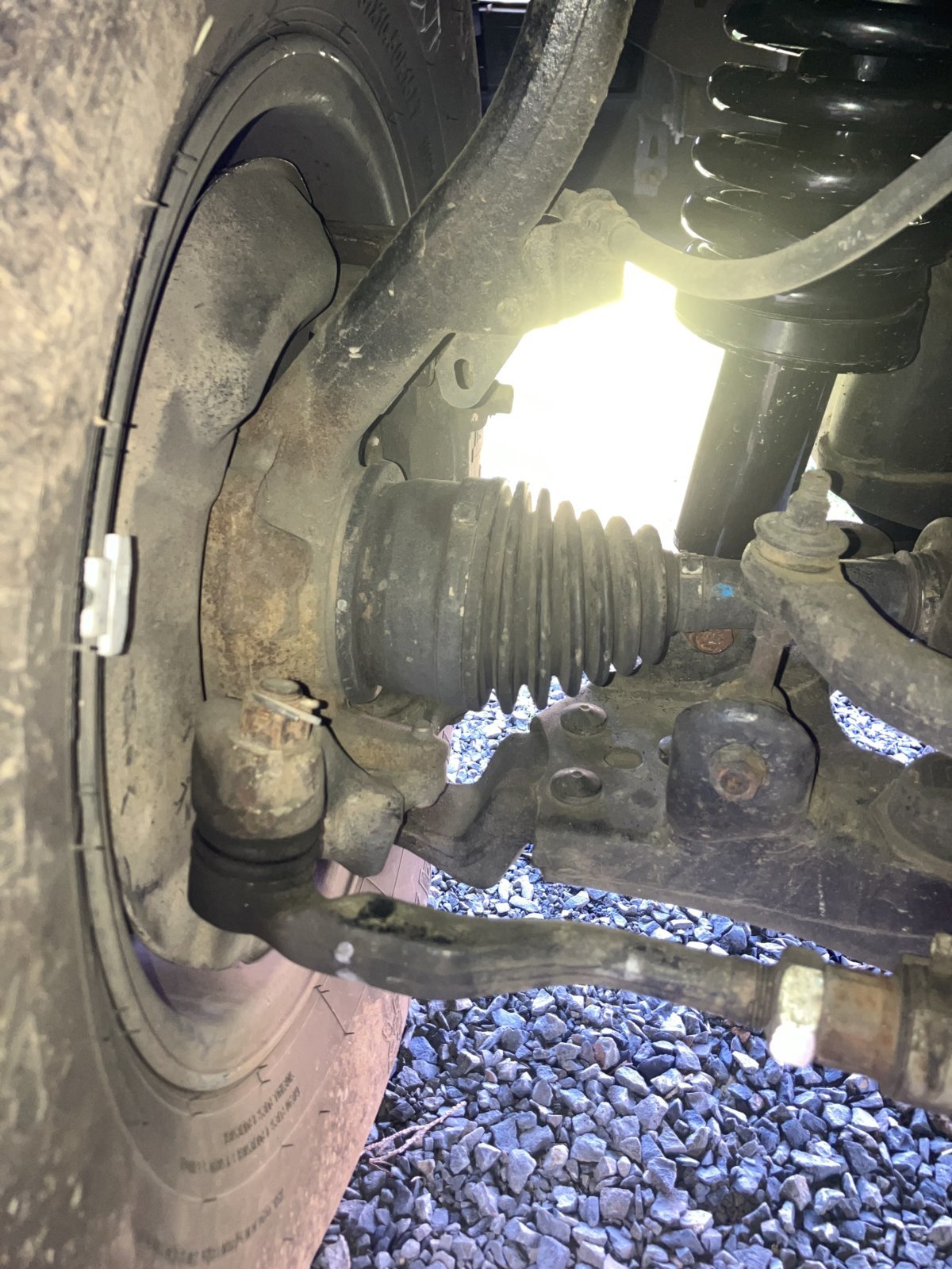

    Can you get pics of the front suspension on your taco?

    I bet your tierods are on backwards.
    The dogleg should jog towards the front.

    Oh my word you’re right. The dog leg is facing backwards on both sides. I just bought the truck about a month ago and didn’t notice this before. Thanks for the help. Is there a right and a left tie rod? Do I need to switch them? Thanks

    You could swap them left to right, but those are shitty aftermarket tie rods, and are leaking grease, so I would just buy new OEM ones and install correctly.
    You'll have to measure carefully or get an alignment afterwards.

    Alright. Is the bolt and pin supposed to be on the bottom??

    No.
    You have the left end on the right side and the right end on the left side.
