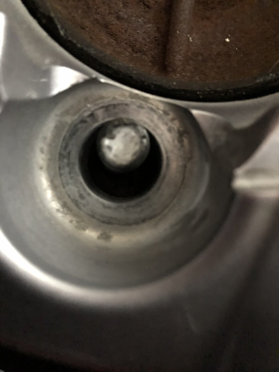

    I just picked up a set of 2019 SR5 wheels for my 2005.
    I noticed the pass though holes for the lugs are a lot larger than the lugs. Can I use my original lug nuts which taper and center the lug in the pass through?
    Thanks

    Those wheels need the mag wheel style lug nut that has a flat washer attached. If your original wheels are steel with an acorn style lug nut the answer is no, you need to buy new lug nuts.

    I always wondered why people were selling sets of tires and saying with lug nuts, until i bought my 2017 wheels for my 2014, yes you need the proper lug nuts

    The alloy lugs work fine for the steel spare.
