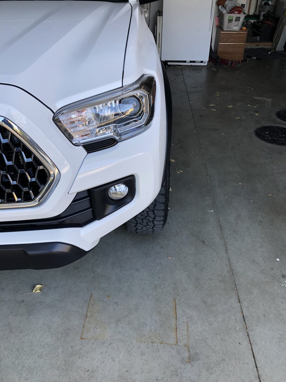

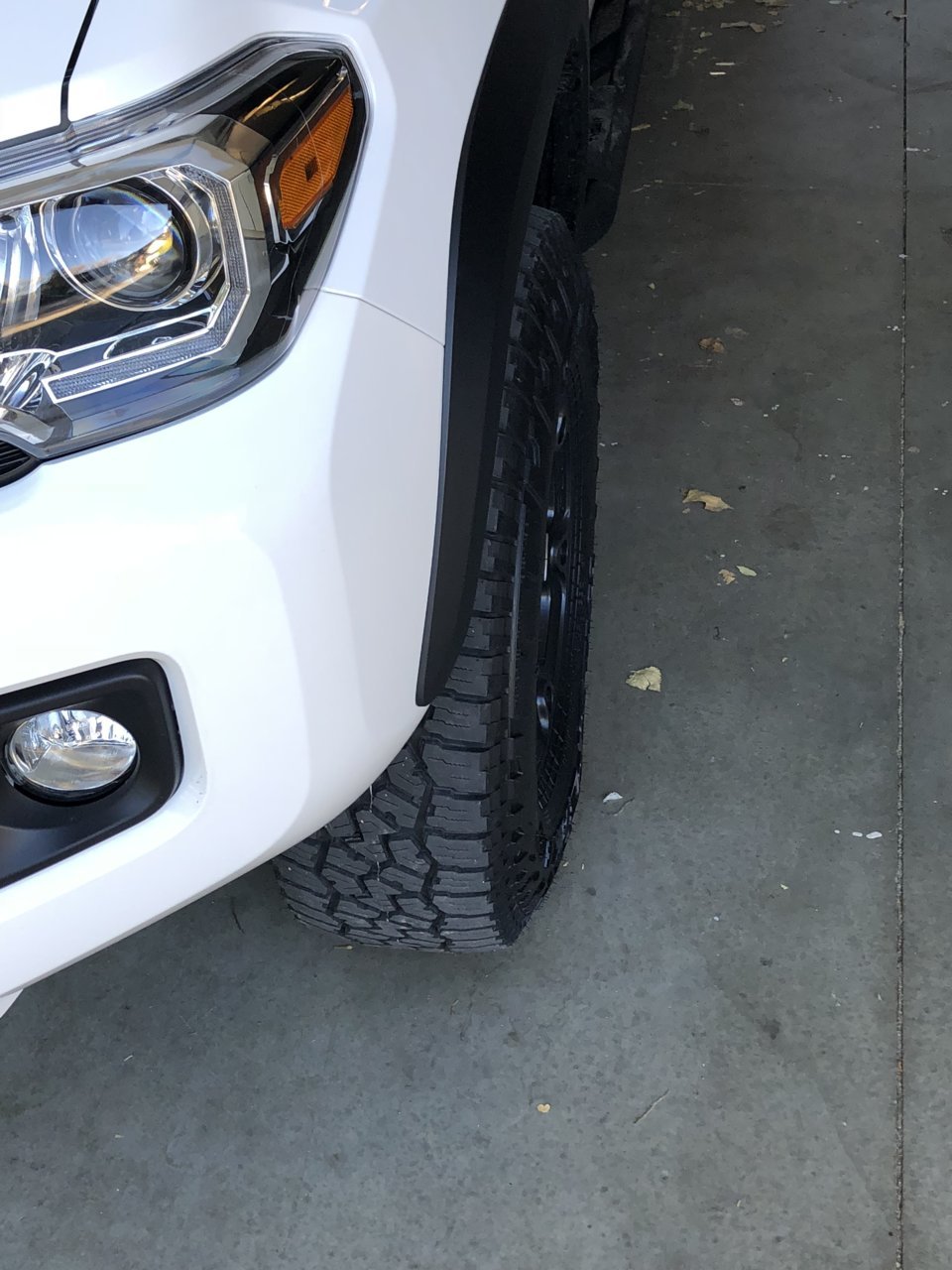

    16x8 FUEL BEAST 265 75 16 FALKEN WILDPEAK AT3 Tyger step sides 20% tint front to match factory tint bilstein 5100s on third notch PRO grill
    16x8 with 0 offset. 8.5 with 0 offset would stick out .25 inches more. Shifts the center of the wheel. Also have 265 wide tires.
