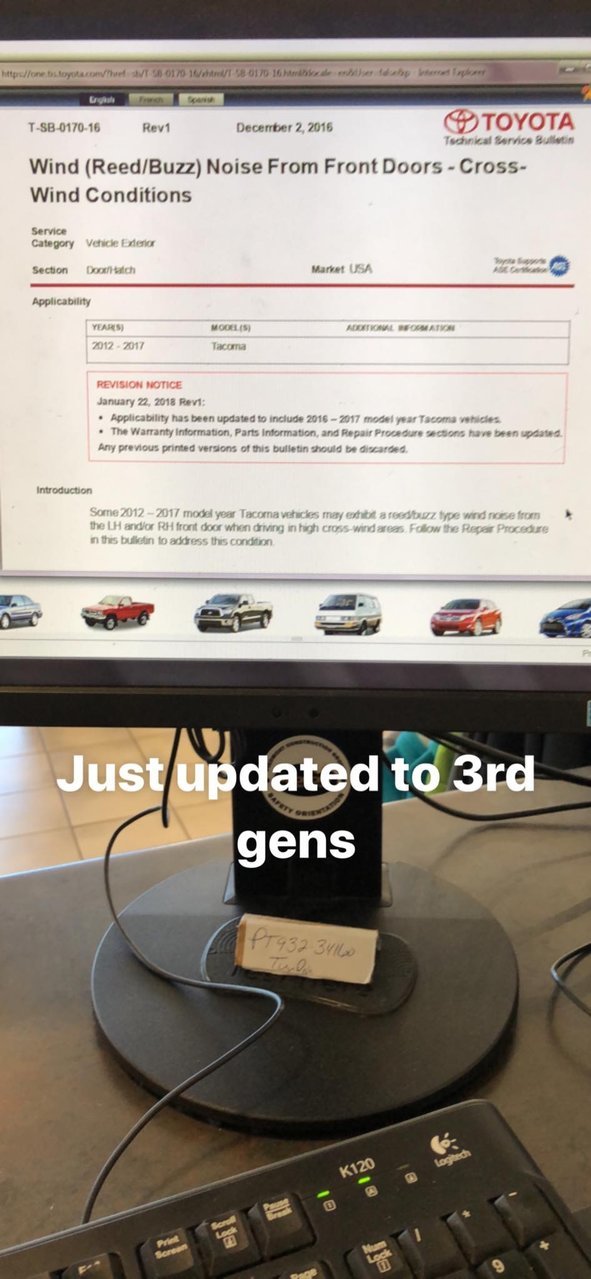

    My tacoma has been having this sound since 5k. Windows are tinted. When I presented this to the manager, he speculates that the window tinting maybe a factor.

  8. Jan 31, 2018 at 4:15 AM
    #28
    Jthizz2006
    Jthizz2006 Well-Known Member
    May 6, 2016
    #186244
    607
    Jesse
    16 black tacoma DCSB SR5 4x2
  9. Jan 31, 2018 at 11:42 AM
    #29
    stealthmode
    stealthmode Well-Known Member
    Dec 7, 2014
    #143869
    2,497
    Alberta
    2016 Short N Stubby Bed- MGM
    Front and Rear lifts Tires ECGS bushing Lots of other crap +HP sticker
    This is my next mod lol. I hope that they get the same TSB here...
    .:canada:

    I had the same issue with my 2013 TRD and now with my 2016 TRD - dealer has tried everything including plugging holes in the control arms to re sealing the windshield - they just replaced the door seals and that seemed to work so far - been a month now without any sounds

    so does the TSB just replace the door seals?

    should be getting this applied on February 5th .. Knowing my dealership they will have to order the part in and that will take weeks :p

    Last week, i took my truck to the dealer in regards to this tsb. Honestly thought my truck needed to stay for an inspection but the SA was convinced enough to let me drive the truck back and they'll simply order the parts to replace the stripping and whatever else.

    I took my Taco in for a warranty service. I mentioned wind noise. Service manager didn’t question my comment at all and order all to fix.

    What exactly did they fix
    I took my truck in for this a year ago, they replaced the seals, and on the way home kazoooooooooooo, it made no difference....I'm wondering if they have come up with a new repair since then that I may be able to go in to get my truck fixed again....or fixed correctly for that matter
