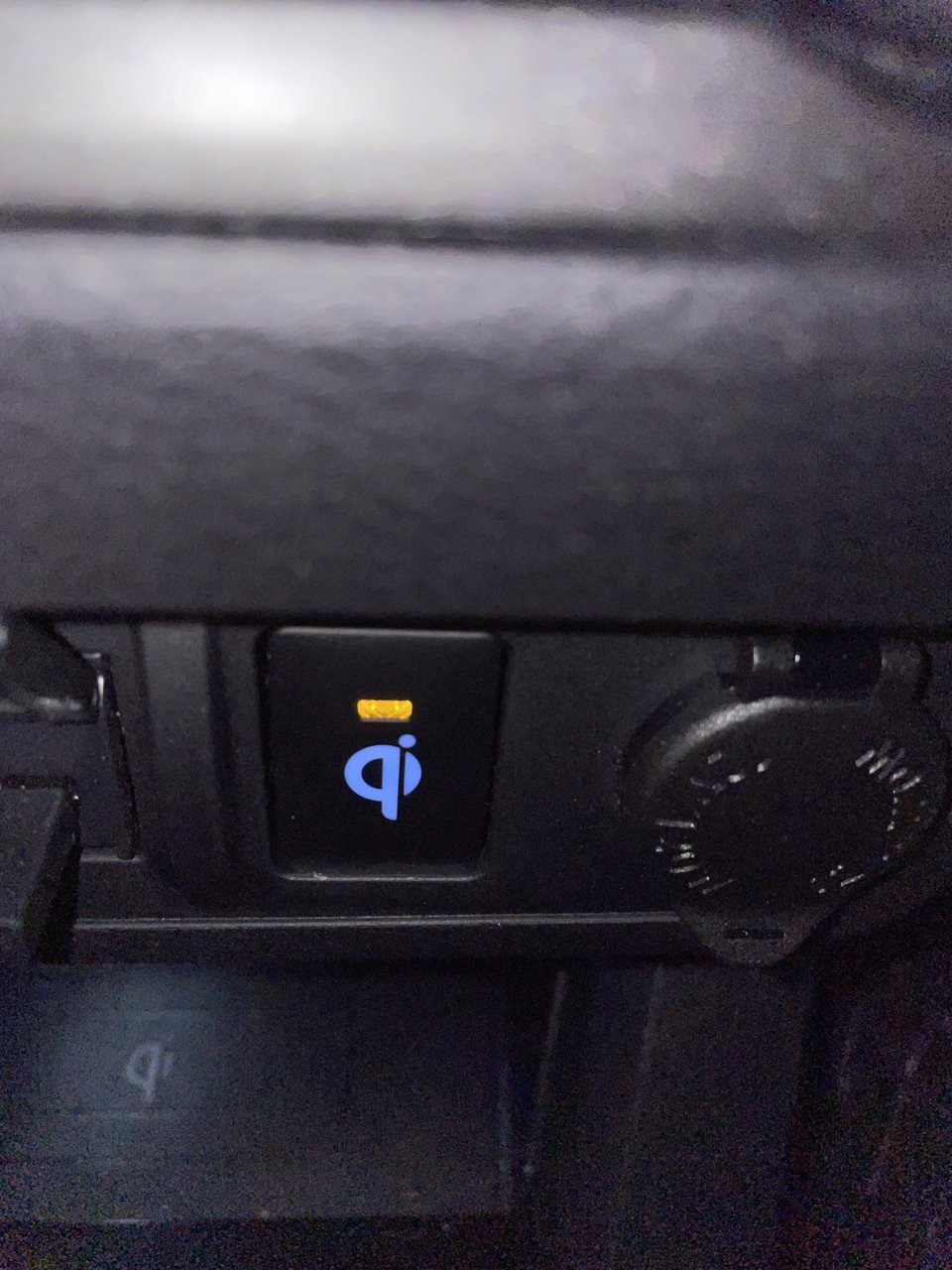

    Did you press this button
    RIX TUX likes this.

    Definitely turn on the charger power button. Placement of the phone is finicky...keep moving it until the light comes on the platform to confirm charge.
    musicisevil likes this.
