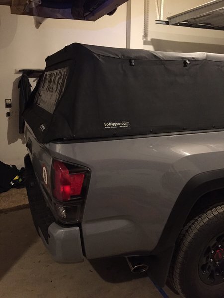

    I tried it... See pic. I opted to sell the 2nd gen and get a new 3rd gen softopper...
    2G topper cab
    2G topper tail
    I also talked to the guys at Softopper and they assured me the 3rd gen version had all new dimensions for the frame and panels. Also the back flap support bar is curved to align with the tailgate.
    Sorry I don't have a pic of the new 3rd gen topper on but it fits proper. Will update if I install it anytime again soon...

    Thankyou for the picture! Seems like that may be the only way to go.

    I ran with it for a weekend...soccer tournament w/ driving wind and pouring rain.. and it worked OK.
    But if your a Taco owner you're prob particular enough to want things fitted...

    I was in possession of both at the same time and took measurements of the frames and side panels of each. The 3rd gen softopper is in fact about 1.5" shorter and the side panels have a longer slope in the rear (lower angle). The rear window panel bar also connects to frame differently where the round bar of the 2nd gen snapped into round black clips on end of the bed runners...the 3rd gen bar has 3/8 inch flat plastic ends that slide into metal "U" slots and tethered snap closures. I preferred the 2nd gen window panel but they had to come up with something different to accommodate for the curved bar.
