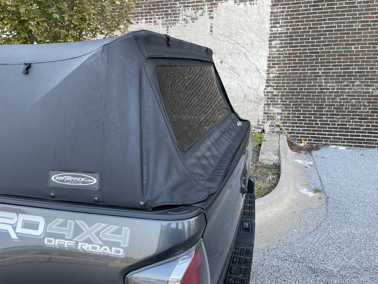

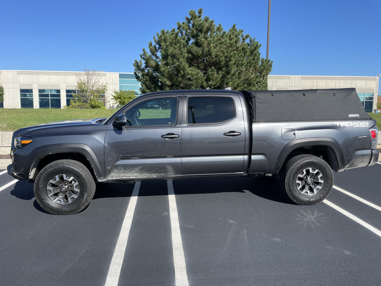

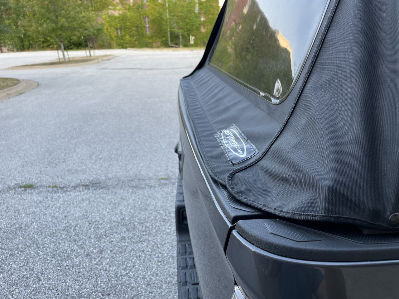

    I installed a 2nd gen ACLB Softopper on my 3rd gen DCLB yesterday. I am happy with it. The velcro on the tailgate went on the top instead of the back (painted area). That is actually better for future removal.

    Ya that definitely sits higher than the 3rd gen
