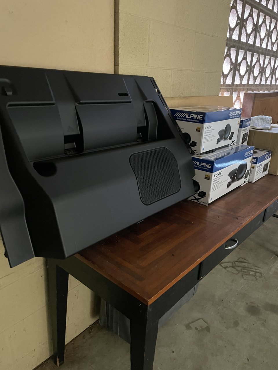

    cedric781, did you have the jbl sub? i'm asking because i have the sub so i cannot install the stealthbox. did you buy a non-jbl plastic panel or did you cut the jbl plastic panel? here's what my plastic panel looks like.
