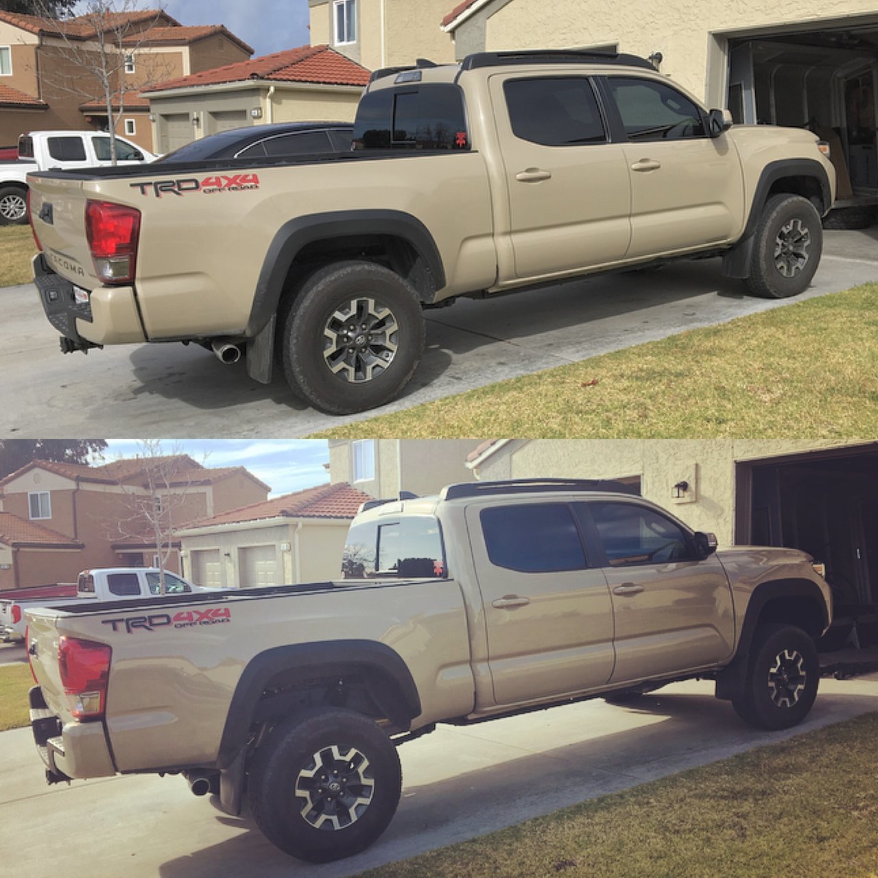

    thanks! they are 275/70r17 bfg ko2’s

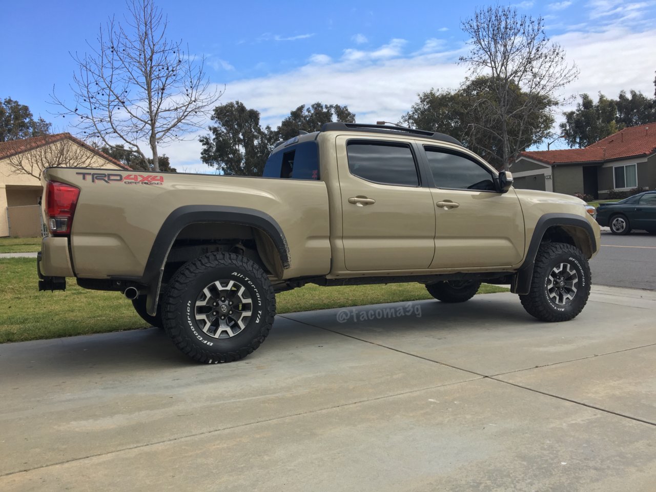

    So I'm installing the lift right now and I've come to installing and adjusting the SPC UCA ball joints. For the guys that are running 285/75's, what setting do you have yours set to? Do you need the full +4.0? Or should I try to aim for stock caster until I actually buy and install my tires?

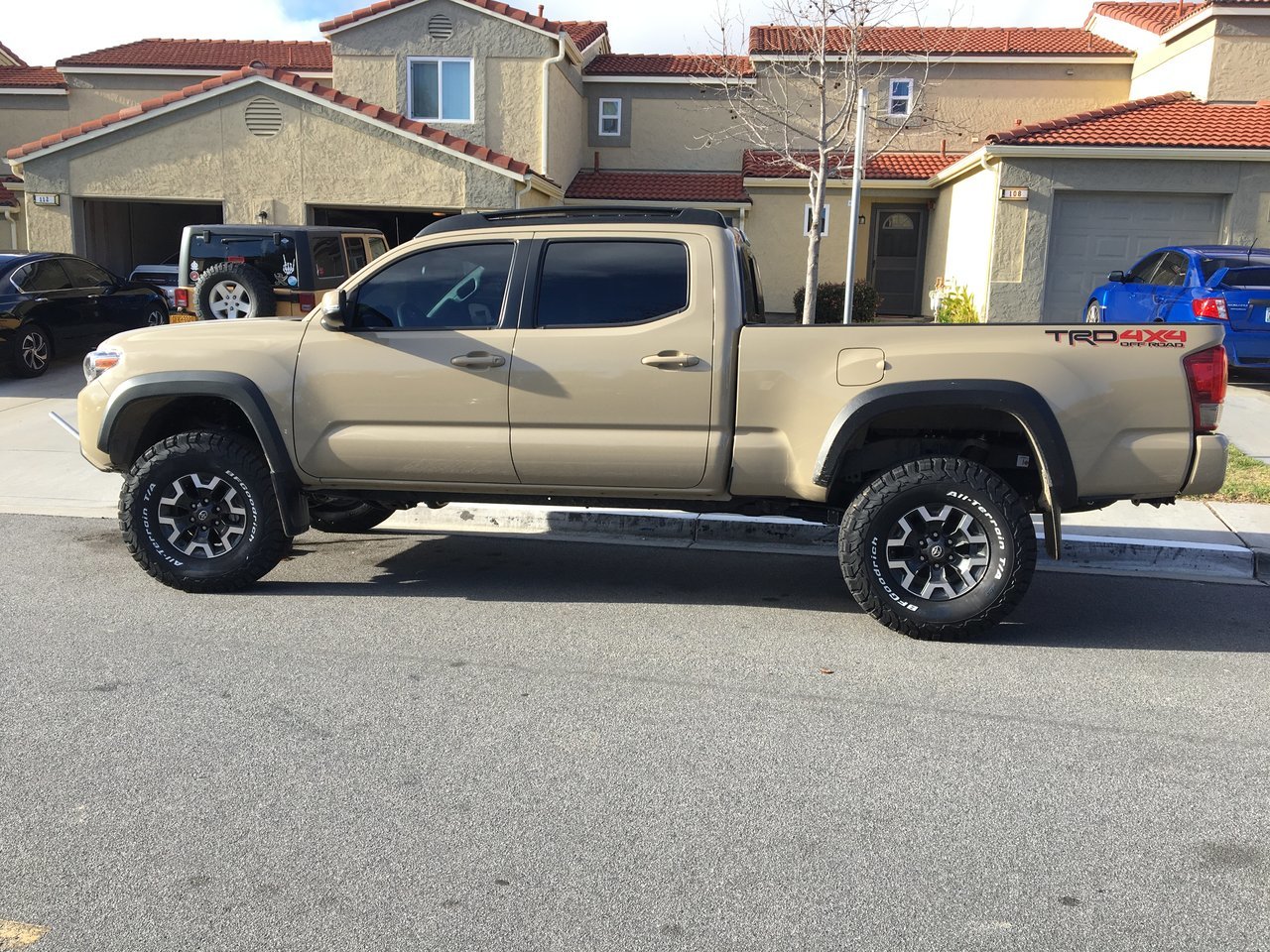

    BFG KO2 265/70r17 on stock suspension

    Here is mine. 285/75’s coming soon.

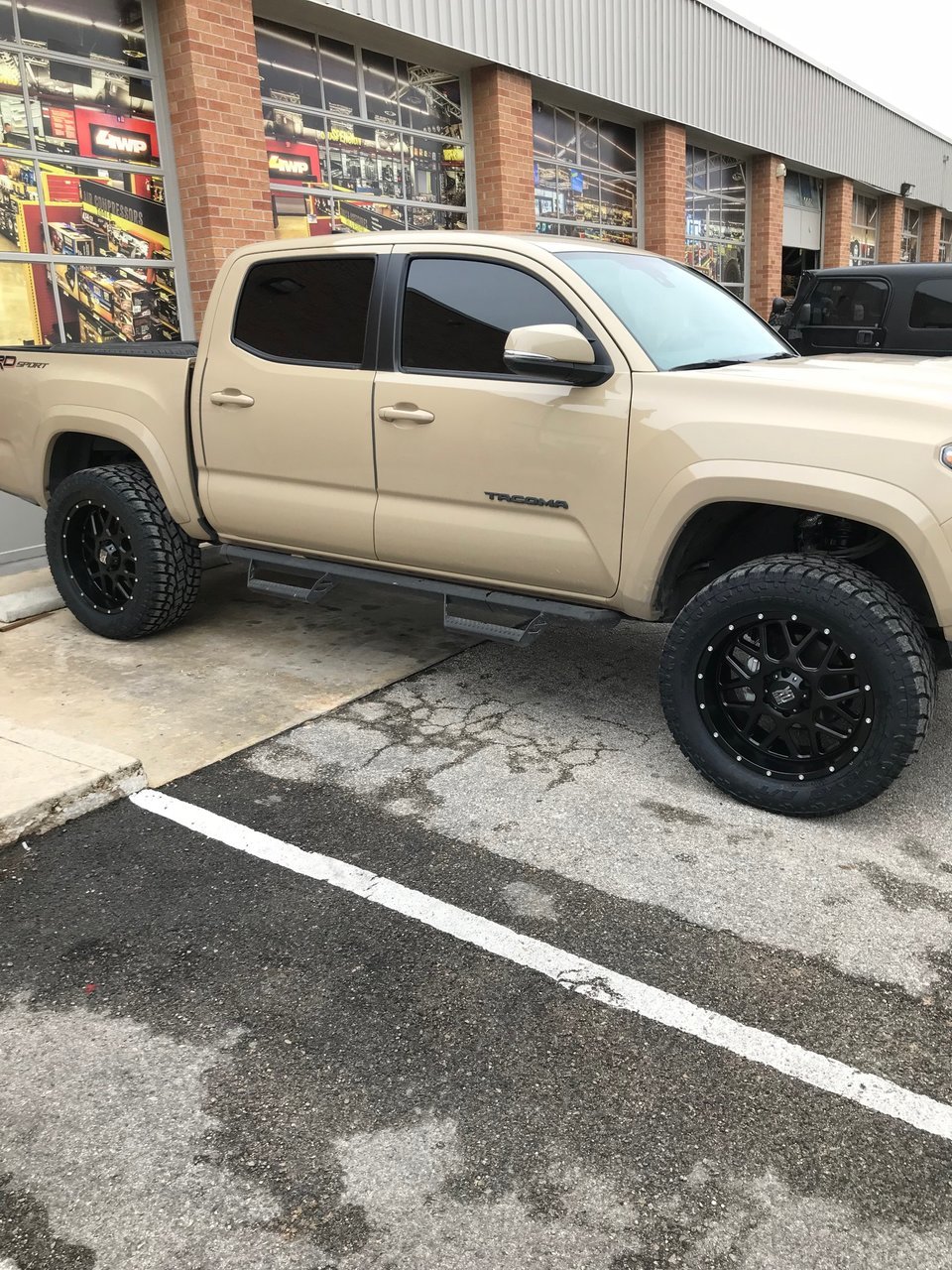

    3" lift, 20" XD grenades
    3" leveling kit with 20"rims.. not sure tire size but all together it is 33"

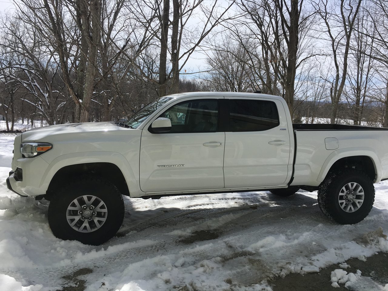

    I ran BFG KO2 275/70/16 on the stock wheels and stock suspension for a while. No issues.

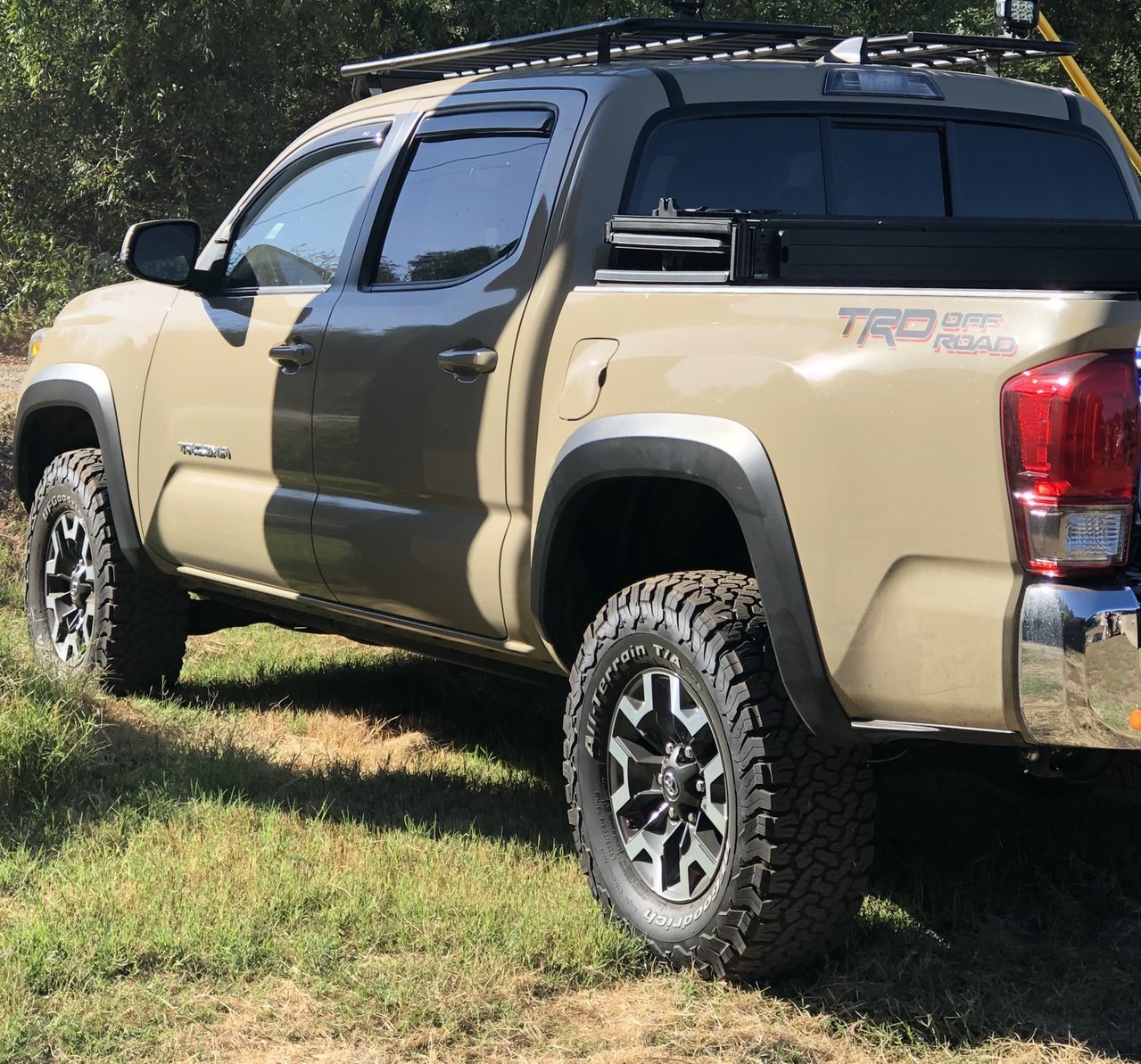

    Stock suspension with 285/75/16 BFG KO
    A little rubbing up front. Just gotta trim the fender liners.
