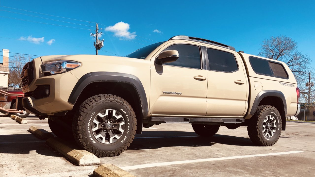

    Yep. Did mine with a fellow TW member who has done hundreds of them, right before Christmas. I wanted to wait until I got my $$ worth from the factory tires and had the parts sitting in the garage for almost 2 years.
    Total gas mileage impact was ~ .5mpg with E series KO2s, and I have no vibrations, noises, or anything else negative. Didn’t have to cut cab mounts beat on pinch welds or reshape plastic. Truck aligned fine with OEM control arms, no spacers/ shims needed, and I retained my mud flaps. Bilstein 5100s, OME 885s with a 1/4” Steel spacer on the driver’s side, and a beefy single AAL from SD Springs. Also got 5 of the tires and a matching 5th wheel to match.
    It is amazing what people will go through for an additional inch. This is perfect to me. I call it my old man lift, but I do think I’ve grown a bit wiser in my years.

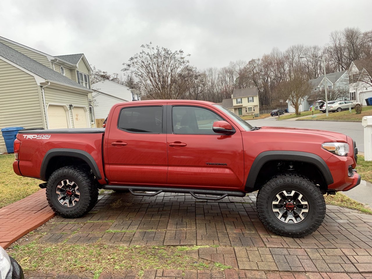

    Fox 2.0 Front Lift 2.5 inches
    1 1/2” Rear Block
    285/75-16 DuraTracs
    1 1/2” SpiderTrax Wheel Spacers
