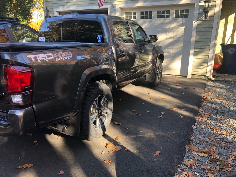

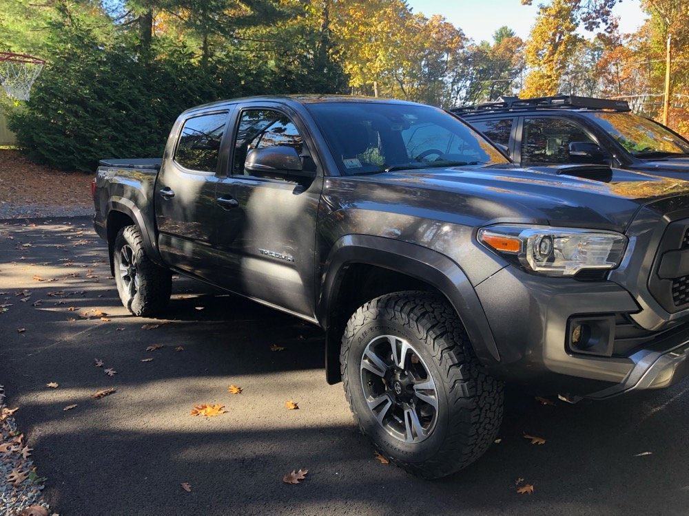

    I've been following this thread. Very helpful to see what others have done. I couldn't decide on wheels and was liking the factory TRD sport - at least for now.
    Just got BFG KO2 265/70/17s on stock setup. Doing my research on options for some slight lift.

    You really cant beat the Bilstein 5100 Lift for value. Much bigger, better shocks than the Hitachi's. You could go 1" -2" up front and still have smoother ride than what the stock Hitachis provide.
    Good luck Jack

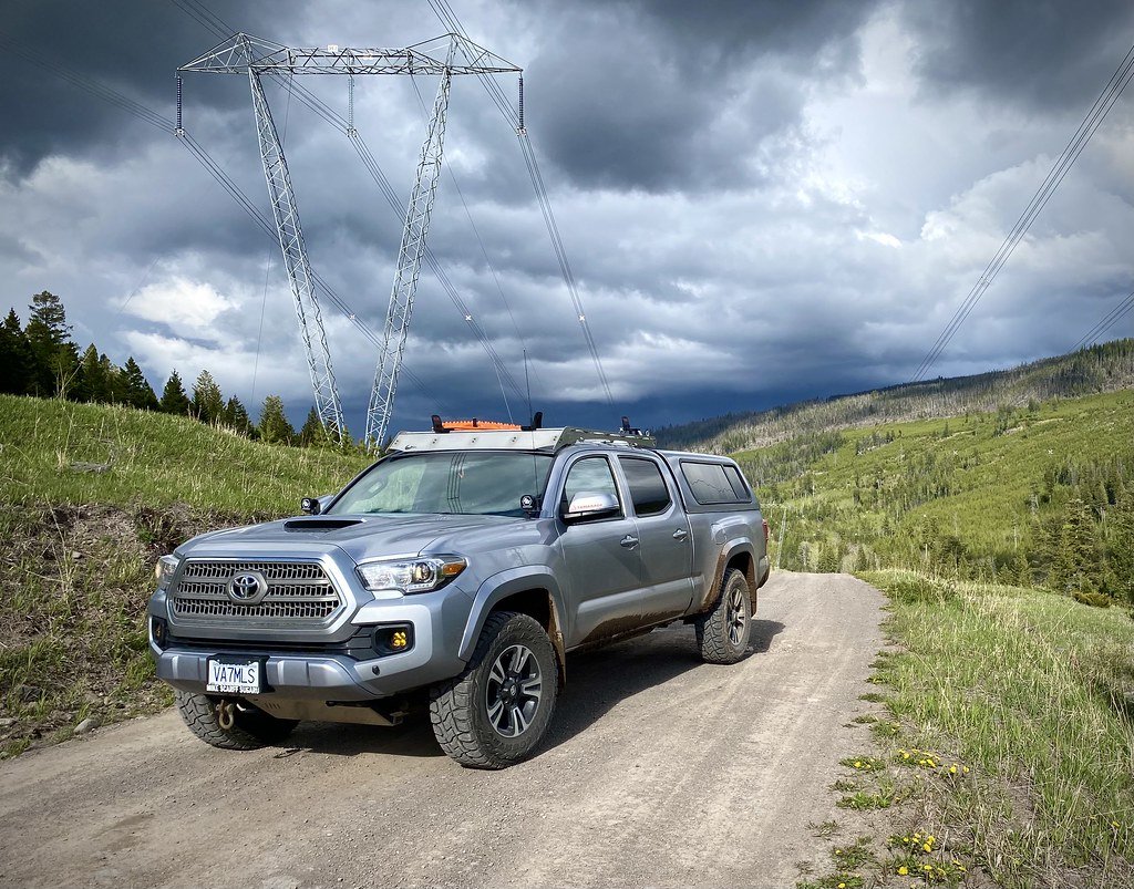

    265/70r17 Toyo RT.

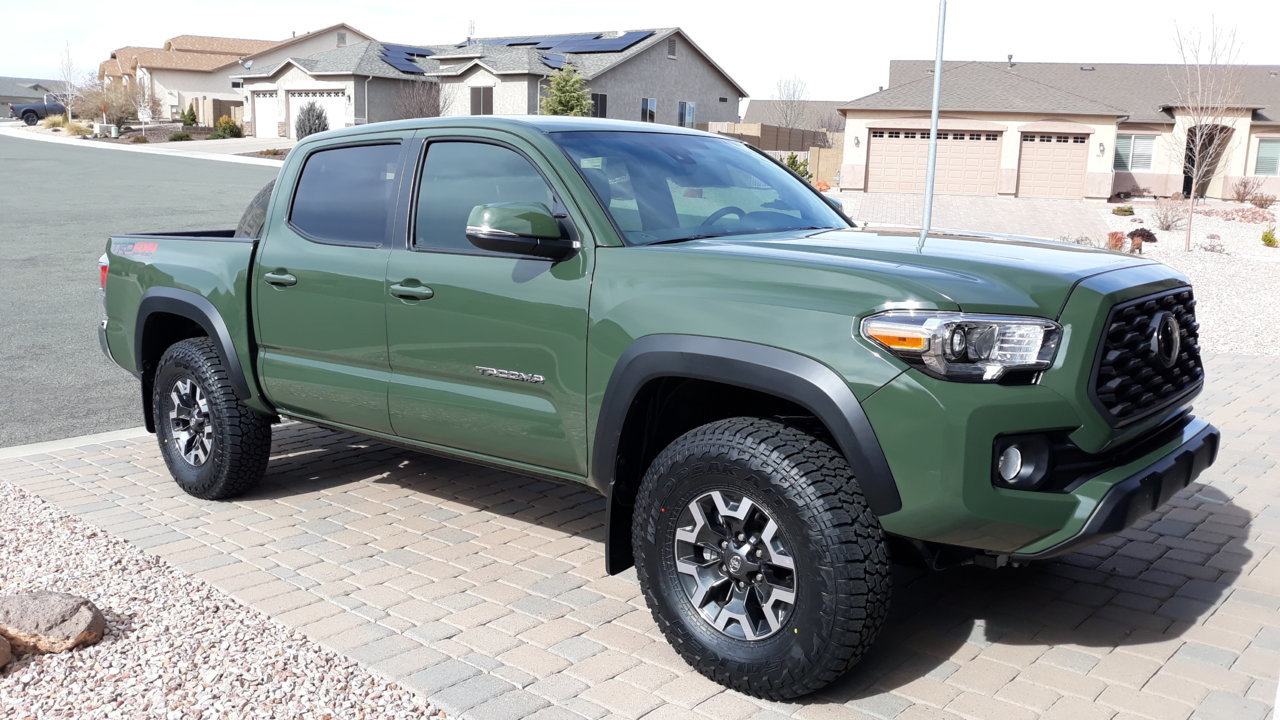

    265x75x16 Falcon Wildpeak, no lift yet. Planning on Eibach pro 2.0 coilovers

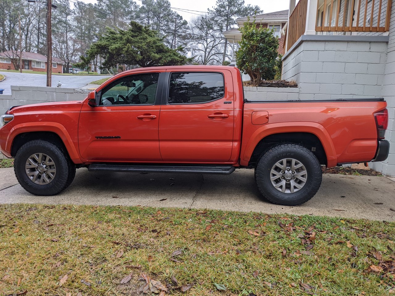

    Toyo OC AT3. 265/75 16. Stock suspension.

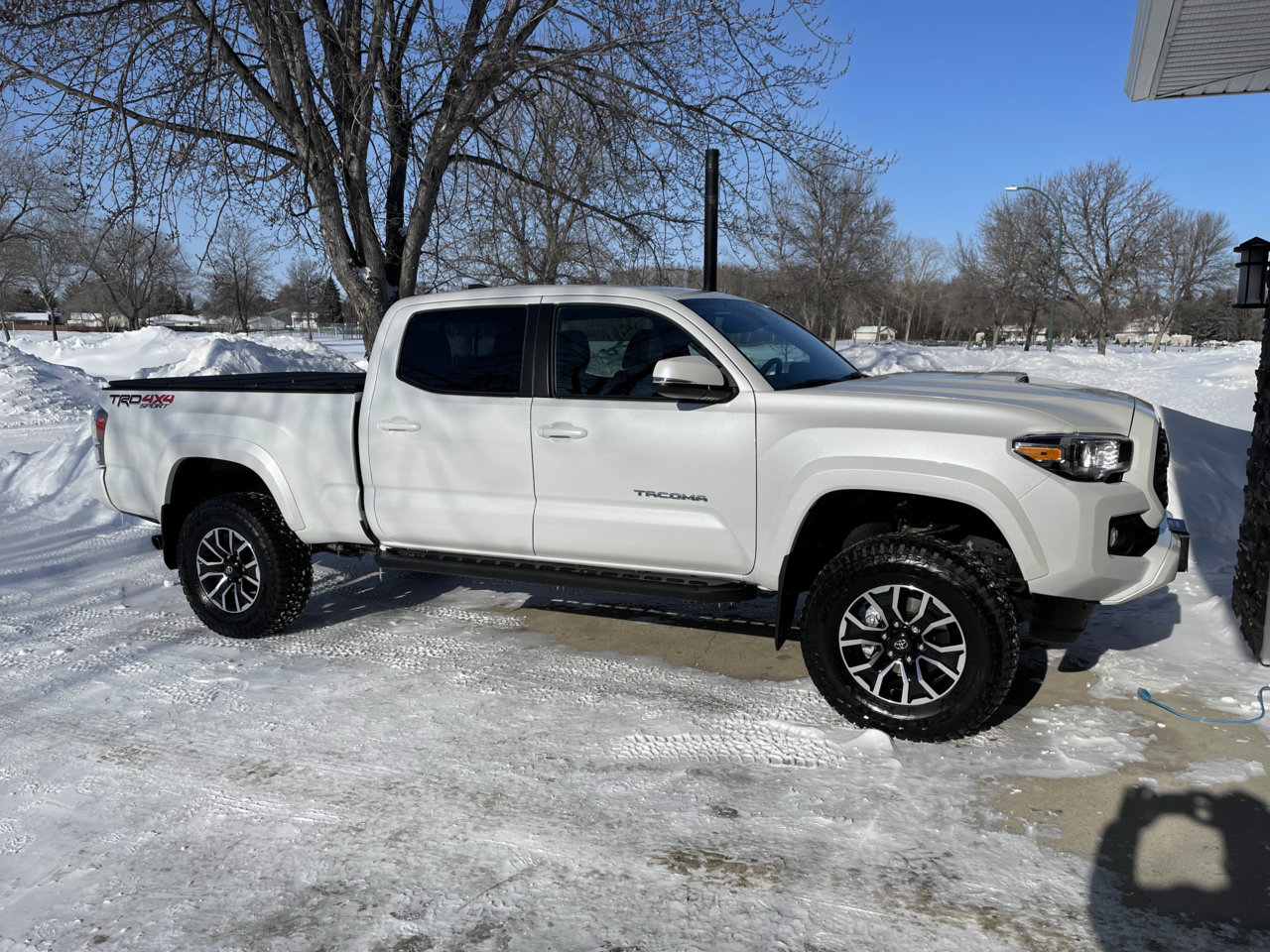

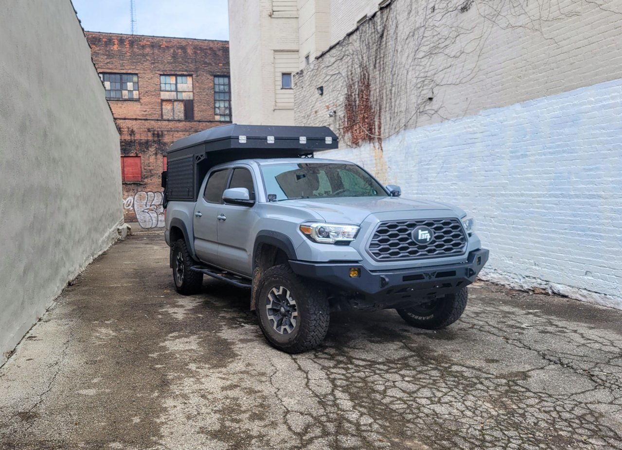

    3"/2" Readylift SST with Falken Wildpeak 265 70R17

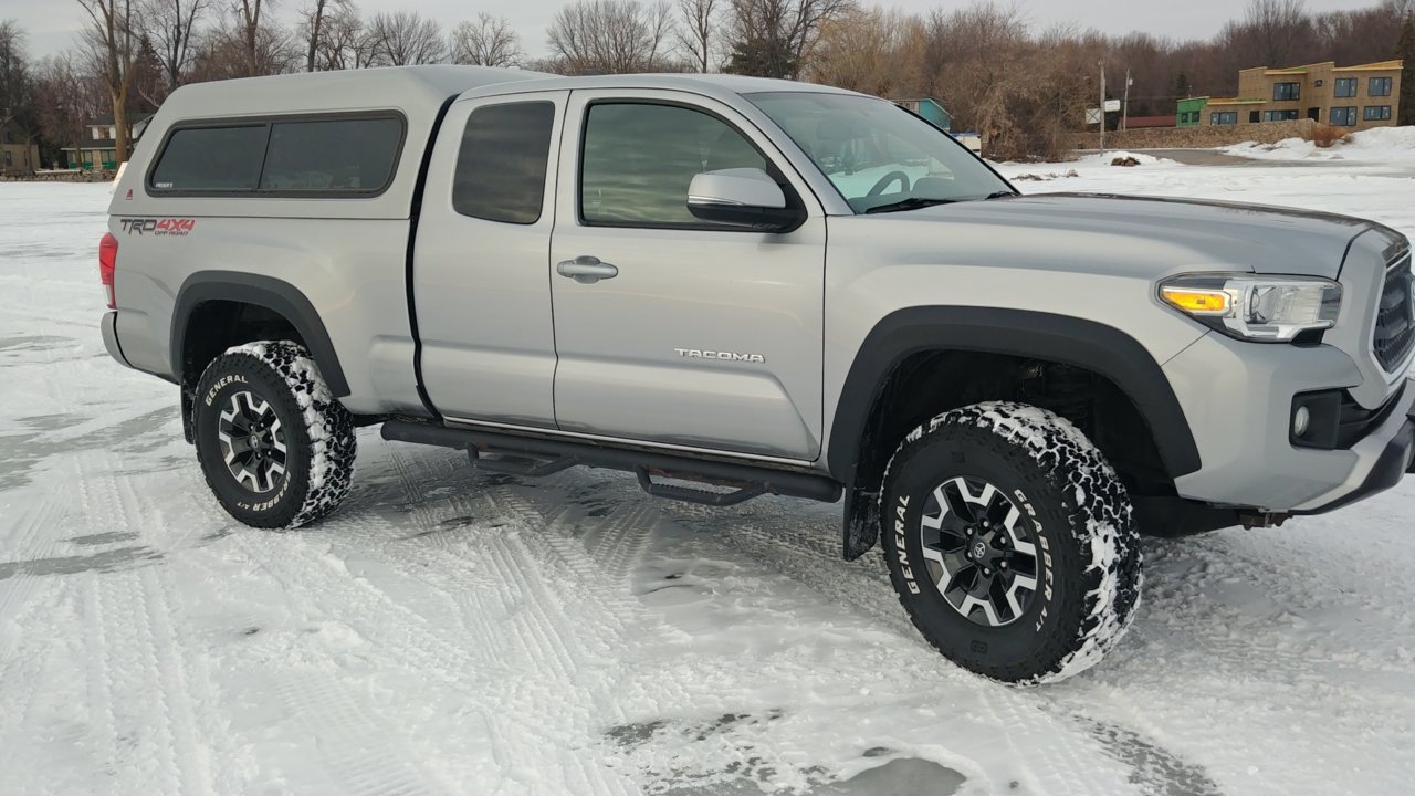

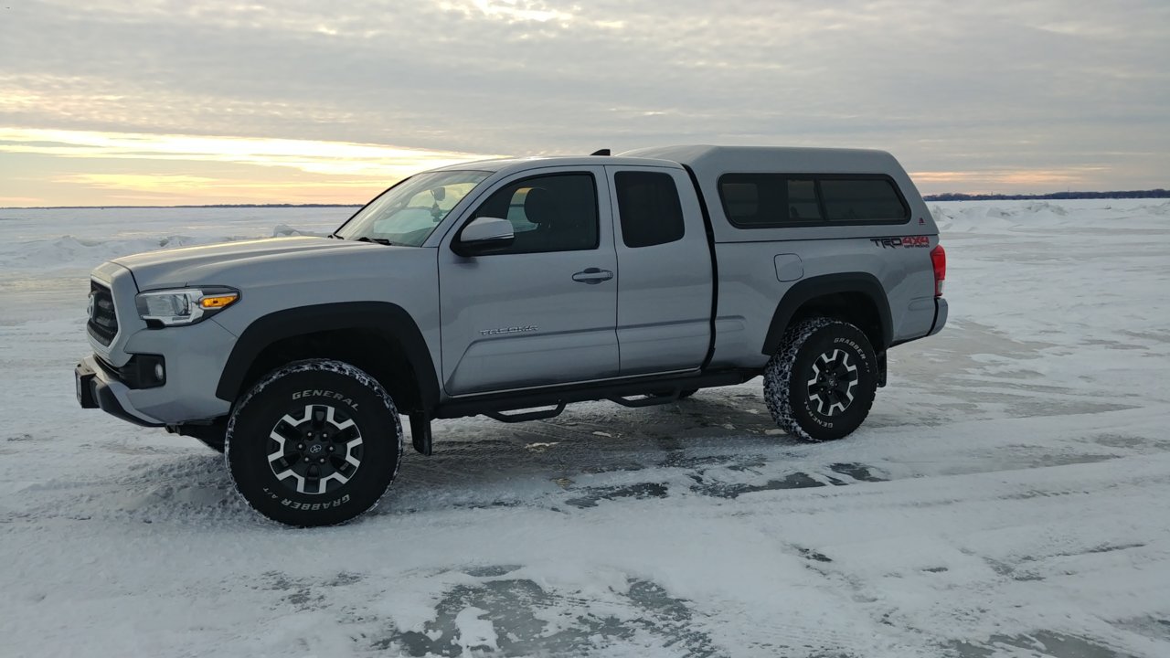

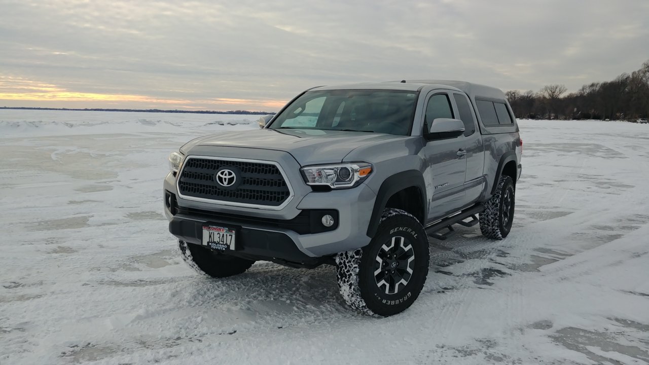

    Small lift, slightly oversized tires, well...
    365/75/16, 3"/2" lift, 1" spacers Grabber A/Tx

    this is amazing bro ... can u tell me more? any rub? any more picture!!?? got an IG? How are the tires -wear, snow, rain? thanks!

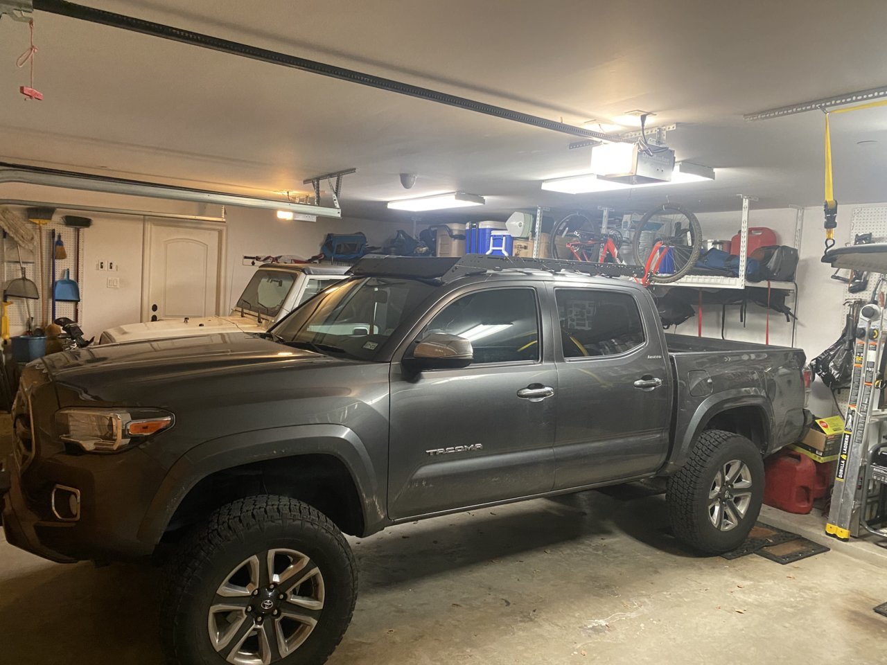

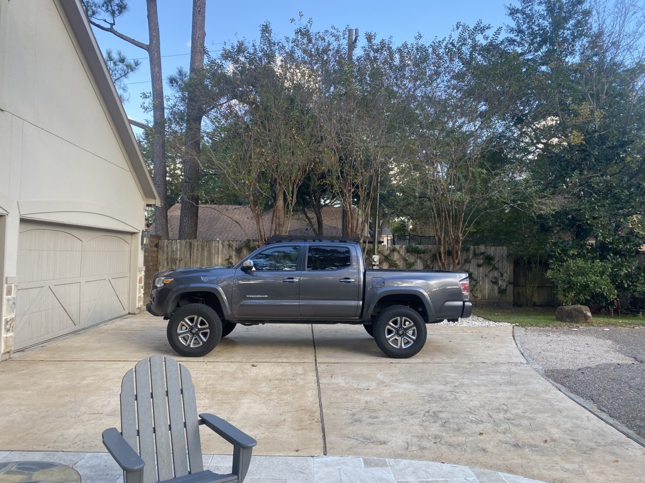

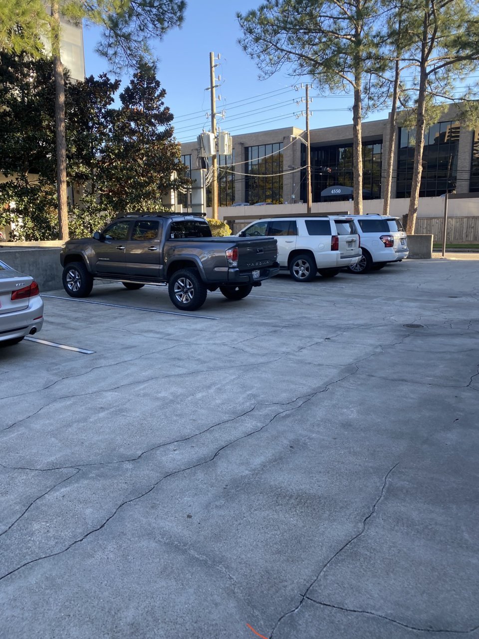

    4” maxtrac spindle lift, 295/70r18 nittos,
    So currently I have a 2017 Tacoma limited with a 5” maxtrac lift on 285/70r18 (34”) nitto terra grappler G2’s. The tires don’t rub at all on the lift, and I kept the stock chrome limited wheels because they look super badass. I had to throw a Toytec 0.5” taco lean spacer on the front driver side, and had to throw on 1.25” hubcentric wheel spacers. Pulled the trigger on some dobinson L59-112-r heavy duty leaf springs which are going on in early January to raise the rear 3-3.5” because I wore out the other springs and it’s 1” low in the rear currently. Can’t wait to see what rake feels like again! Let me know what you think.
