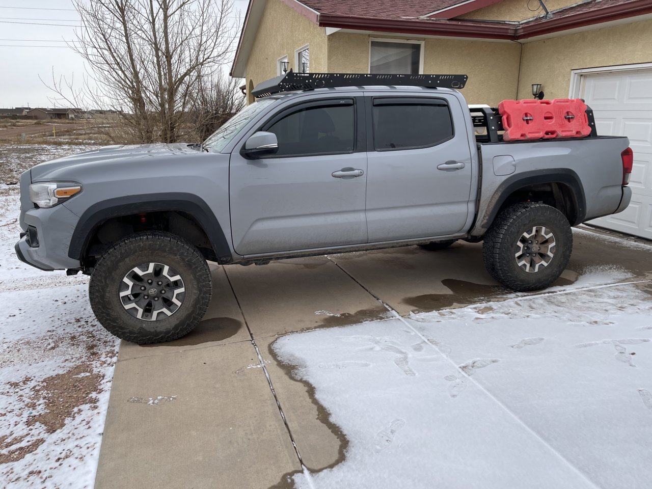

    285/75/16 Falken wild peaks on stock wheels with spc upcs and toytec boss lift. Need to get them black wheels though lol

    man I miss and love these wheels on this truck -I wish they would have made some/them with a better offset
    spacers though, right? if not, got a pic of the upper control arm rubbing your tire? :p

    @gattoka yeah. On 1.25 inch Spydertrax

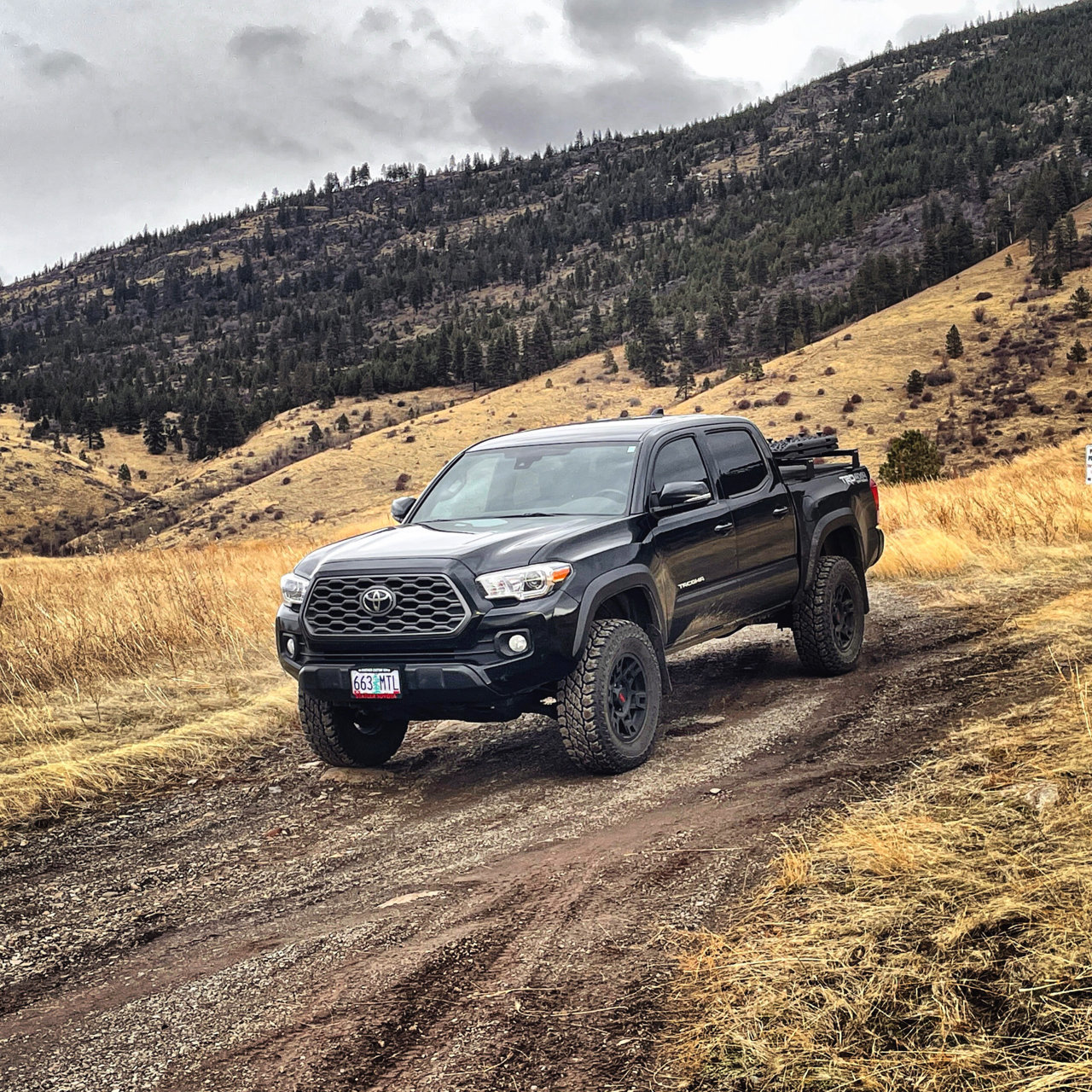

    3.5 lift, 315/75-16, DIY hybrid front bumper, skids, sliders, ditch lights, hood struts, tailgate lock, bed rack, custom exhaust, horn meant for an actual truck, neoprene seat covers
    315/75-16 on stock OR as well as same rims I spray bombed satin black. Lift is 3"front/2.5" rear20220114_094219.jpg 20220511_063346 smaller.jpg

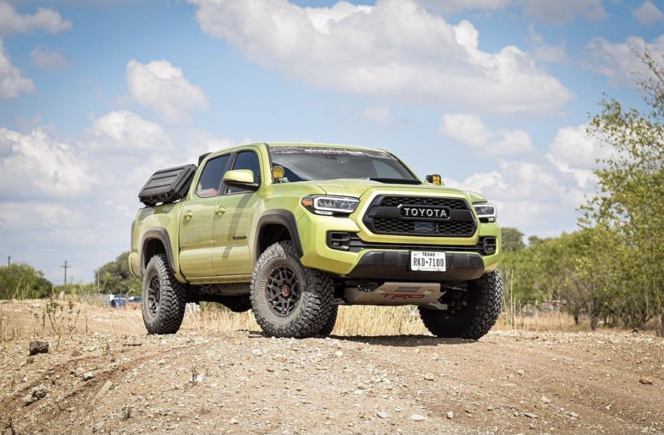

    No re-gear, rubbing or cutting whatsoever -im even still using rekgen mudflaps...its definitely the big perk of pizza cutter... some mpg will be lost -i went from 20 to 18 at 40psi -u should get slightly better bc ur pro wheels are tucked in .5" more than mine.. u will need an alignment too (caster pushed up) ... if you go past 33" you will def want a rear gear imo .... honestly is makes the truck drive better/normal -less annoying trans shifting all over the place. I have to get E-rated out here -so whatever I get will weigh more.... Additionally, often people dont even have to lift the truck with pizza cutters.... as far as wear -i mean not really -I wouldn't worry about that personally -I imagine brakes might wear a little more -but frankly my mind would be blown if you even notice anything wearing faster than it should -if thats a concern you can always look to see what others say .... this dude (see pictures below) has pizza cutters with ur wheels -for reference ... his tires, and all the other brands in pizza cutter size, are slightly taller but slightly skinnier -which is why I went with the cooper. I didn't want the tread width or section width to be less than stock, and i think it looks better ....i will mention I've seen the geolander tires with 0 offset, or better, wheels and no lift -and it looked super dope .... the overall look will just depend on lift and wheel offset ... and thanks dude -i appreciate it!

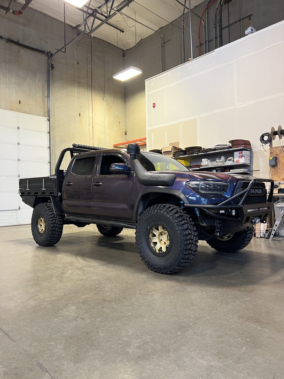

    Cooper 37's Black Rhino Bead Lock's Twin locked Kings Mits Alloy
    got king 2.5 with Deaver springs running 37's now

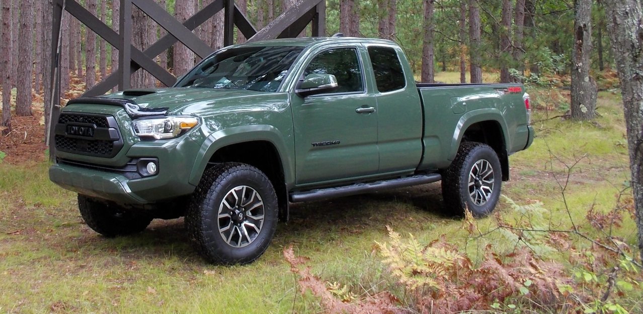

    '22 TRD Sport AC MT Army Green
    TRD lift, Exhaust & CAI
    TRD factory lift and one size taller than stock 265/70r17 Nitto terra grappler tires on stock 17" sport rims

    Looks good, what shop put the 315s? And how does it ride?
