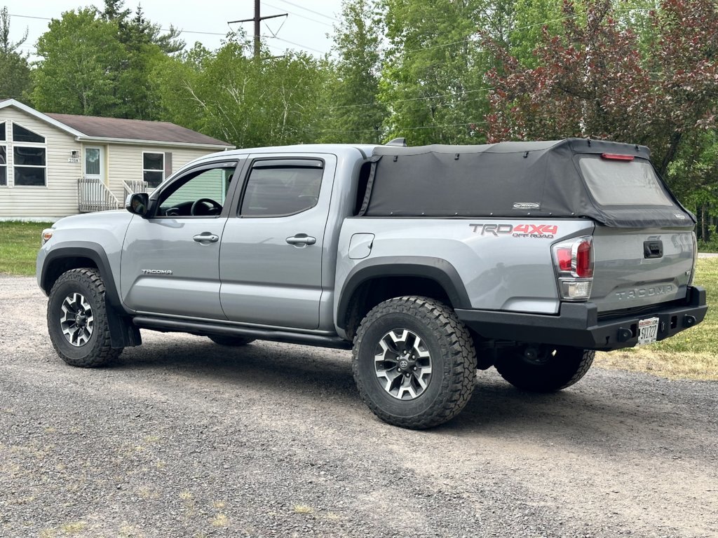

    2020 TRDOR DCSB Cement 6MT
    33's, Sliders, Skid Plates, Softopper, ATH rear bumper
    255/85R16, no lift.

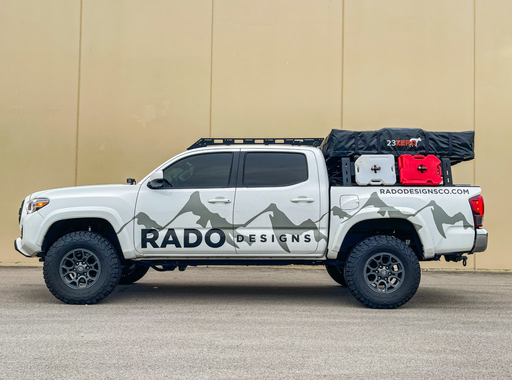

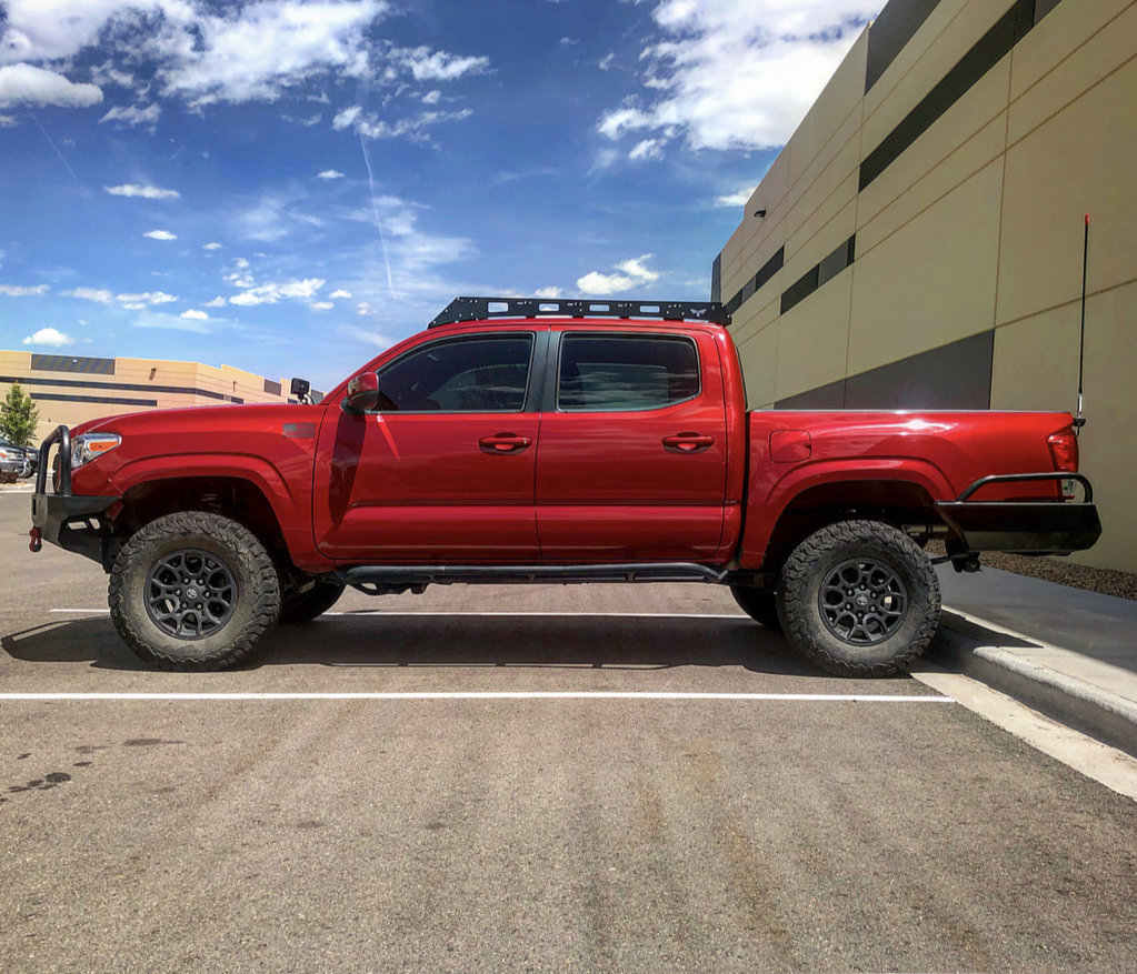

    265/75/r16 on both 3rd gen’s.
    Both with 3” lifts
    Stock wheels
