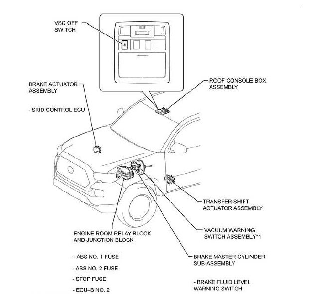

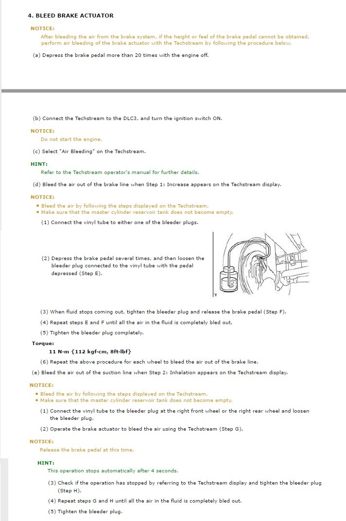

    Been searching around for this bleed ABS Actuator process, does anyone have anymore info or a video showing this? I have techstream and would like to attempt it. My brakes never felt the same after disconnecting my two rear drums to pull axles out when doing my re gear. I’ve bled the lines the traditional way many many times. I’m wondering if air might have travelled up to the abs actuator and got trapped inside.
    Where is the abs locator located on the vehicle? Is there an actual bleed valve on the unit itself? Or just bleeding at the wheels following along on Techstream? Anyone whose done this process before care to chime in? 2019 DCSB SR5 V6 AT.

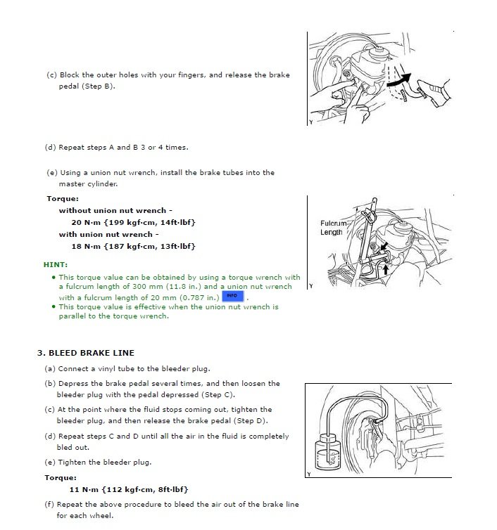

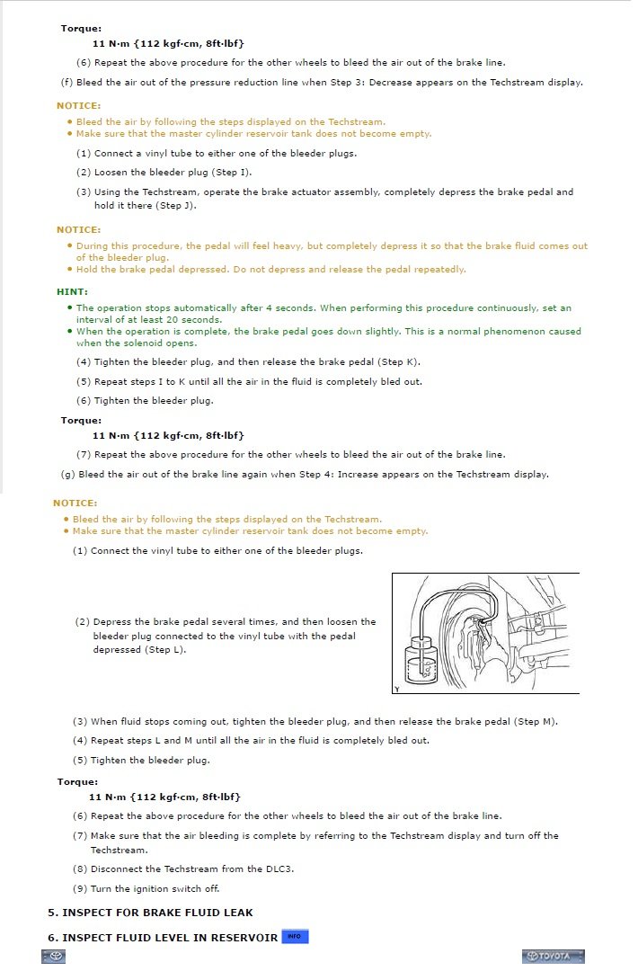

    Of course... was just curious if anyone has done it wanted to share their experiences or problems they encountered during the process. Any reason the directions repeat what looks like the same wording and steps multiple times over? Just for each wheel maybe.

    Just performed the Techstream brake bleed process and got a few more air bubbles out of my system. Took three people tho as my TS is on my desktop in the garage. I use a 25ft active usb extension cable to the truck. Had wife on TS, neighbor in the cab on brake, and myself opening and closing bleeders. Took us about 15 minutes. Not too bad.
