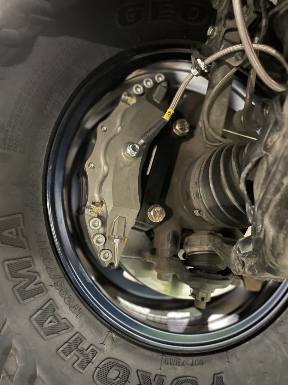

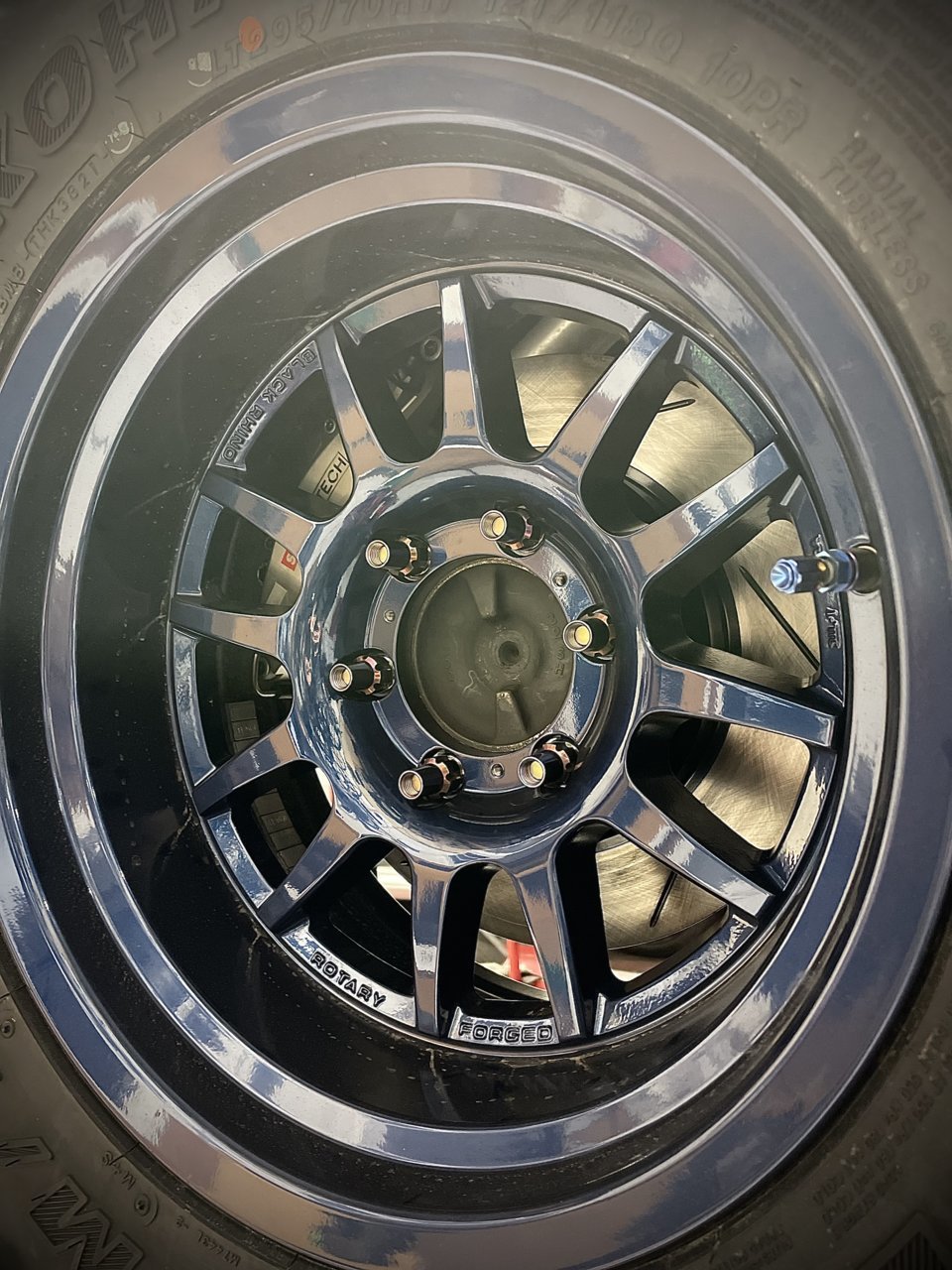

    Agree 100%. Did the stoptech front and rear rotor calipers. Had the shop bleed the brakes the traditional way and it’s enough to get home but downright dangerous. Will be taking it to the dealer today. It just sucks that this is what is required to get it done properly.
