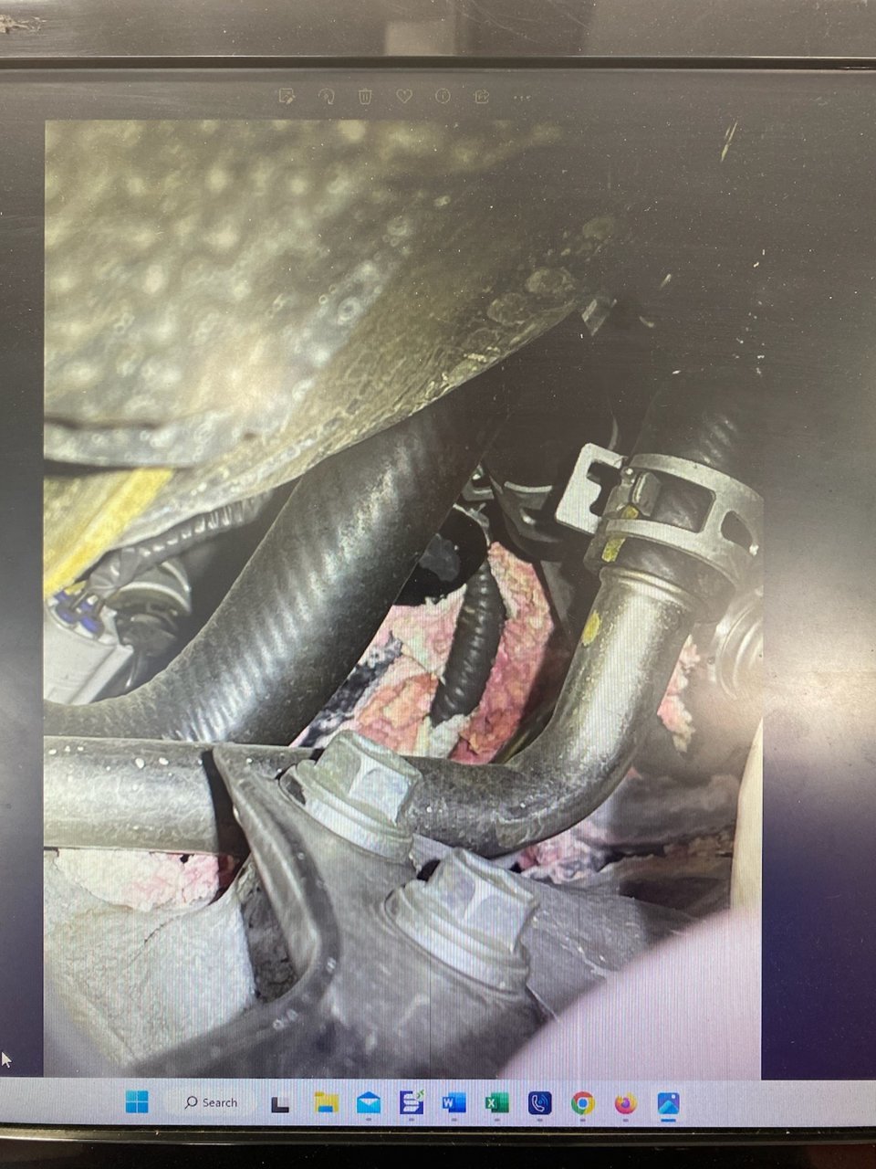

    Thanks! 17000 wow, The way to tell if it is the rear joint leak is if you go to the front passengers side door look up under at the rear of the engine atop the trans and there may be coolant crusted where the wire harness is, It may be as a seep the beginning.

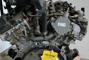

    Just lay down under the passenger side, shine a flashlight up follow the catalytic converter, above the bellhousing there will be that black plastic piece.
    Seems always the passenger side leaks.

    There's your problem... Your oil turned into pebbles, look at the floor.

    Picture was grabbed off ebay, someone selling a junkyard motor.
    The bottom bolts can be the real bitch to get if you are working from the top.
