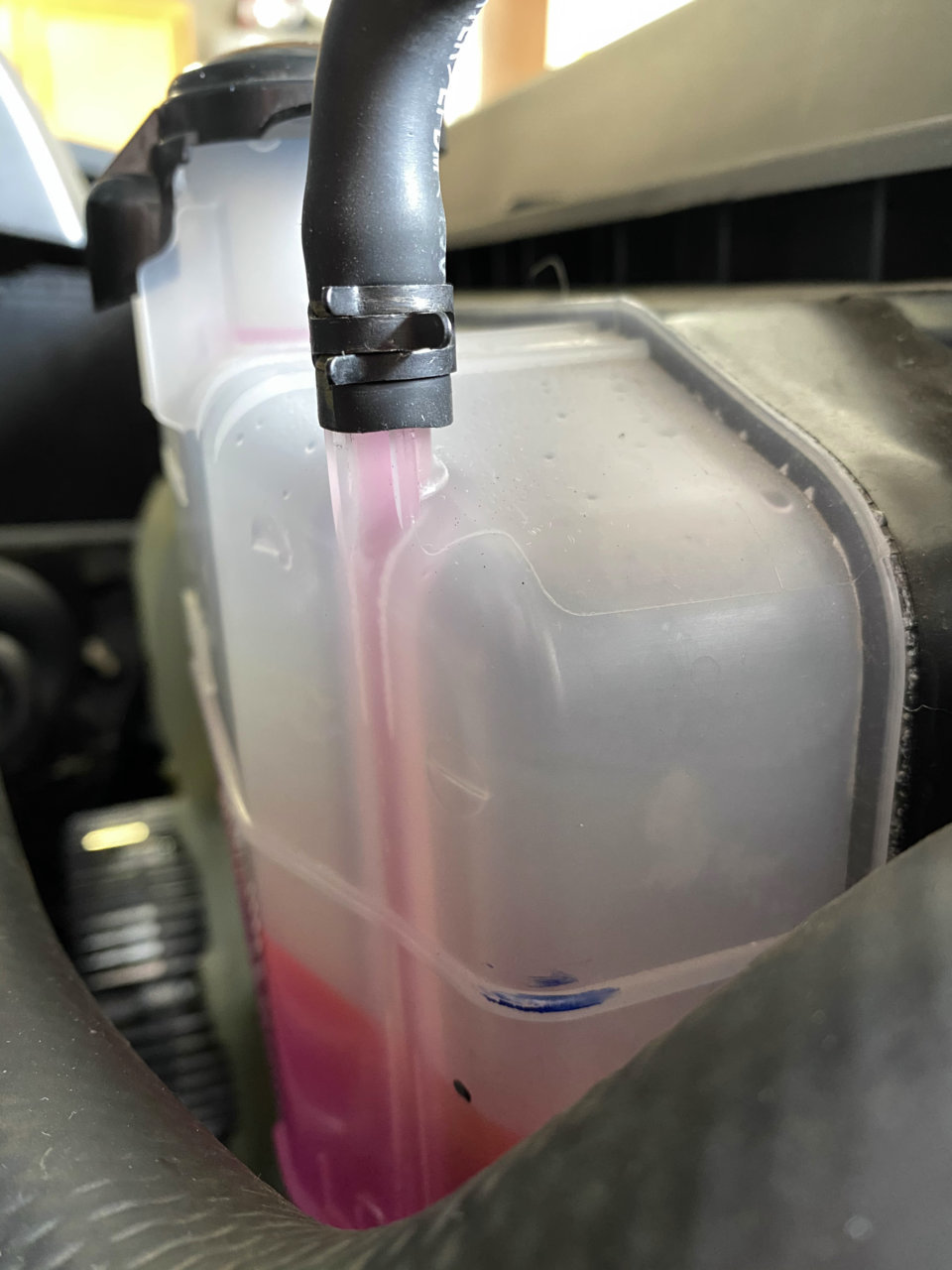

  6. Apr 29, 2023 at 2:36 PM
    #66
    screaminjlew
    screaminjlew Member
    Oct 8, 2019
    #307435
    24
    Jeff
    2019 Cement Tacoma 4x4 TRD Sport

  8. Apr 30, 2023 at 2:31 AM
    #68
    shady 74
    shady 74 Well-Known Member
    May 1, 2020
    #326439
    58
    2019 Limited
    Yeah, I ended up doing the same thing, so far so good
  9. Apr 30, 2023 at 2:48 AM
    #69
    thomasburk
    thomasburk Keep on Truckin'
    Aug 24, 2018
    #263909
    2,392
    Tom
    Tampa, FL
    2020 OR DCLB AT
    V. Helpful pic. Thanks.

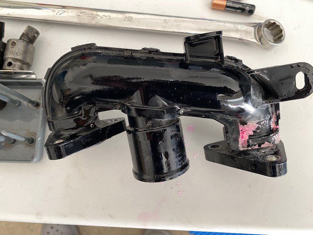

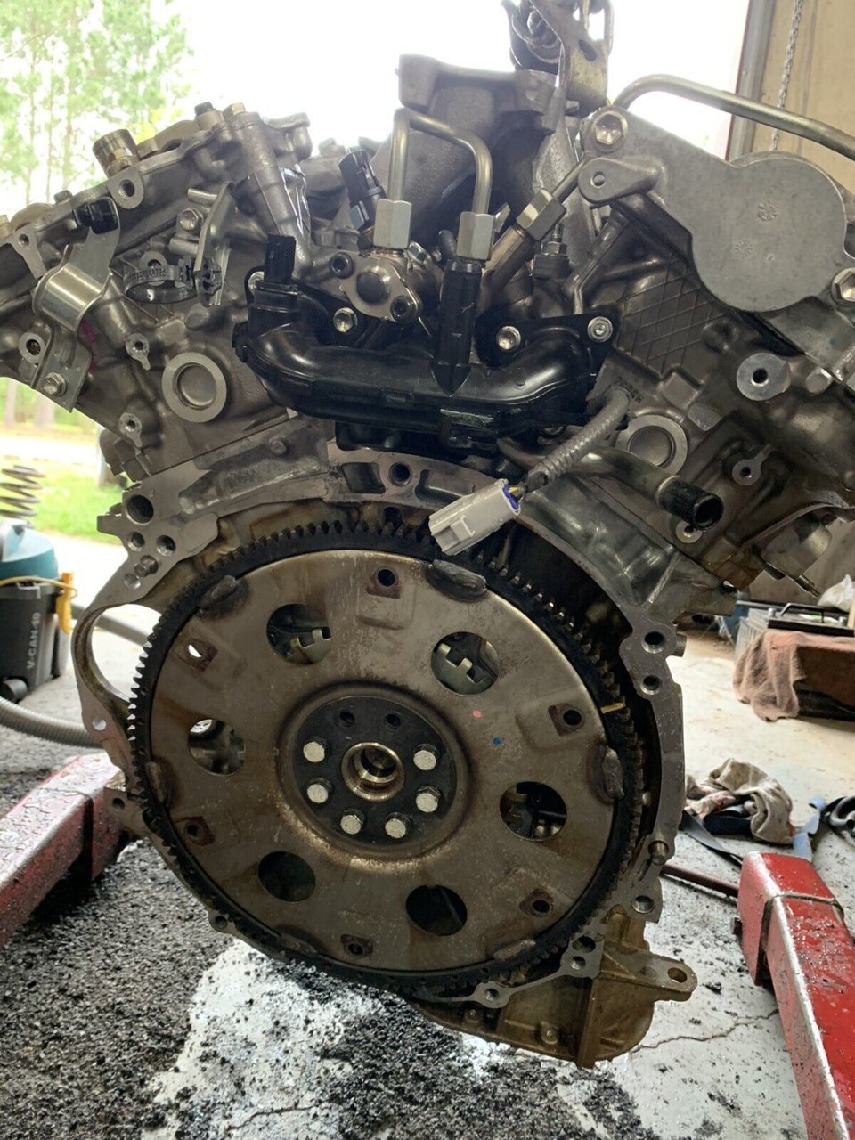

  13. Aug 13, 2023 at 9:16 AM
    #73
    InThePlains
    InThePlains Well-Known Member
    Jul 31, 2019
    #300852
    758
    This job sucks in every way.

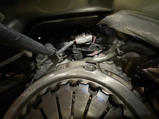

  14. Aug 13, 2023 at 10:51 AM
    #74
    Taco motion
    Taco motion [OP] Active Member
    Mar 30, 2023
    #421458
    31
    2017 Tacoma SR5
    It dosent look like you lowered the engine? How did you get to it?

  16. Aug 13, 2023 at 11:17 AM
    #76
    InThePlains
    Jul 31, 2019
    #300852
    758
    Removed the transmission.
    Also I'm replacing the throwout bearing while I'm there.
